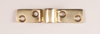

    I'm looking for bronze pintle and gudgeon sets. Don't really want to go with stainless, but don't want to sell a kidney either. Suggestions?

    How big?
    Measurements are given so you can determine the best version for your particular rudder. Typically, two pintles and two gudgeons are needed.
    Several sizes to select from, typically you need two, upper and lower. To help pick the right size for your rudder, see measurements.
    A custom and production nonferrous foundry specializing in marine hardware. Castings are tooled, poured, and finished in-house at our facility in Port Townsend, Washington.

        R&W Rope and Fisheries Supply and others carry Davey, the British chandler. Shipping one-off from Britain sometimes makes letting a US business deal with all that.
        There's also the German company Toplicht.
        Up to about 15 years ago we had a local foundry that let a friend make the patterns and do the surface finishing (what a pain!) after the mold was opened. This saved more than half the cost, which is at least half of why such local foundries as still exist are reluctant.
        The other part of the reasons foundries avoid consumer finished jobs is the low quality of so much amateur work.

                      A 'knuckle joint' router bit might allow you to make a pattern for a local foundary? My eyes popped out when I saw this bit in the catalogue...
                      Bronze are spending though, no avoiding it really. But you might get lucky if you're prepared to do the drilling and finishing.

                        For one-offs I'd just use wax for a pattern, of course after consultation with the foundry. Wood patterns are useful for multiples when doing investment casting in sand molds.
                        It was mentioned earlier that bronze can be cold-worked. Might not it be a practical approach to fabricate something using available bronze stock that then is silver soldered or brazed in assembly?
                        Other than for aesthetics is bronze suitable for salt water use because of its anti-corrosion property, perhaps compromised when other metals get added from using a solder or brazing alloy? For fresh water use this shouldn't be of concern.

                            Patterns can also be 3D printed, which is neat because the slicing software can add the scale for the metal shrinking as it cools.
                            I did a masthead for the kid that way out of aluminum.
                            Ken, do you have an initial design to share as pictures?

                              I'm currently working up a set of hinge/clamp pairs for an aka I want to rework to fold up. Following a concept (with permission) Mike Waters has in his W-17 trimaran design. Should readily adapt for rudder hardware too.
