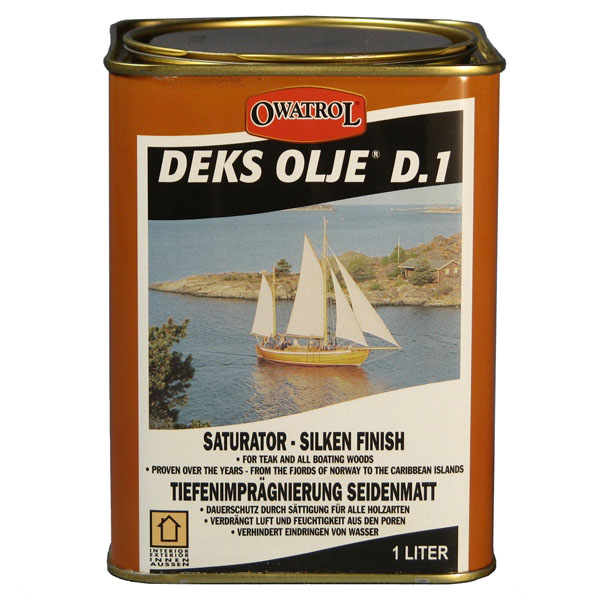

      • #4
        Re: Painting Folkboat interior
        This...
        Is the best stuff for bright finished interiors
        Comment

            The Deks Olje sounds awesome too. It's also recommended for exteriors.
            I was going to use Cetol natural teak on mahogany coatings etc. it is highly recommended except by the finishing experts I've talked to, even the manufacturers rep said "don't." However it's widely praised. The truth us that I don't think I have the time or energy for varnish and I still want to see the wood. Cetol sounded like a good solution.
            Deks Olje sounds like a better one.
            What is the application temperature? I can apply Cetol in the 40s which is perfect for my barely heated winter storage site. What about Deks Olje?
            Also, will it work for a spruce mast?
            I'm sorry for all the noob questions, but I'm almost completely ignorant about any and all finishing. (So why the wooden boat, you ask?).

                • #9
                  I have used DJ on the interior of many boats, some open and some enclosed. The open boats want a coating a couple of times a year. I wouldn't use it for a mast or other exterior bright work. It is an oil finish as compared to a "built-up" finish like varnish or paint. I use it on rubrails, handrails and other parts that require more frequent maintenance. One of the things that endear me to it is there is no prep work required. Just slap it on with a rag... It seems to dissolve into and bond with the previous coats.
                  Comment

                    Except for the deck head and below the waterline...its varnish.
                    I absolutely agree if you want to keep a wood finish, then oil is a good way to go. D1 is an excellent product, though i mostly use tung oil.

                    • #11
                      DJ-1 on the hull, varnish on the deck beams, carlins and sole with Interlux Hatteras White on the
                      cabin sides and overhead. Without the paint it would be a cave for troglodytes...!
                              You need to clean it, that's about it... It will penetrate and doesn't need a "tooth" like varnish"
                              I might go over it with a scotch brite pad and a shop vac.
                              (your boat looks great!)
                              edit; Noting skaraborgcraft's post I wouldn't use DJ over varnish, just bare wood. And it does look like nuts and bolts...
