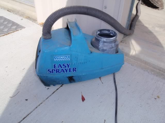

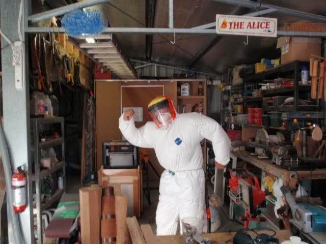

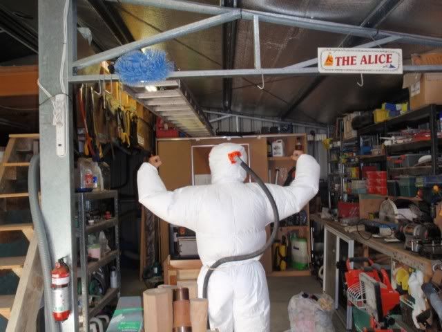

                              Here's mine, a tyvec suit, face shield taped to the hood of the suit, cheap old spray painting blower (basically a vacuum cleaner) with a long hose taped into the back of the hood to blow fresh air into the suit from outside. It worked much better than I could have expected and I did away with the dust mask:
