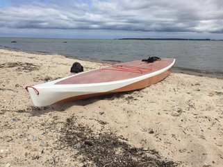

          I built the Gentry Lanui (gentrycustomboats.com) SOF paddleboard spring/summer of 2020 and enjoy paddling it. He has a picture on the website of one skinned with a clear fabric so you could see what the insides look like. Of course I really enjoyed having the plans to work from.
          I lashed everything but the bow and transom. If you really want a vacation from epoxy you could also lash those.

                      [ATTACH=CONFIG]84983[/ATTACH]
                      Very nice.. I am looking at doing a SOF paddleboard. Curious what fabric you used.

                        I used the the 840 X-TRA Tuff Ballistic Nylon from the skin boat school and the two part urethane coating that he sells. I did this because I was interested in learning how to work with the fabric and because I didn't want my kids to have to worry about dragging it around on the beach. The designer recommends polyester fabric and now that I have used the nylon skin I better understand why the polyester would be more straightforward to work with.
                        It was early summer when I skinned the board so I did my sewing in the wee hours of the morning when the temperature was down and the fog was thick (SF Bay Area) so that I could take advantage of the relaxed fabric. I did get some pretty funny comments from my partner as to why I was up so early. One mistake I made at first was to pause my sewing part way through (had to go to work) and not keep it out of the sun. The fabric tightened up enough with the combination of warmth and sunshine that it opened a good 12" length of the seam right up.
                        Happy building!
