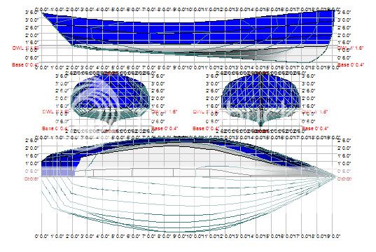

                    I rough out a design on graph paper, then use Excel to generate the chine coordinates for uploading into Freeship.
                    I have used it to play with Northumbrian Cobles like this one.
                    The data entered does not have to be too precise, as it is easy to manipulate the chines in Freeship. So the original graph paper drawing can be rough and dirty.
