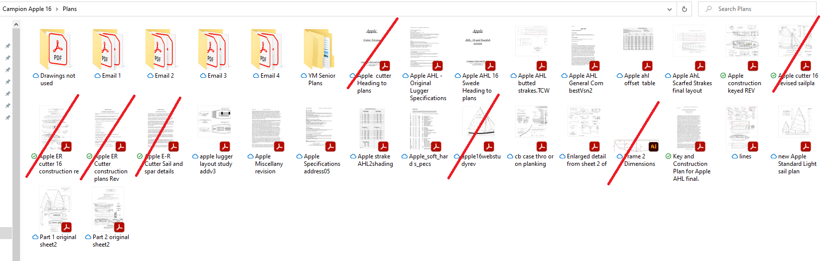

    I'd built radio controlled model aeroplanes from plans before, have been a scale modeller for a long time, do lots of mechanical work on cars and more recently did door frames, door hanging and skirting boards etc on my house rebuild after a fire to save some money after the heavy stuff was done. That's it. I've never built a boat before.
    My Apple 16 build has been quite straight forward I think. I've had to ask the designer for help on a few points, partly because I don't know what I'm doing and partly because my decision to go for the gaff cutter rig has greatly complicated matters. It was designed as the balanced lugger version and the plans and instructions are really very straight forward for that. The gaff cutter has some new drawings, uses some of the original drawings and there's a supplementary narrative but it's still necessary to refer to the original. I've managed it though. If you went for the original balanced lugger rig it would be very simple.
    Here's the folder on my computer showing the plans files. There is actually one more showing hinged centreboard details which I have in the "Drawings Not Used" folder as my rig needs the daggerboard to be moveable fore and aft for when the jib is used or not. I've crossed out everything you could forget about if you went for the original rig and internal fit out like Bill's above.
    Several of the files are presenting the lofting data for the strakes in different ways to aid understanding. The "Apple AHL offset table" file has the actual x,y coordinates in millimetres to read off for each station on each plank. The "Apple AhL Scarfed Strakes final layout" is simply an illustration showing you how to use the offset table and showing what the planks are supposed to look like lofted out onto the 16ft x 4ft ply boards you made by joining 2 8 x 4s.

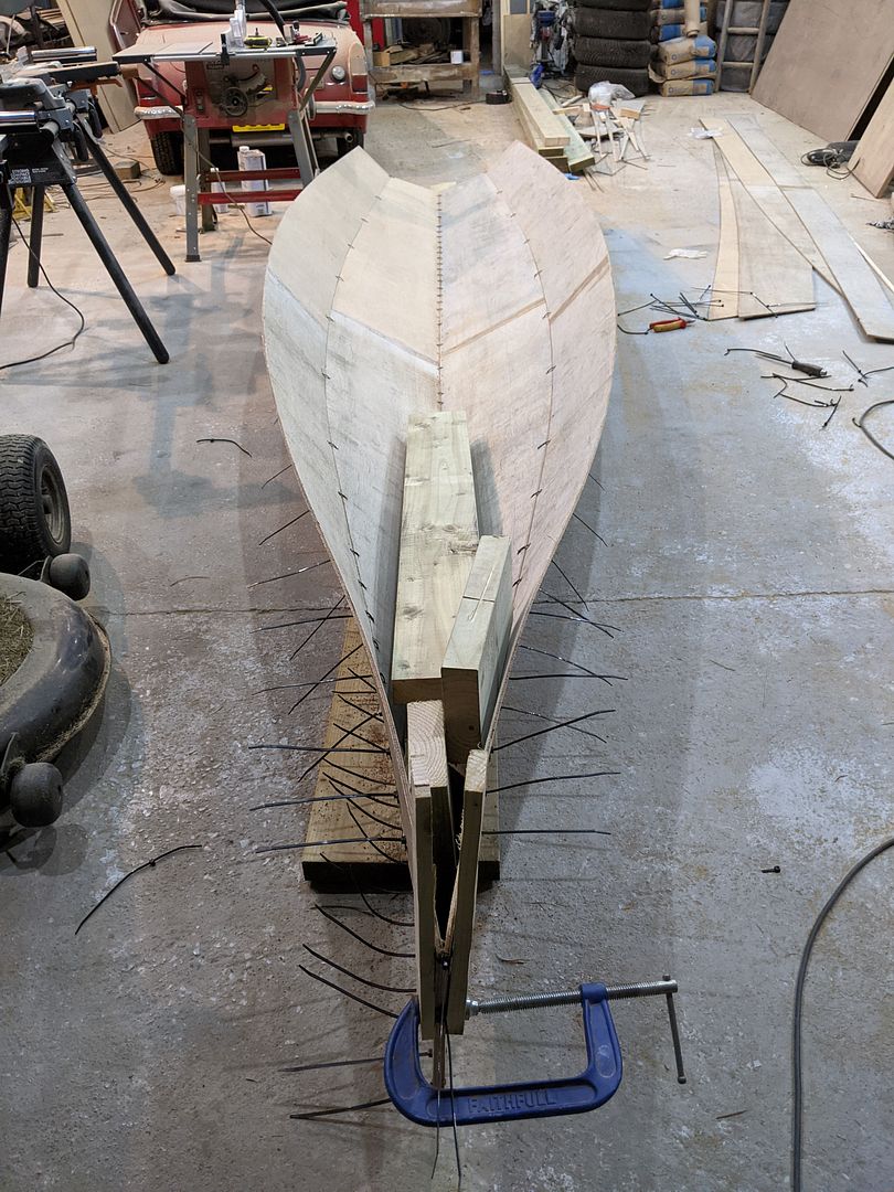

    I just assembled it with tiewraps. I am happy to admit that assembling it on the floor I was initially quite alarmed/dismayed that I may have made a serious error in lofting as the planks up at the bow just wouldn't close up. It's showing my inexperience here because when I realised I had to get it off the floor onto a pair of horses and did so, the middle of the hull sagged into shape properly, the gaps at the bow all disappeared and the tiewraps there went slack all of their own accord...
    The only thing I've really been concerned about as a first timer using this construction method is remembering to check and double check the hull wasn't twisted before taping the seams and gluing in bulkheads. The hull remained fairly floppy overall until the gunwales were glued on then it suddenly felt like a boat when having to handle it. The shape otherwise pretty much takes care of itself.
