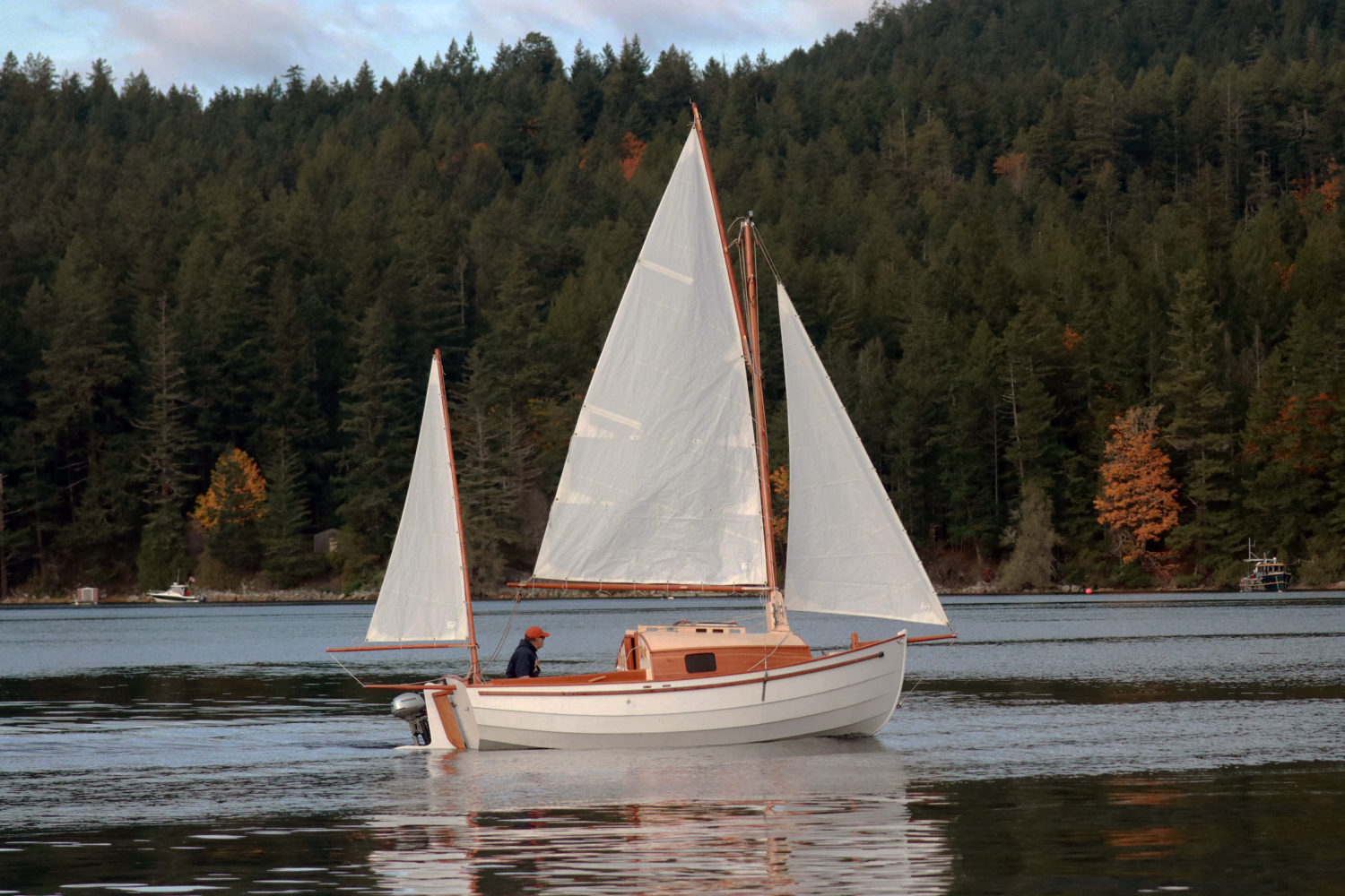

    I've been scouring the net looking at myriad plans trying to find one that suits and I've finally decided on the Selway Fisher Ptarmigan 17
    It is drawn as a 2 chine cat rigged boat but has options of 4 strake glued lapstrake and yawl rig.
    There is little written about this boat but I found this article in Small Boats Monthly that helped make my decision
    There are drawings for both stitch-and-tape and glued-plywood lapstrake construction. You can also choose between a simple catboat rig and a yawl rig. With all the options for customization, I wouldn’t be surprised to see 10 different boats built from the same set of Ptarmigan 17 plans.
    The 4 strake version looks much prettier and the yawl is known for it's benefits in small boats so that's what I'm building.
    The build will take place at the Lake Macquarie Classic Boat Assoc. in workshop 1 and I will have plenty of assistance from fellow members, including retired shipwrights, who are looking forward to this project.
    The materials used will be Gaboon marine ply (9mm), Hoop pine for framing etc, Oregon for masts and spars and I have acquired two nice big slabs of Huon Pine and while not enough to build much of the boat from it will definitely provide some beautiful features here and there.

      6' 11'' beam will certainly give you plenty of room Steve. I agree, the clinker version looks pretty.
      Look forward to seeing this one come together :-)

                        Great looking boat. It ought to be very comfortable and easy to manage various conditions with the yawl rig. At 17' she's just a foot longer than my day sailer but, so much more boat!
