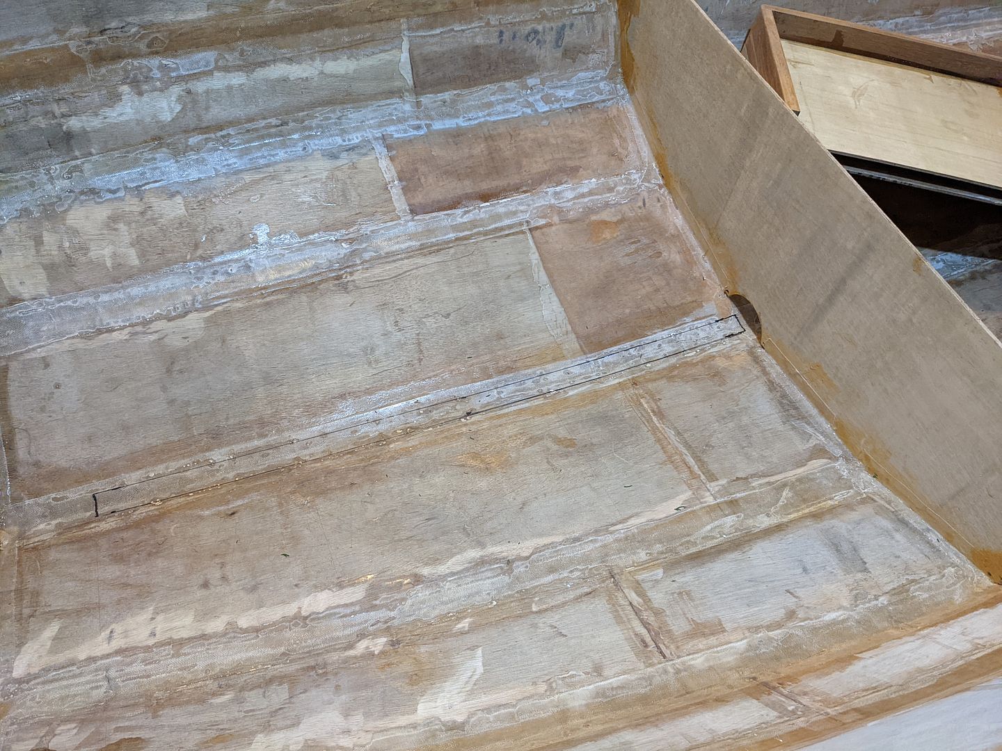

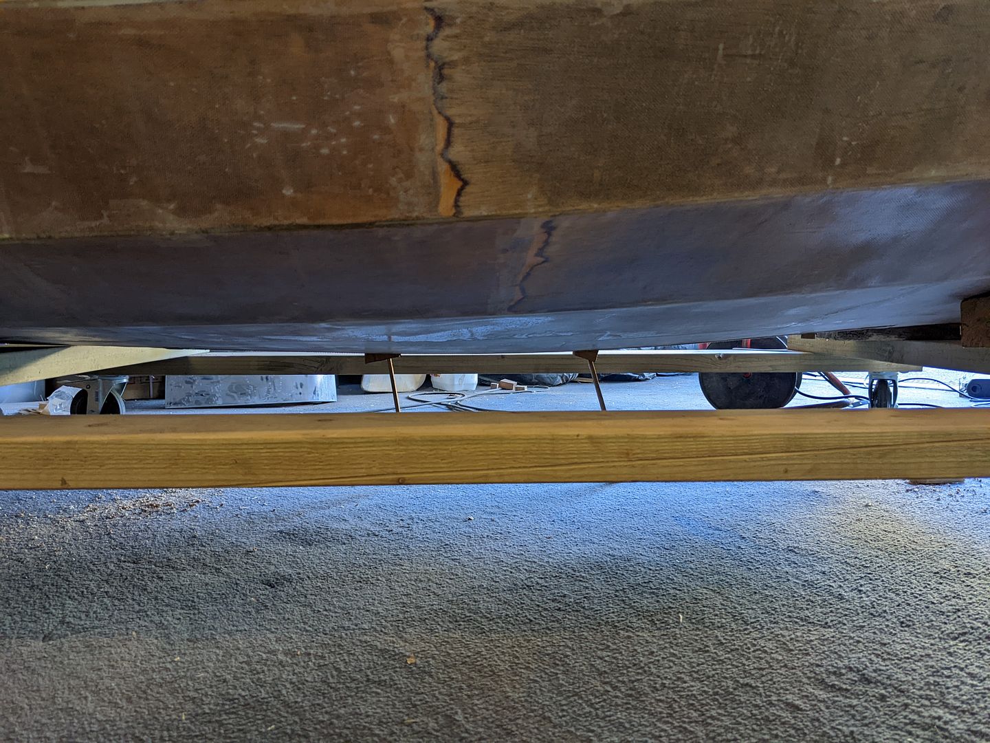

                        I managed to capsize the boat alone yesterday, but I'll admit it was pretty awkward. The outside of the hull was then power sanded to remove any splinters or drips of epoxy through the tie-wrap holes. The stem post was shaped also.
                        That done, my wife laid out, marked and cut the fibreglass cloth ahead of time. We made up a filler paste from epoxy and milled fibres (heavier but a lot stronger than using microballoons) and filled all the seams and tiewrap holes.
                        Rather than let this cure and sand it back, we went straight ahead and glassed over it. The squeegee action to wet out the cloth takes care of any rough bits of filler while it's all still wet.
                        This was wet out in the usual way (at least it's usual for home built aircraft builders) - pour a little resin on then squeegee the bejesus out of it to see how far the resin will go whilst still wetting it out fully.
                        It still used loads of resin. It's a good thing I bought another 6kg pack of the stuff!

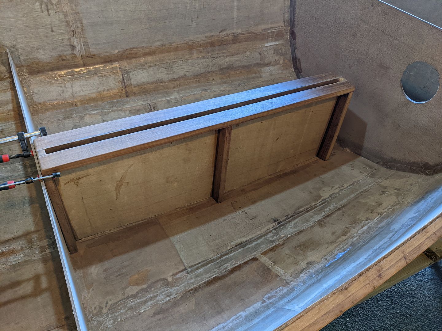

                                A while ago I built the daggerboard case and cut the hull to fit it in. It's not glued in yet.

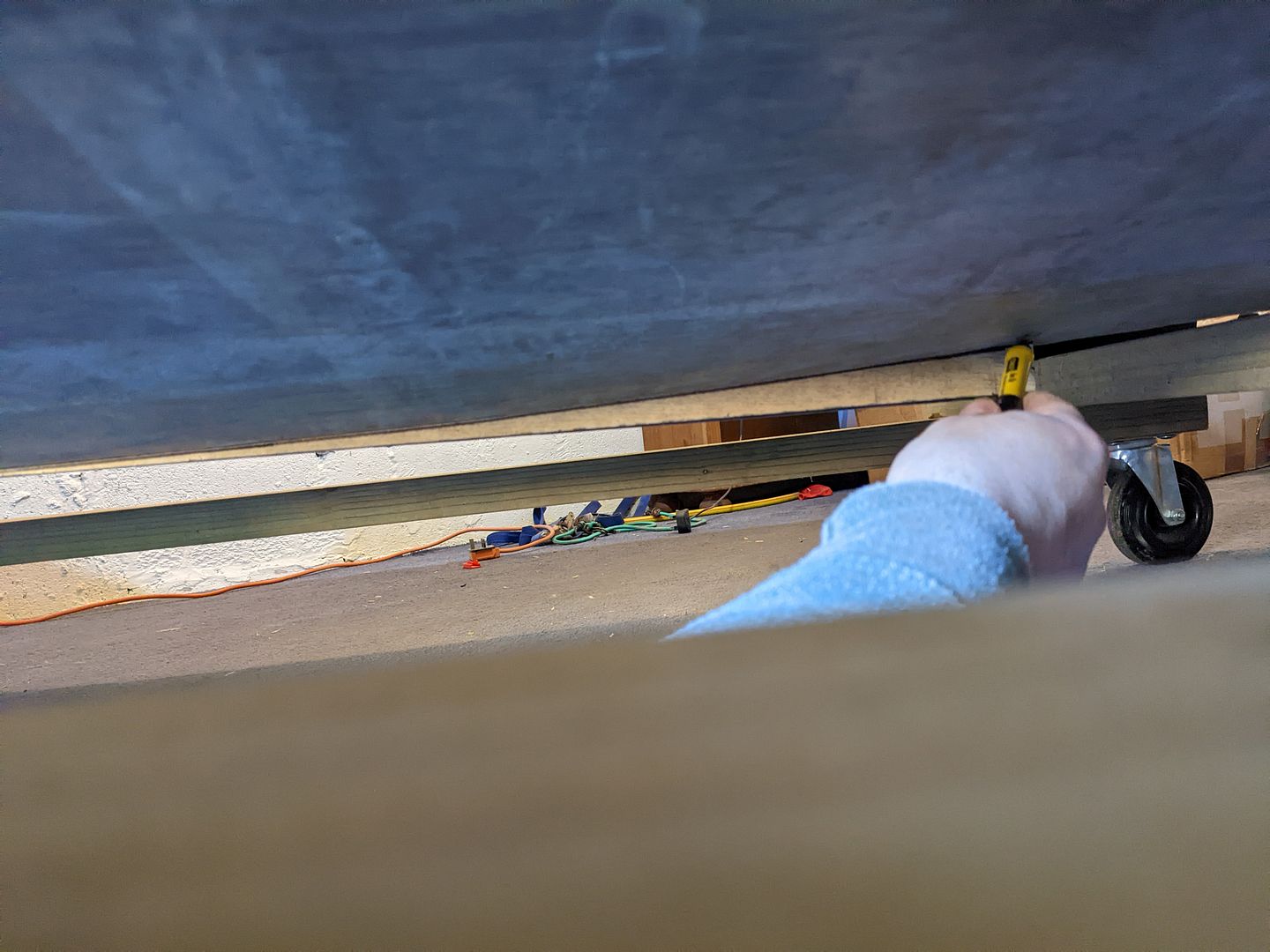

                                In the mean time though, I've started adding the lower rubbing strips. These are temporarily screwed in place whilst the epoxy cures.
                                The screws are out now, actually, and I'm ready to glue the next lamination on, which will be screwed from the inside this time.
