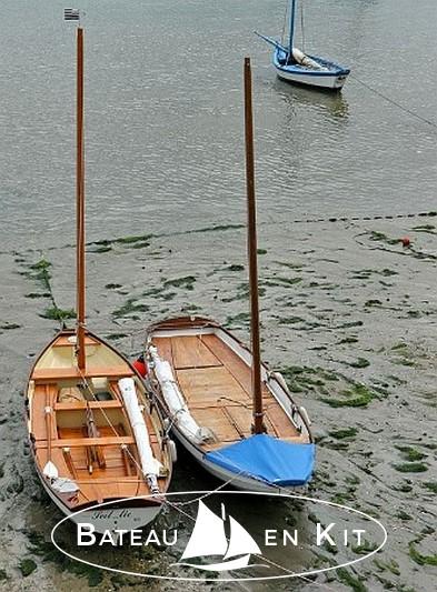

    Well thought out enough to allow comfortable sleeping aboard;
    Image from Bateau en kit; notice the floorboards raised to thwart level for sleeping platform.

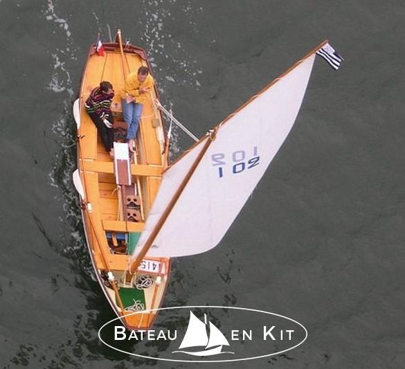

    And designed for self-recovery after a capsize. This video is the only capsize test I can find, and obviously it's not under real conditions, but I'm cheered by the relatively high freeboard of the swamped boat. I think I could bail that out and keep sailing.
    I wanted plenty of room for me, the manager, and the supervisor, both of whom will only grow.
    Image: F. Vivier
