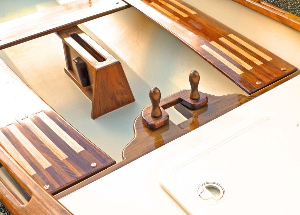

              [QUOTE=I am not sure yet how to support it at the cockpit end. But having said that I am sure I will get a lot of suggestions now.[/QUOTE]
              Try something like this.
              Comment

                        • #27
                          Re: Argie 15 with standing lug
                          my boat will NOT look this pretty
