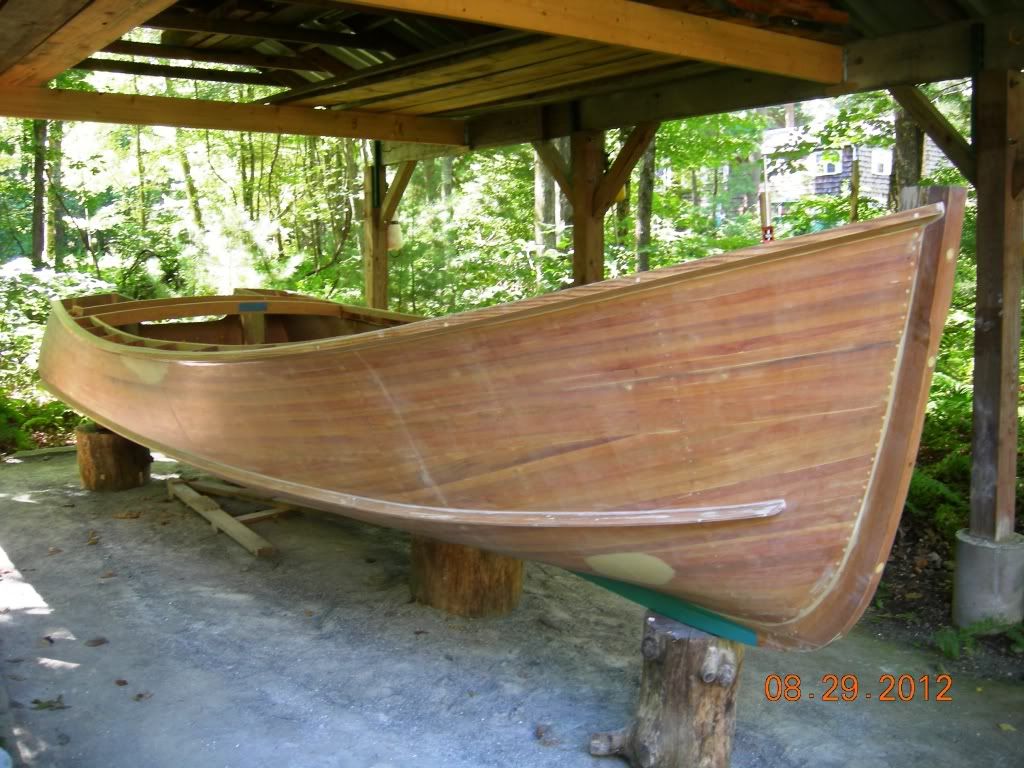

                  White oak, just in case you do bump into the occasional dock, etc... might have to kerf it depending on the depth of the rails and the curve of the hull:

                  • #10
                    Re: Best wood for spray rails?
                    Stunning boat Stinkpotter!
                    Please let us see it when you are done...
                    What is it?

                    • #11
                      What is it?
                      Thanks! Yeah, I love the lines of this boat too; it's the Ocean Pointer. Hope to have her done this spring and pictures will follow for sure.
