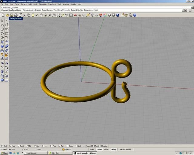

    I need to fashion a mast traveller for the main halyard on my Caledonia Yawl's balanced lug rig. Classic Marine sells them (http://www.classicmarine.co.uk/boats...ID=84&P_ID=322), but I can't abide their price or the wait. Can someone who has one please tell me what size/gauge bronze rod they are made from?

              Actually I did try this rig and found I don't have enough mast height above the yard for it. I couldn't raise the boom high enough, otherwise I liked it a lot. So I have to go with a traveller of some sort. I have a couple design ideas to try before I fall back on the traditional version ala Classic Marine. One involves making a delrin hoop for brass jib hank, but I am not sure the jib hank will be strong enough. Labelled breaking strength is 630 lbs; sail area is 146 sq.ft. Just thinking about a catastrophic failure of the halyard gives me the willies. I thought I would also try fitting a delrin hoop to a 9mm SS s-hook, which should be plenty strong, though not as elegant.

                          Thanks, guys. I already have a masthead sheave. There just wasn't enough headroom for a Storer-style rig. I think I should (barely) have enough room for one of the travellers I fashioned yesterday, but I have to wait for a little less wind before hoisting it on the trailered boat. Dryland knockdowns - another scary topic.

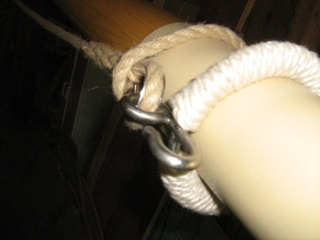

                              Re: Lug rig mast travellebr />
                              Here is my current working solution. A delrin hoop on a SS S-hook. The hoop perimeter is 3/8" X 3/8" with a tab for the angled hole that the S-hook fits through. When this traveller is raised to the sheave, the boom seems to have a fair amount of clearance for downhaul tensioning (etc). Only time will tell if it is enough.
                              Max, adding length to the top of mast would be difficult due to its hollow birds-mouth construction. I would just build a new one if it comes to that. But I doubt it will.
