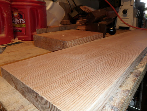

    This installment covers the mast step and and mast partner. I thicknessed 2 x stock using saw kerfs, chisel, and finally a plane to bring the stock to a fat 7/8 dimension. That chunk in the background is what's left of a 2 x 12 x 14' VG Doug Fir board that I paid over 200 bucks for. Got my spars, rails and other bits out it.
