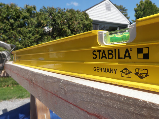

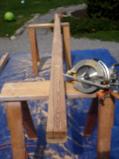

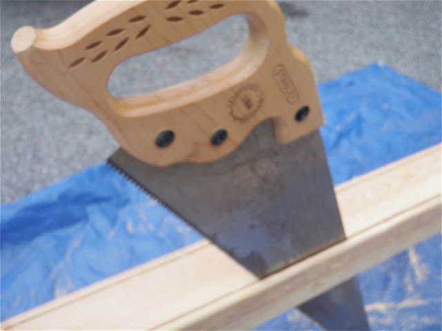

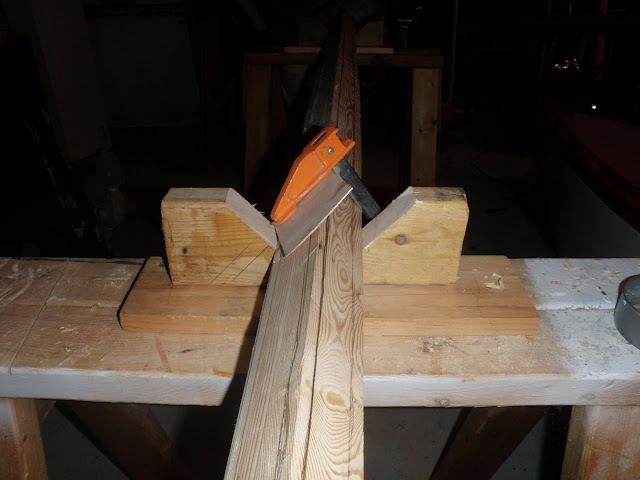

    Ripped the stock for boom and yard (square pieces) and for inwales. I use a skilsaw and a scrap aluminum fence tacked in place to guide the cuts.

    Building the sailing bits: After laminating two d-fir boards together with epoxy, I marked tapers using battens secured by finish nails.
    Then I took it outside, cut the tapers using a skilsaw--not by eye,LOL-- but with battens as a guide. I had to finish the cut in one dimesion with a handsaw. Then I belt-sanded all four sides flat and clean for marking.
    Mre
    More....

    I then made and used an eight-siding gauge using directions learned here on the WBF. One problem I had was keeping the pencils from falling out; another was the breaking pencil points. You can see the wiggly results of these problems here. My solution was to mark one side at a time--I used the gauge with only one pencil in it and went up and down each corner twice. Seemed to work out fine. This pic also shows my clamping deal.
    After planing off the corners I had an eight-sided stick. I planed those eight corners down by eye. Then I built another tool, the Rossell-Culler Sand-O-Matic Spar Rounder. Here, I am using my Makita 9227 C sander upside down as a shaper to egg shape the "barrel". The barrel is made from three holsesaw plugs glued together.
    5/16 rod serves as the shaft and a sccrap piece of aluminum tube serves as the idler handle. ( In the background are the plywood laminations that will serve as leeboard and rudder stock)
    I tacked some vinyl floor mat on to better grip the inside out sanding belt.
    More to come...
