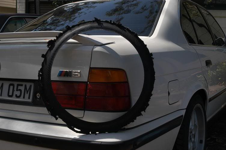

    I've had at 3 x 90+ mph blow-outs over the years. They can get interesting. Fortunately each time they have been on the rear wheels. I think I might not be typing this if any had occurred on a front wheel.
    Here's what's left of one of my tyres after a blowout.
    You sure you want your wife driving on that?

    odd looking,,Bigfella,,you are a special case.
