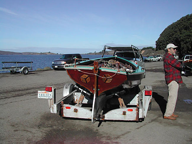

    I got the Cosine Wherry below on Craigslist for free with two sets of spoon oars - just paid the cost of the nearly-new galvanized EZLoader trailer $825 -

    Default Re: Home built trailers
    Thorne,
    Do you have shackles on those trailer springs?
    Can't tell from the photo.
    Dan
    Apr 2005
    Hills of Vermont, USA
    9,032
    Quote Originally Posted by D Happ View Post
    Thorne,
    Dan
    I'm pretty sure it's a "slipper" spring - no attachment other than gravity on the back end - fairly common on little trailers.
    HTH
    Garret

    The sticking point is a NEW home-built trailer, as like new home-built boats, you may have to provide the cost of materials, proof that you paid sales tax on same, etc.
    This sounds like bureaucracy gone mad. Are they worried you might have an illegal steel mill in your back yard and they are missing out on 50 cents worth of taxes?
    Here's us a couple of months back, re-building my trailer... we re-used the axle - but put a 4" drop on it with new stub axles - and went from small trailer wheels to the most popular local GM bearings and wheels, we also re-used the old coupling and winch setup. This trailer now services a 12' fibreglass catamaran and a 14' putt putt (which got its first ride on the trailer on Saturday)
    The trailer is built out of 3mm wall thickness steel, now galvanised. It is built with adaptability in mind - I can use it for a track car too if I want (by adding another axle with brakes) - and it has half a dozen spots for different bed supports..
