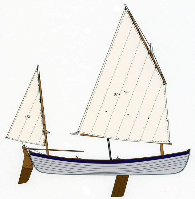

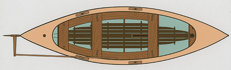

    I've begun construction of a double ender in my Brooklyn shop, to lines from Walter Simmons. She has a flat keel, and will be planked from 9mm occume. 16 feet long. I've put up some photos on my blog, and will add to it as I go along. http://sailingskiffs.blogspot.com/
    I've shown the trad. sprit rig, but will more likely go with a balance lug, and maybe even a yawl, but more on that down the road.

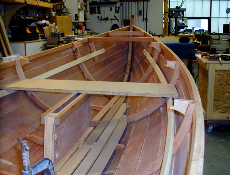

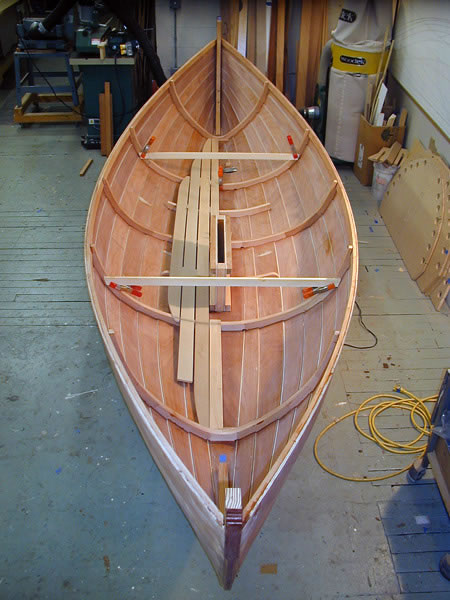

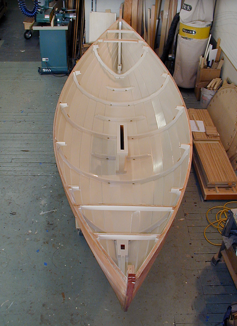

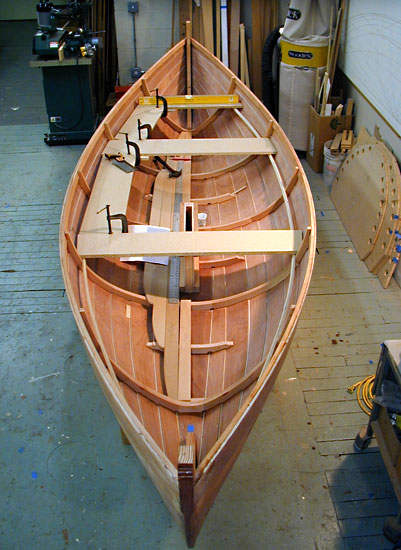

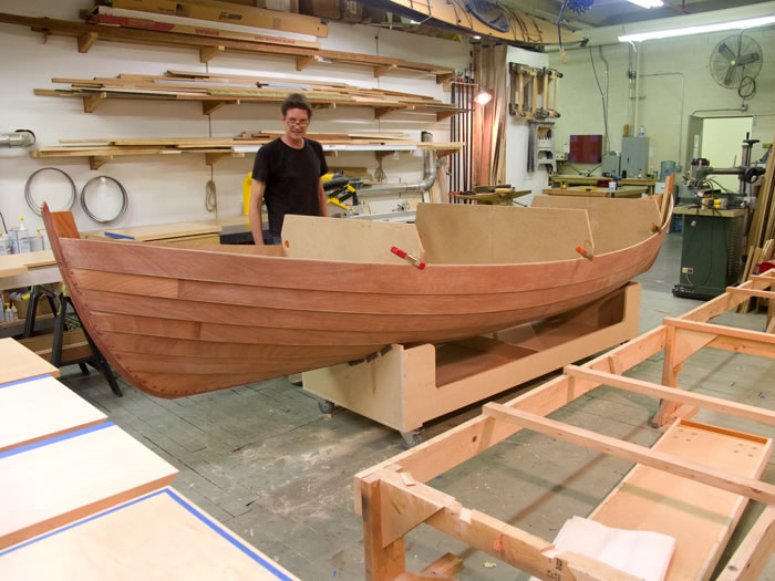

    Hi folks,
    After several months away from the Matinicus double ender project (due to sailing obligations!), I've made some recent progress. I have finalized the sail plan, framed her up, and I'm laying out the furniture now. She will be half decked, with short end decks, side decks, and an oval coaming. I thought I would share a couple of pics here. I've kept a fairly detailed record on my blog http://sailingskiffs.blogspot.com/
    Just after flipping the hull.
    Frames are in, and patterns are made for the floor boards.
    One of the frame halves marked out for cutting.
    As I said, I'm fooling around with the interior layout. she's starting to look like something that might be useful.
    Jim Luton

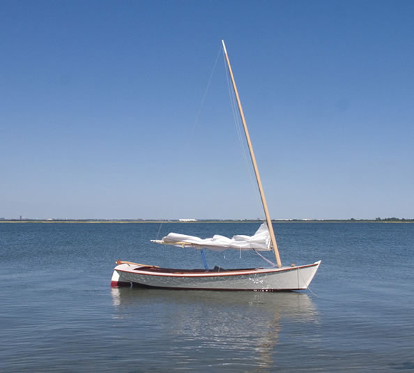

    What design is Cricket ?

    Cricket is slightly modified Windward 15, lengthened to 16'2" with an 85 foot sail. Its a wonderful boat, well balanced, fast, and weatherly.

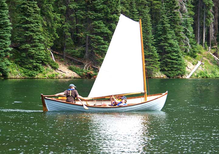

    Hey! I have one!
    This is Matty (creative right?) and she is 20 yrs old. Glued lap with the plank keel.
    Having sailed her with a sprit rig, I can certainly tell you that the lug yawl is the way to go. In fact I will be very interested to see pics of the rig, as I intend to build Matty a lug yawl rig next winter. Im also curious to see how the decking works out, b/c Matty is totally open.

    Thanks guys. Matty is a great looking boat! Gotta love that sheer. I'm looking forward to the yawl rig. Yeadon, I know I've seen some recent pics of your new rig. Where are they located? And how have you liked the yawl?
    I'll try to keep updated with new pics myself. Good luck with your wherry Duane. I'd like to do a christmas wherry or a trap skiff one day myself. I understand they are tricky to plank back aft. I have Walt's wherry book.

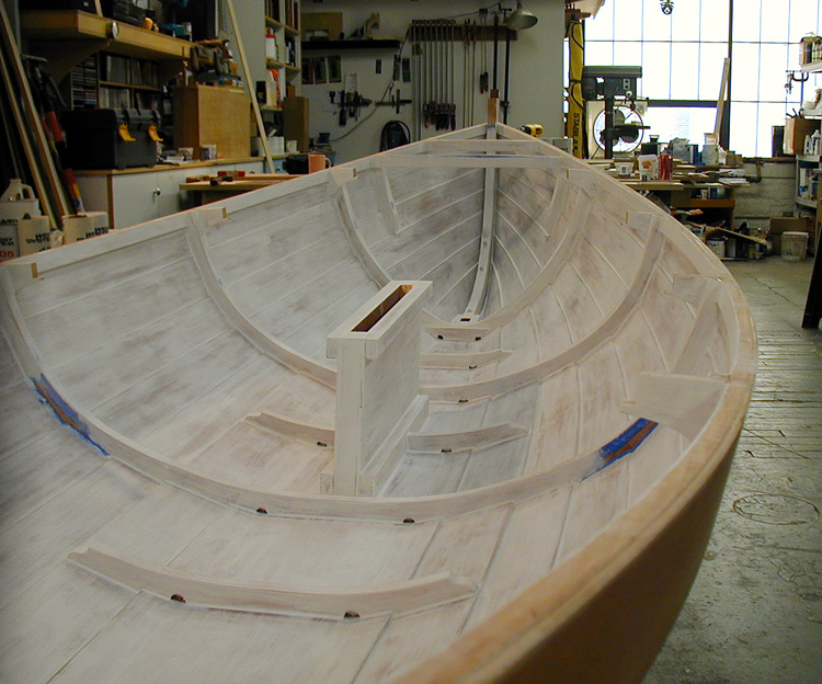

    Hi folks,
    Still making some some progress on the Matinicus. I finalized the arrangement and deck plan. I decided after some thought to step the mast through a partner with a gate so I could have at least a fighting chance of raising and lowering the mast afloat. Here's the plan view...
    I've gotten the seat risers laid out, and put in some flakeboard seats to see how I like the side benches. The dagger board really opens up the cockpit amidship...
    I fitted a knee amidship to support the side bench span...
    And I've laid out the deck...
    And put in the deck beams...

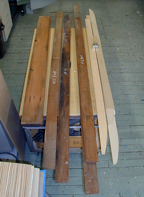

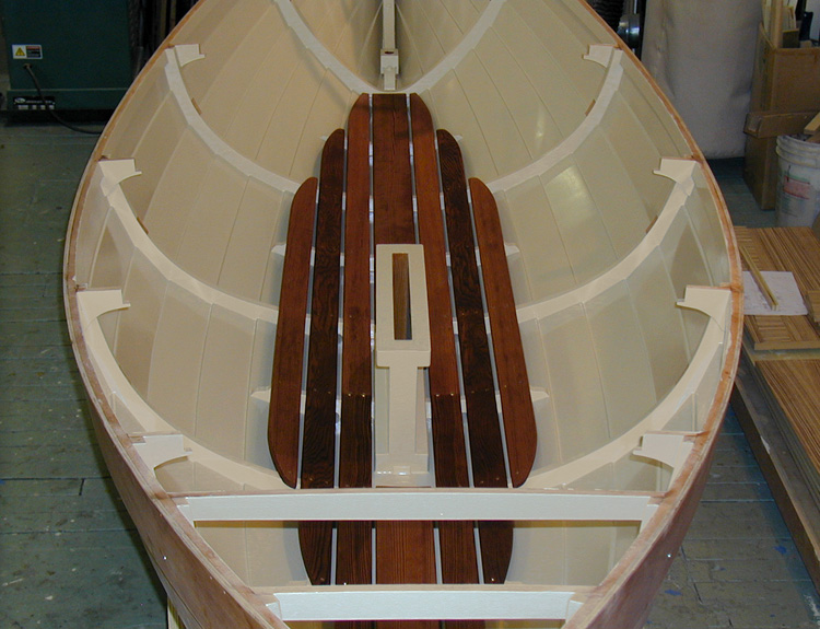

    A little more progress has been made on the MDE. I've got paint on the interior...
    ...and installed the floor boards. These were cut from an old redwood picnic table I found dumpster diving. The redwood is oiled.
    Now its on to the rest of the furniture. As always, there is further info on my blog. http://sailingskiffs.blogspot.com/
    Jim

    Very freakin' nice. And I love the score you made on that redwood for your floors. They look great. Pays to keep a sharp eye out for cast off materials.
    It looks like, so far, that you have a primer coat only on that interior. What product did you use for the primer coat?
    Jan 2008
    314
    Default Re: New Matinicus Peapod under construction
    Thanks sharpie,
    The first pic is primer. Petit Easypoxy. The other photos show three topcoats of Petit Easypoxy sandtone. The paint is Petit's single part polyurethane, similar to Interlux Brightsides.

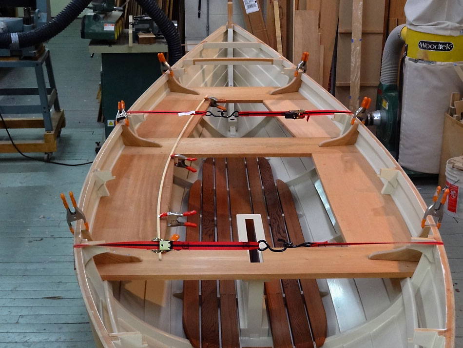

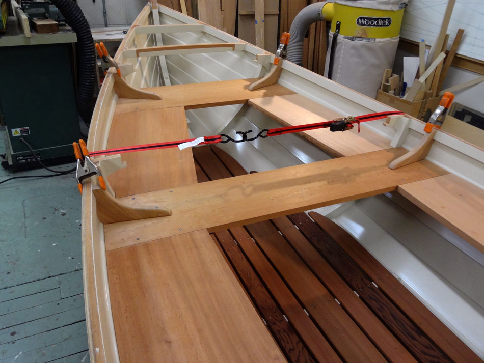

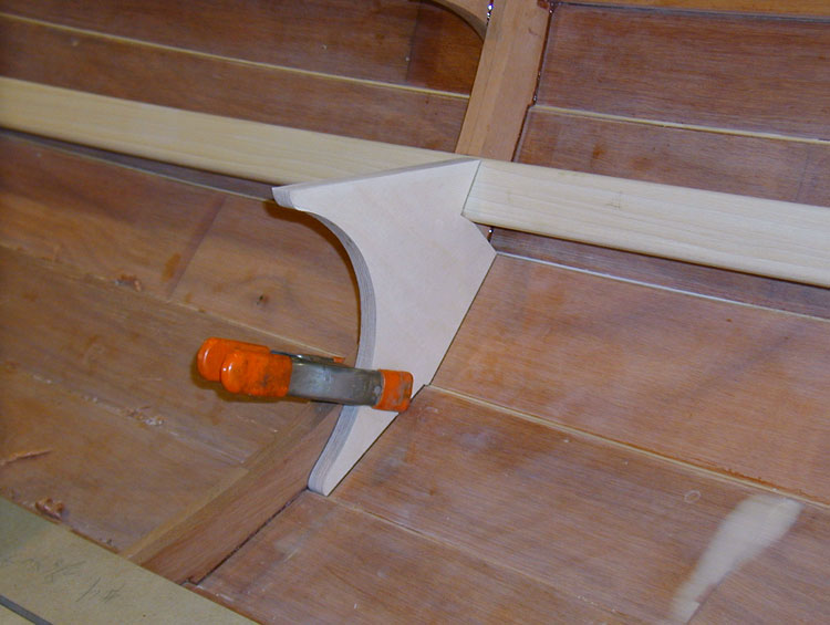

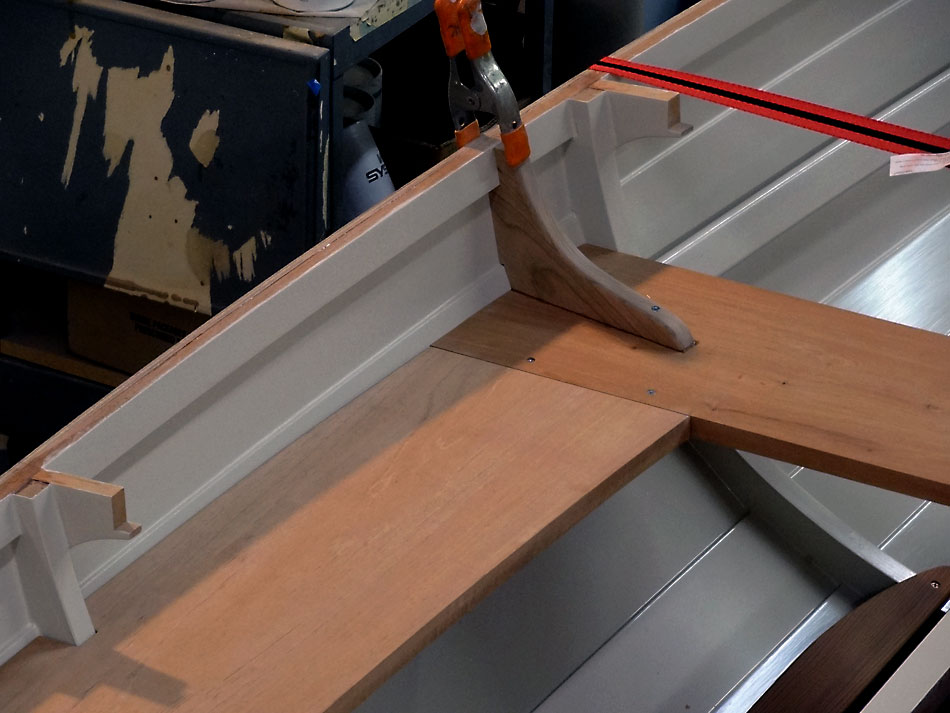

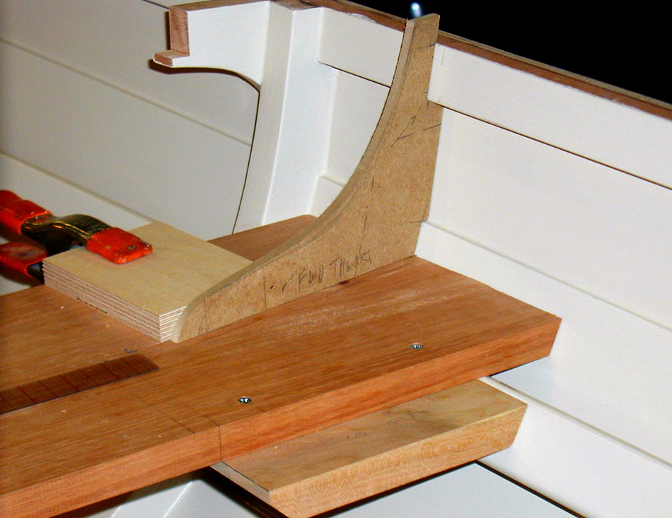

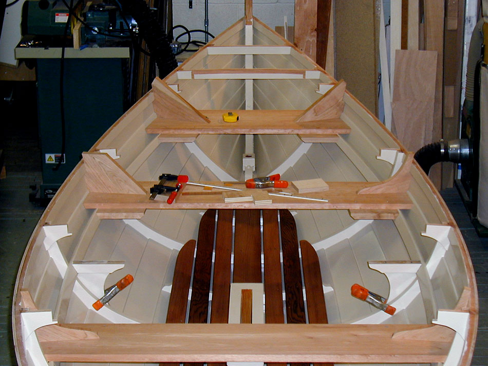

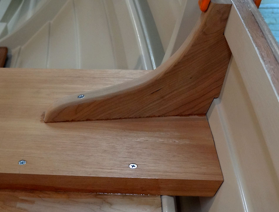

    Hi folks,
    After six months away from the boat, I'm back at work on the Matinicus. This is proving to be a long winded project, even by my standards, but that's how it is. Busy working and busy sailing!
    Fitting thwarts and knees.
    Knee pattern.
    Finished knee, not fastened to the boat yet. The steel screws will be replaced with bronze and bunged before installing the thwarts for good. I have them clamped
    in while I'm fitting the side benches, then everything comes back out for finishing before getting installed permanently.
    After sitting for a while unrestrained, I noticed the boat settling out slightly. I put these band clamps on to bring it back in until I
    fasten the thwarts and knees in permanently.
    I'm fitting the side benches now. The full story is on the blog. And to go back to the very beginning, go here. More later...
    Jim

    I have them clamped
    I hear ya.But it looks like glue squeeze out under the knee and thwart. Do you mean to just remove the screws?
    Great build, thanks for sharing it.
    Kevin
    Jan 2008
    314
    Hi Breakaway,
    I permanently mounted the knees to the thwarts, and they go in (and out) of the boat as a package. I couldn't easily get a fastener in from underneath the thwart with it in the boat. Its a little tight going in and coming out, but it works. The steel screws get changed out before installing. I'll just bed the knees in sikaflex where they bear against the planking, and screw them in from the outside, except at the inwale where the screw goes in through the knee.
    Jim

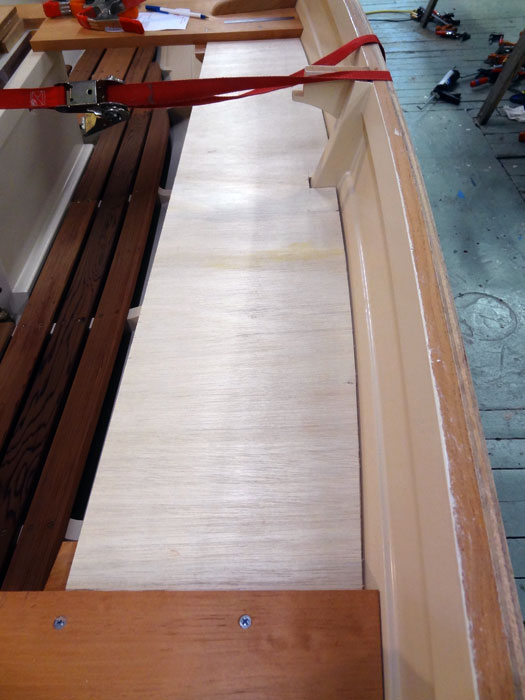

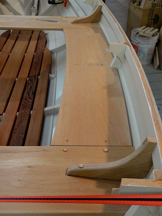

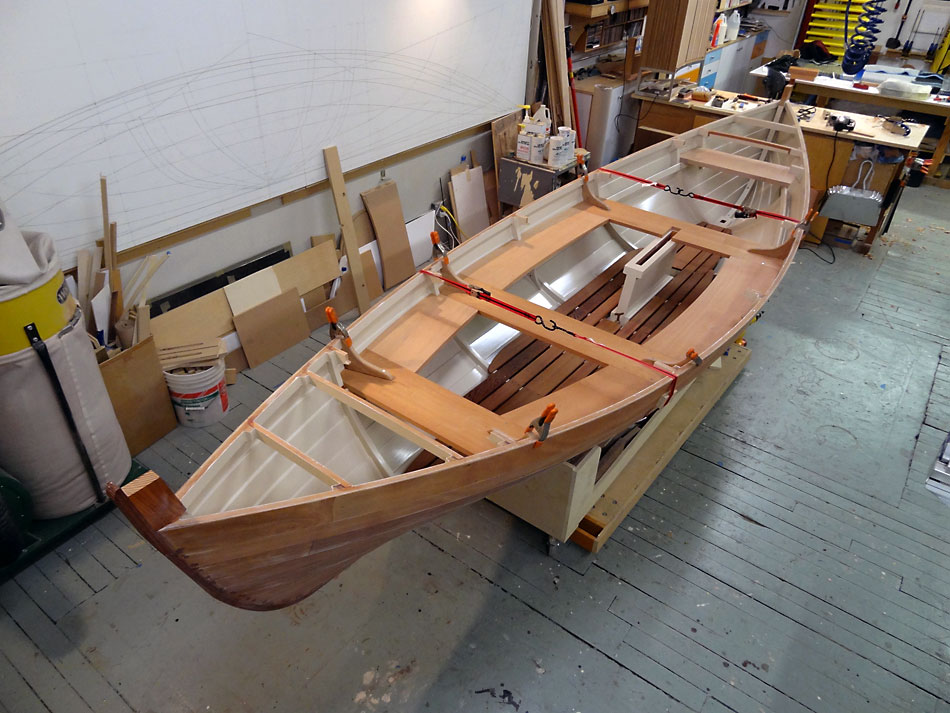

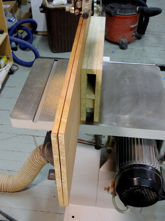

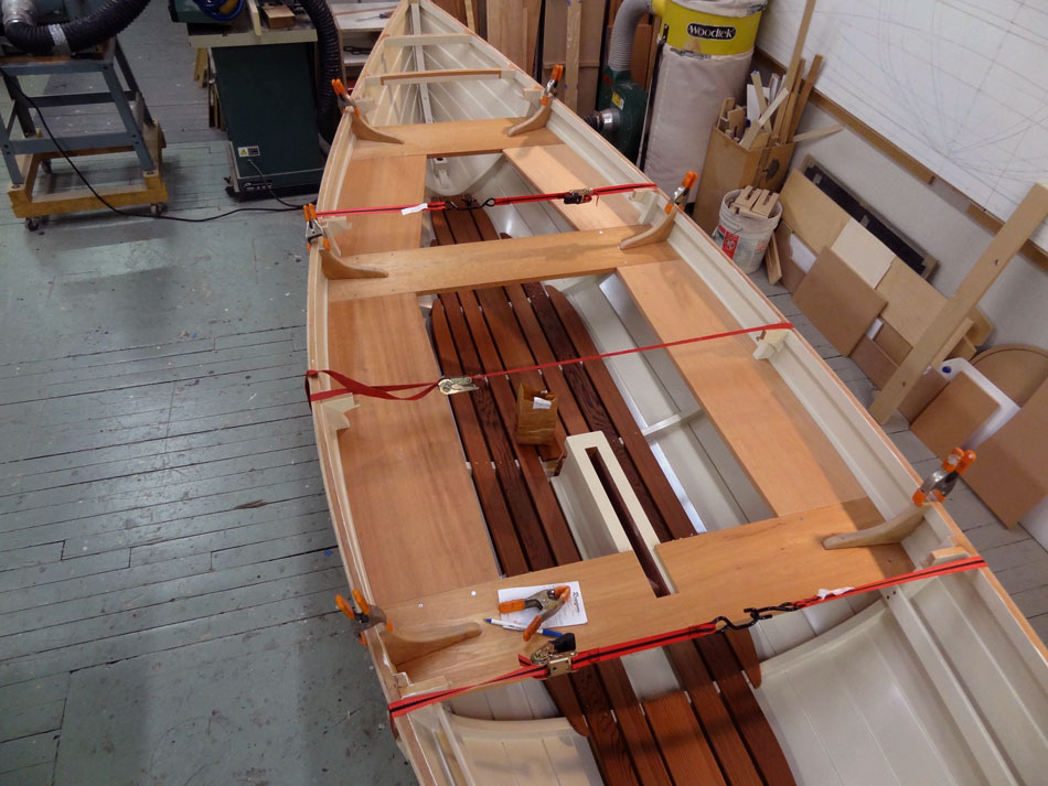

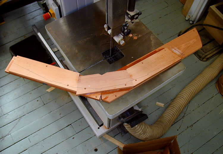

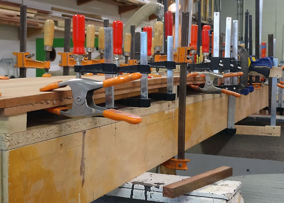

    Some progress on the furniture. I've got the side benches fitted now.
    I first made thin ply patterns, then transferred the info to my seat stock (there's
    no bevel on the pattern, hence the gap at the hull).
    The benches fit well to the hull, and between the thwarts. The inboard edges are still wild at this point.

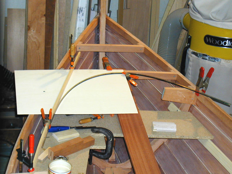

    But let me backtrack a minute. When I put in the seat risers, I sprung in the piece, already cut to width. I had a bit of a struggle keeping the correct heights
    for the rowing positions, and wasn't able to straighten the run of the riser (in profile). It has a curve similar to the sheer, instead of being flat (parallel to the waterplane). So there is a bit of a curve between the thwarts. I thought the benches would be tough to spring to shape, so I decided to resaw the material, and glue it back together with a bit of curvature.
    This is the kind of thing I bought this bandsaw for. 16" resaw capacity, and a 5 hp motor
    walk right through the spanish cedar.
    No form here, just a few blocks under the layup. The glue is Unibond.
    More to come...

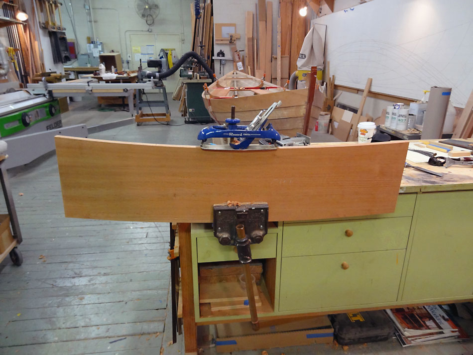

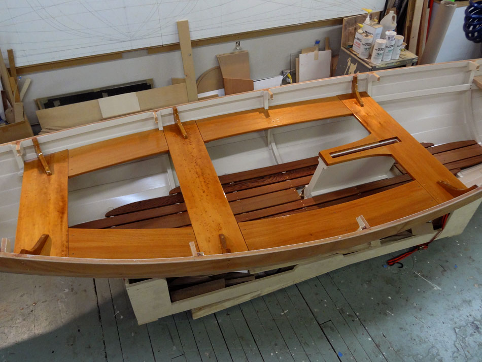

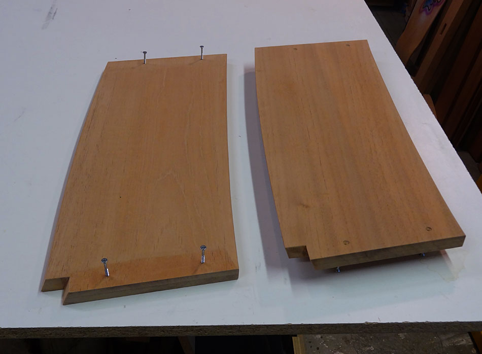

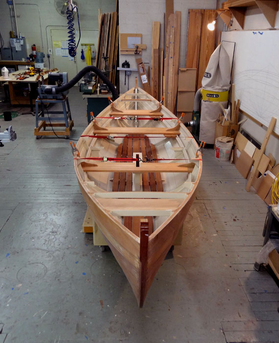

    Side benches continued...
    Laminating in a bit of arc worked great. The benches fit the riser curve well. I meant to say before, that I wonder if I should have spiled the riser,
    and cut it out of a wider piece? I may have been able to keep the top edge flat that way.
    I sprung a batten around the whole length of the bench, sawed out the curve...
    ...and cleaned up the cut with a compass plane.
    Here are the benches with the curves cut. I still have to get out the daggerboard cap, and bevel the undersides of everything to lighten it all
    up visually before I install the lot permanently.
    I left a little space at the ends of the benches against future swelling of the thwarts. Its pretty dry in the shop, and I don't want to start pushing the frames around.
    I'm looking forward to a little break at xmas for another push. I need to get the boat out of the shop!
    Jim.

    Jan 2008
    314
    Scupper holes for the side benches? You'll want them to drain off to the bilge when you pick up splash and spray on the low side. Otherwise, when you tack, you're going to have the remnants of that puddle of water to sit on when you move over to the new high side.
    You're right about that, James. I guess I could have left the benches shy of the hull sides. I sort of hate to cut them back now that they fit well. Any suggestions as to how else this might be contrived? This will all be kind of under the deck, so visually its not right in your face. Limber holes? Elongated slots at the hull edge?
    Jim
  39. #39
    May 2006
    Uppah Ballard
    5,773
    Can you just unfasten the side benches, trim them a bit (or maybe just a nice bullnose, plus a light trim) and reinstall?
    Yeadon is right, of course.
    Hey, where's my Hvalsoe 19?
  40. #40
    Apr 2007
    Anacortes, WA
    8,249
    I'd definitely at least do holes or slots or something, I guess. It would be a good idea to make them big enough and plentiful enough so that you can pass a cord through them to use as tie-down/lashing points to secure gear and drybags and equipment securely out under the benches for when you cruise this little honey. You simply can't have too many tie-downs, and lots of versatility keeps your options open. Like all limber holes, make them bigger than you think you'll need so they drain really well and can't clog on a leaf or a candy wrapper.

    Thanks to everyone for the feedback on this project. I'll definitely add scuppers to the benches. I'll either cut them back a quarter inch or so for the whole length, or I'll make some cutouts. Nothing is fastened in yet, so its easy to do. I'm going to varnish everything after detailing the edges, and then fasten it all in. No work on the boat tonight though, hard day on the job site. We are just finishing up a figured bubinga kitchen and living room in Greenwich Village, all but the last bits of hardware. I had to lay down in the tub tonight.

  48. #48
    Dec 2001
    Northern NSW Australia
    36,650
    A lovely job Jim ,great details .
    James , the seat limber holes idea noted .
    Perfect is the enemy of good.
  49. #49
    Jan 2008
    314
    Happy New Year everyone!

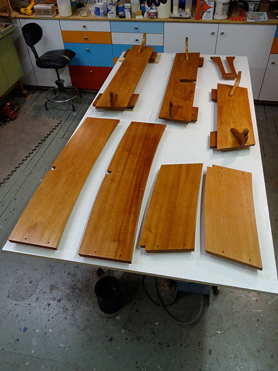

    We made some progress on "Mouse" over the holidays. I did end up cutting back the outboard edge of the benches as suggested, to drain water.
    I beveled the underside of all the parts, and rounded the edges over with drawknife, spokeshave, etc. Faster than setting up a router, and easier to
    work in the transitions to square from round.

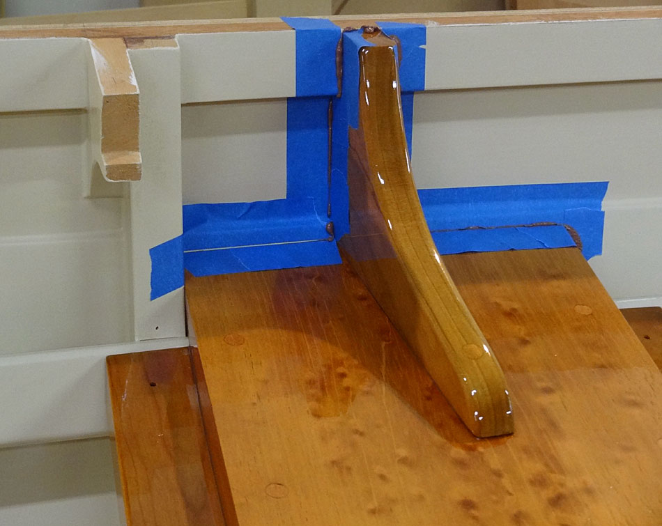

    I sanded up all the furniture, and put a sealer coat of amber shellac (for a little warmth), and 3 coats of Zspar 1015 before installing the lot.
    I bedded the knees and thwarts in sikaflex, taping off the finished areas first, to aid in clean up.
    Everything is in now for good.
    We're on now to the mast partners and decks. I just spoke with the sailmaker, and I'm sending him the drawings today. I'd like to get started soon
    on the spars.
    Jim
