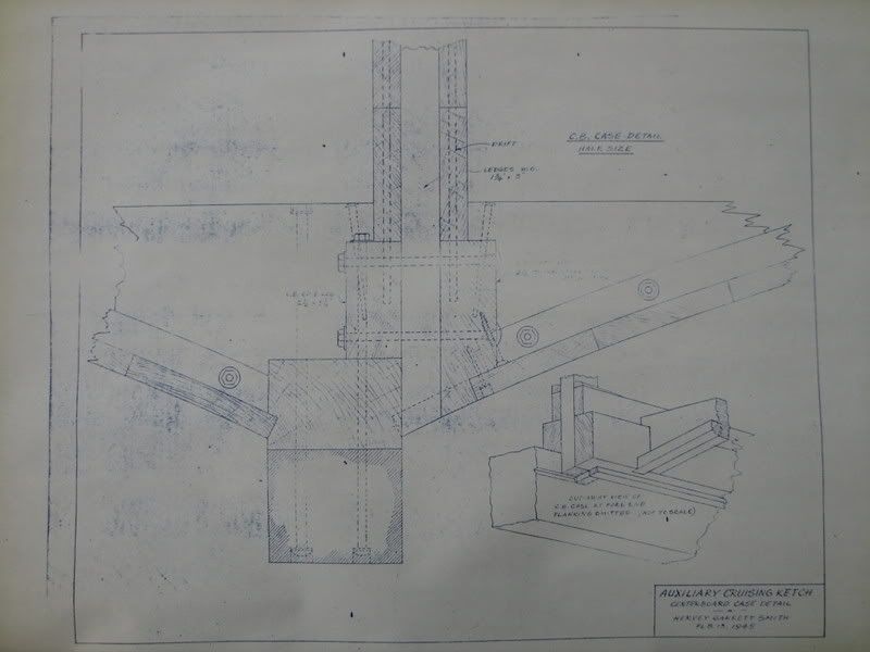

    The centerboard on the Modesty (36') is 1 3/4" thick. Red oak drifted with galv. steel. Seems to have lasted okay for the last 28 years and hoisted by a simple tackle on the cabin top.

    Thanks for that, Merlinron. I had to read through a couple of times to get the gist but it seems like a good method.
    Of course, your right, Ian, asking Mr.Brewers opinion of the wood board is the thing to do. Going the whole route and asking for a design with construction details scares me a bit though. Asking architects how something should be done is often something I regret, wishing I'd kept my mouth shut. I mean, a solid wood board, even a triangular one, shouldn't be a difficult piece of work. Nor should a through-bolted case instead of a plywood one. The only difference would be the increase of an inch or so of width to the board, slot and case. Not much really.
    As for widening the keel, the design calls for cheek pieces to be screwed to the sides of the keel to increase the back rabbet. Widening the keel would incorporate these cheek pieces into the keel itself, leaving the bilge architecture pretty much the same.
    Now, how about boxing the heels of the frames? I want to but the design calls for frames stopping short of the keel, bolted to the floors. Very good for drainage and easy to build but..
    ..a catboat endures a tremendous amount of torque. That big, unstayed rig up forward, working against that beamy hull puts a hellacious amount of twist on things. Sea Rover has frames 1 3/4" by 2 1/2" half dovetailed 2" deep into the keel with wedges that locked everything in place. Crosbys did this and it's not an uncommon detail in many older boats. Seems better, somehow.
    You see, I'm not experienced with working from designers plans and I'm not sure how much is written in stone and what's intended to be left to the builders discretion. The shape of the hull, the rig details and general layout are what I want from the plans. When it come to the joinery, I'm kind of opinionated and don't take instruction well, unless I happen to agree, of course.

  34. #69
    Nov 2006
    8,082
    Default Re: Lofting the Brewer catboat
    After the marks are transferred to the profile, the long lines can be plotted. These shown are the after portions of the buttock lines. They look neat, however they needed considerable tweaking to lie near their marks. Some of the marks couldn't be hit without bending the battens out of a fair curve. Hence the light pencil marks on the body plan. Things will have to be erased and redrawn until the views agree.
    I should mention that at this point the table of offsets has been put aside except for reference. From this point on, the battens will determine the final curves.
  35. #70
    Apr 1999
    Hyannis, MA, USA
    43,948
    I'd double check the off-sets. They should give a fair curve, even if it's fair in a way the batten does not like. A set of fair sections will not necessarily yield a fair hull.
    Anyway, incredible job. Yesterday I painted Marmalade and plan to get her off the railway today. (That's why I'm up so early - crashed about 2000.) Painting is a wonderful way to really feel the riot of curves in this hull and there's really nothing like easing my arthritic back into the moaning chair with a glass of the good and the sunset giving harmony to the white topsides and red bottom.
