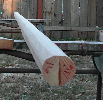

    will - I love the bright look but will probably paint her. The mahogany rails are really nice looking and I'm reluctant to commit to painting them.
    How did you do your spars? I don't have alot of good choices here in the SE so I may just use 2 2x4s from Lowes for the mast. Any suggestions welcomed.

    I made the solid fir mast for my dory skiff from two semi-clear, semi-vertical grain DF 2x4's from a local lumberyard -- you'll want to pick through the stock carefully.
    Worked really well, but all that weight aloft certainly makes the boat more tender. You might consider shooting for a birdsmouth mast from DF, lots of threads here on various techniques.

    In 1996 I used 2x4s picked to be as free as knots as possible. Today I would make the spars from clear doug fir 1x4 stock scarfed and laminated as necessary. I can get these knot free at Lowes. The birdmouth method looks pretty nifty. I just need an excuse to try it out myself.
