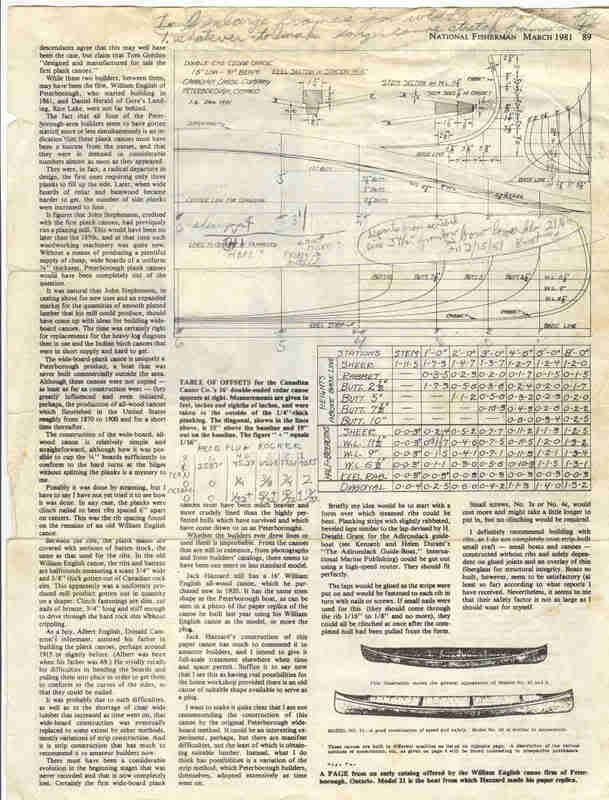

    I tried unsuccessfully to post a copy of a March 1981 National Fisherman article by John Gardner that tells the story of the Peterborough Canoe Co. and/or the Canadian Canoe Co. and also has a set of offsets and lines drawings, which I used for the plug and mold.
    I somehow got it to work, but it is pretty unreadable. Apparently back in the 20s-30s they dominated the ACA sailing canoe races. You've done a wonderfull job on the restoration, the canoe is beautiful. How much does it weigh?

    I stood in mine once and was amazed how smoothly it rolled over and dumped me. Way back then, before cars, and especially up there where water travel was more used than horses and wagons, all the designs were working designs and everybody was pretty skilled in canoes. What's the width of a 12 footer? I enlarged the plans from a 16' canoe in the article to 17'3" and I think it was still only 34"wide at the widest part of the hull which was below the gunnel.
