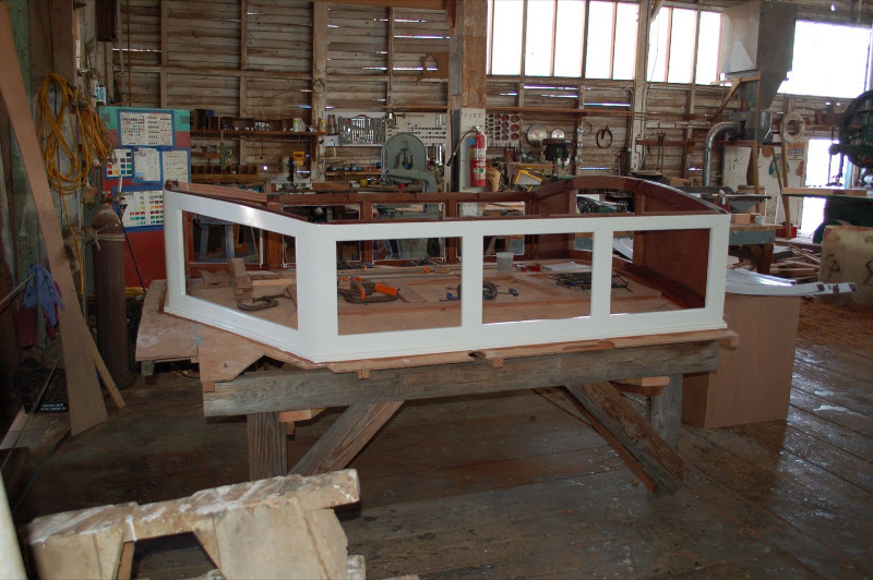

    All pre-painted ready to go together this week
    Jake

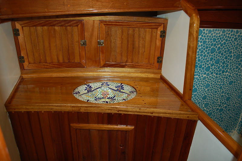

    Absolutely gorgeous Jake. What is the "Smiths" that you refer to and what sort of timber have you used to frame the pilot house?
    Larks
    LPBC Beneficiary
  6. #106
    Oct 2006
    Lake union Seattle
    582
    Default Re: progress
    Thanks Peter, sometimes simple is harder to do, it had to be sturdy basic and be able to come apart and fit into the boat while staying the right size.
    Larks the smiths is penetrating epoxy, I have 4 coats of varnish on it now, I'll get a pic up later. The whole pilot house is made out of sapele. The top will be t & g wrc with 1/4 ply epoxied over.

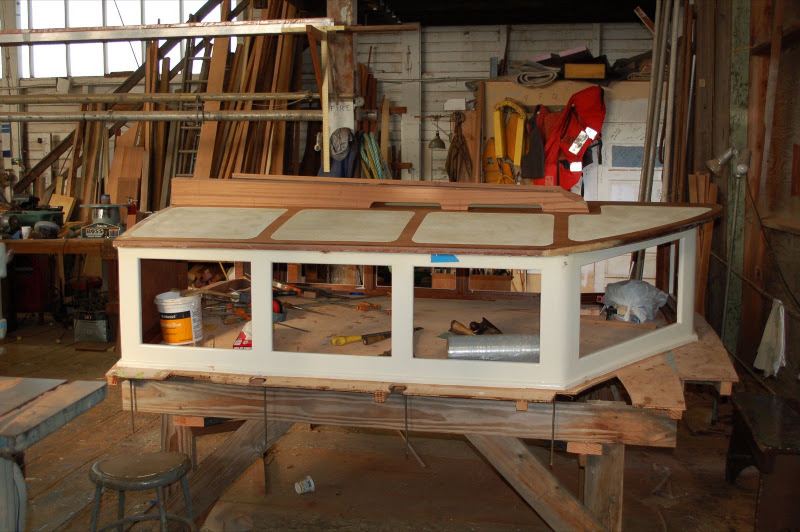

    Top is epoxied and non skid on, hatch rails are made and the hatch is close
    Jake

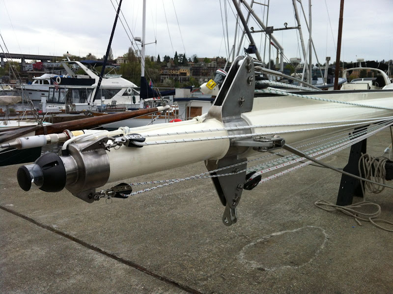

    Thanks for the updates. A great story.
    Paul T
  16. #116
    Oct 2006
    Lake union Seattle

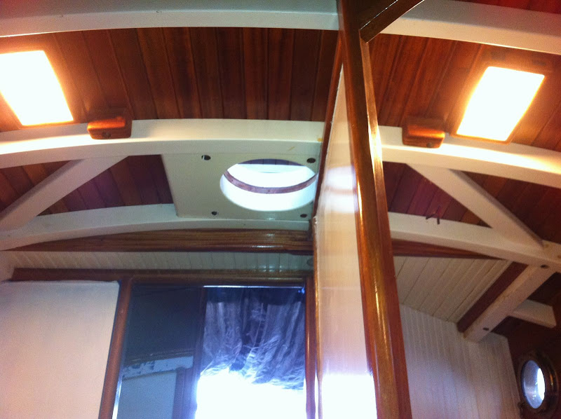

    Cut in and framed the companionway can walk into boat without any climbing and crawling, been awhile.
    Now I have to build some doors

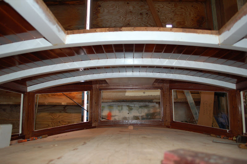

    Default bits and pieces
    doors and windows..
    more to come.....
    Jake

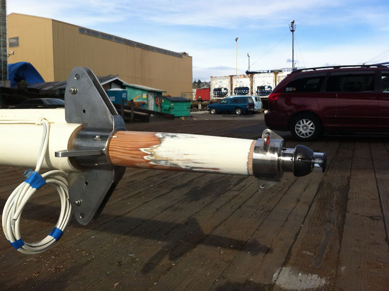

    Well, some real progress. we had our esteemed NA look at building us a new main mast several years ago but tabled it to focus on getting the interior of the boat done. In Jan we were looking around for material to think about getting this last of many big hurtles going. The shiprights we have been using off and on asked a fellow from Eden Saw in PT what they had for material, he said " Well I know of a boat that just pulled a stick they are going to replace and it sounds like it may fit" So..... These very nice people
    sold us there old foremast, it was built new in the late 80's but to smaller scantling than the original, so thats why they are replacing it, it fit our rig plan by 8"!!!!!!
    So here is the new main mast
    Building a new step out of purple heart, the old one had to get chopped some years ago to get the old stick out
    A new boomkin is in the works and the partners are almost done. Hopeing to get the stick up in the mid of next month.
    More to come

    new boomkin sealed and ready for paint
    Mast partner blocks are in
    Mast boot collar
    Typhoon season in Seattle today so not the best pics.
    Jake
    Schooner Sassafrass Rebuild Blog Web Album

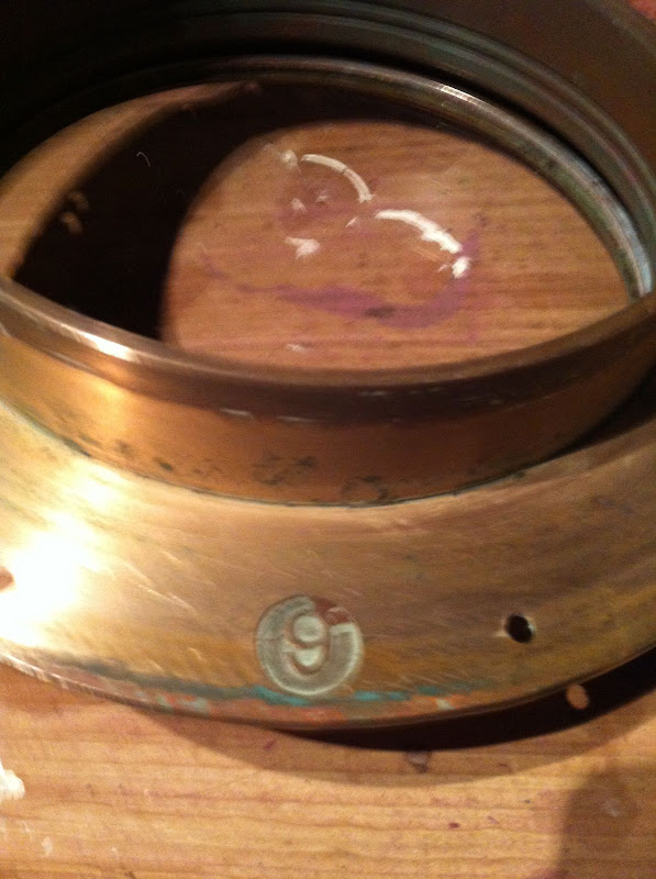

    Picked these up today at the local cons shop 2ea. matching WC 10" opening portlights for the back of the pilot house

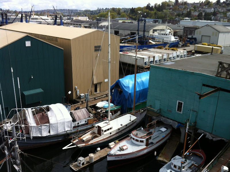

    Well today we can officially be called a schooner again...
    new top fitting for the main mast
    waiting for the truck to take it to the yard for stepping
    rigging on
    Will take some pics of it in the boat tomorro
    Jake

    Some arial bridge pics, off the ballard bridge, we are indeed a schooner again.
    boomkin fitting is in so ready for finishing up the rig
    thats all for now
    jake

    Getting the galley closer got the rest of the counter done, the butcher block side. still need to make drawers
    Electrical panels are in, so the wiring starts
