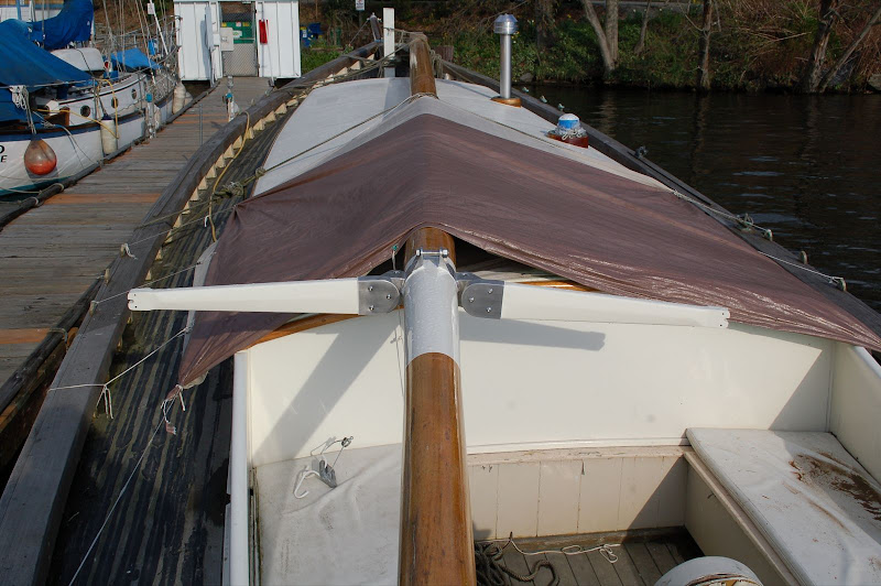

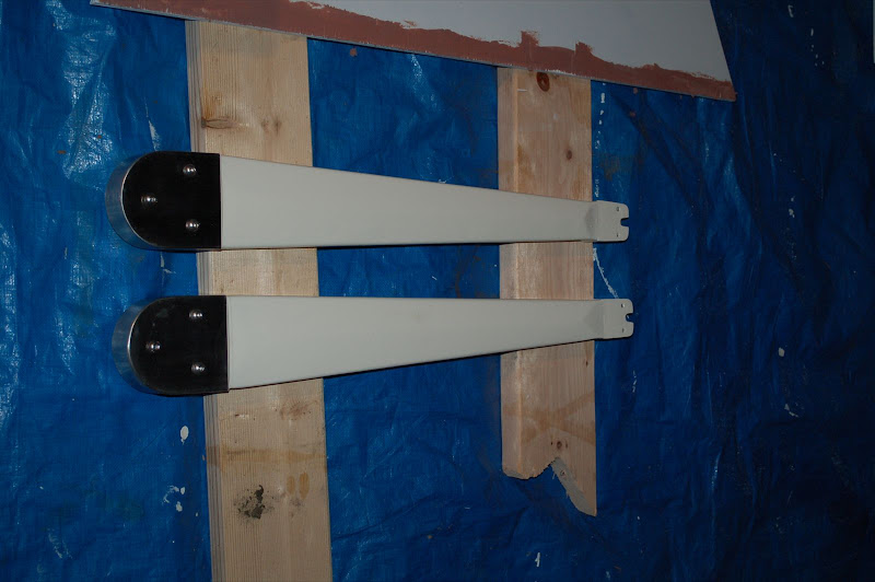

    Back to work Sunday, had another push forward last month. We had high hopes of stepping the formast but didn't quite make it, I still have to make one more band and wrap up the wiring etc, but we are close all the fitting are on the boat and mast and the wire is all made up ready to go on.
    Spreaders and mast cap

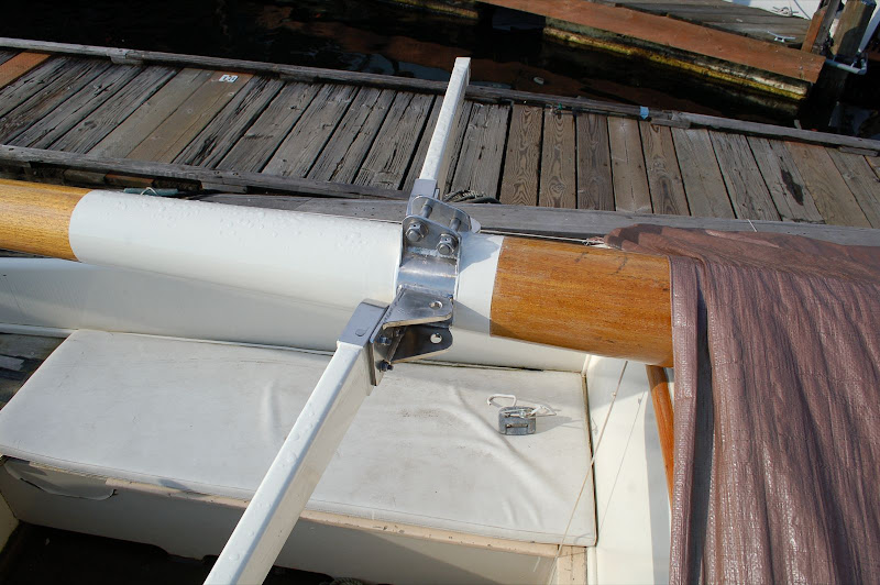

  4. #54
    Oct 2006
    Lake union Seattle
    578
    Default Re: progress

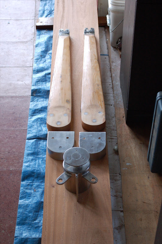

    The gammon iron strap and whisker stay tangs are done
    Things are filing out in the ends of the boat.
    Pilot house space is taking shape
    Fuel tank is finally in
    Schooner Sassafrass Rebuild Blog Web Album

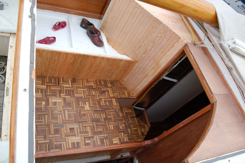

  5. #55
    Oct 2006
    Lake union Seattle
    578

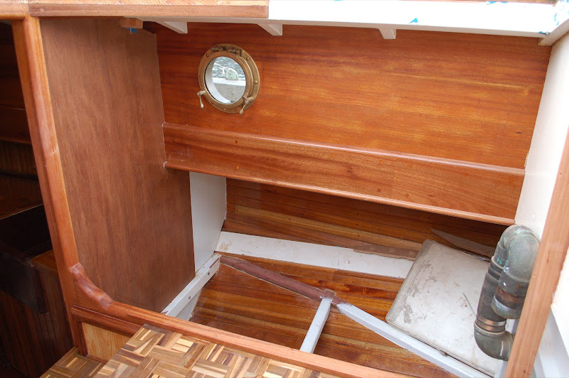

    This will be the future man cave slash nav station shop etc
    More to go but at least we can walk rather than climb below now

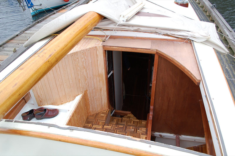

  6. #56
    Oct 2006
    Lake union Seattle
    578

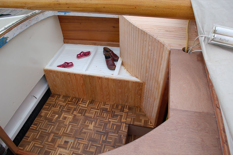

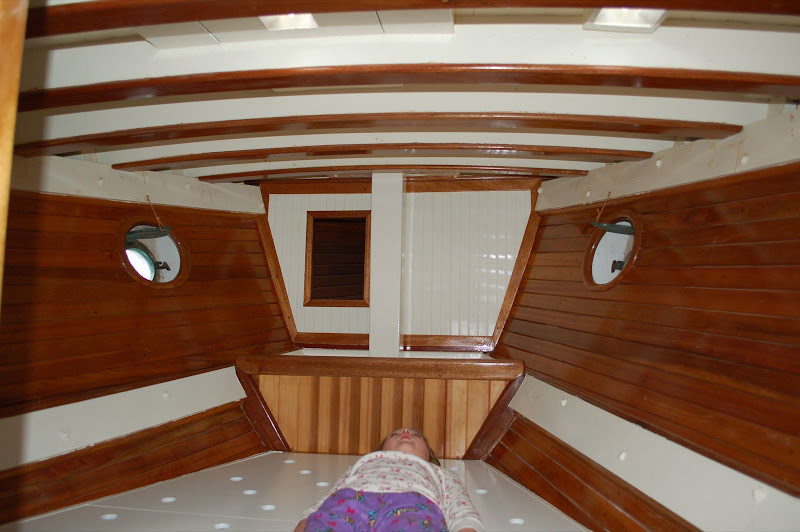

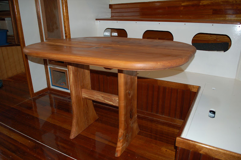

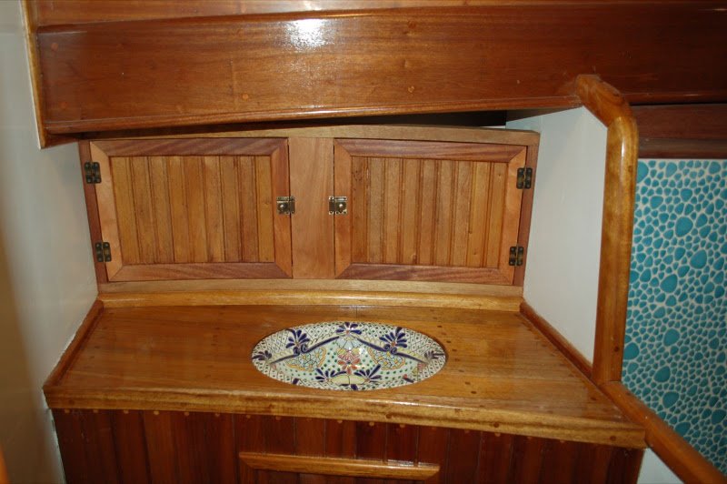

    Aft cabin is coming together
    Fwd cabin, bulkheads done and ready for some lockers etc but close to usable
    Thats all for now, next step will be laying out the pilot house hopefully to go on the summer.
    Jake
  7. #57

    Very nice and clean finish work! I really like your vertical staving work too! Are they tongue-n-grooved,splined or bead and coved? Will those in the pilot house be painted or left clear? Nice work on the mast fittings! So many nice things to see, along with a growing case of boat envy from me!!

    Quote Originally Posted by SV Papillon View Post
    Is it just me or has your mast developed a slight bow to it?
    Peter
    J.Lennon

    The lighter wood is all off the shelf fir t&g on one side beaded on the other. The aft cabin bulkheads are built as a hollow structure with sound proofing panels in them. The fir is not too thick so it worked out well for this. The mast does have a aft bow in it, was that way when we unstepped it.

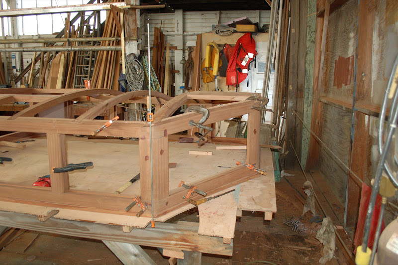

  15. #65
    Oct 2006
    Lake union Seattle
    578
    Default Pilot house

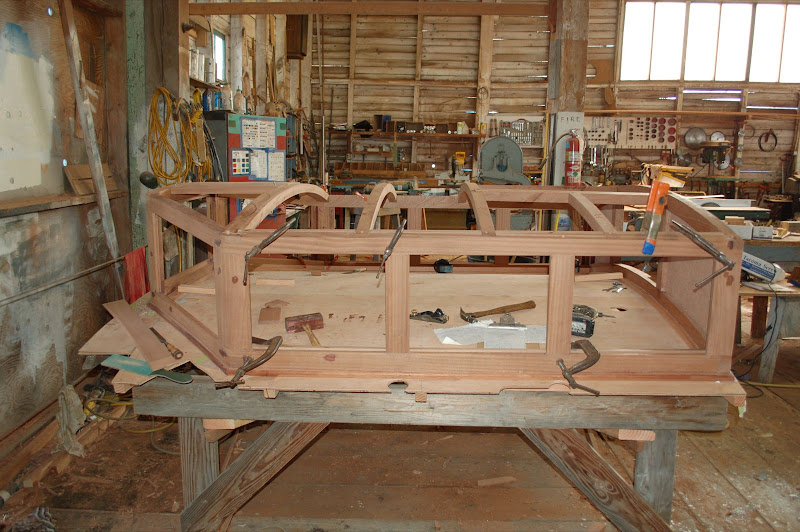

    Laying out the pilot house this week.
    Started with 24" height and the same camber as the deck house 11' rad
    That TR he is pretty clever, so down it went to 20" and more camber to the top 22" on CL
    The rather odd bulwark will fade in when the lifellines go up. Eventully when the decks get replaced a new one will go in with a more even shear and not the substantial drop aft.
    Jake

    Funny thing Jake, when I saw the first picture of your pilot house mock-up I thought," Hey that looks rather good and just like something Tad Roberts would draw." In fact I was already formulating a reply in my head to that effect as I continued scrolling down before reading that it was indeed Tad's handywork. A nice style or signature for him to have developed!
    A very handsome profile for your boat Jake and something I've been told is very much appreciated out on the West coast...sometimes
    I look forward to seeing how you build it.

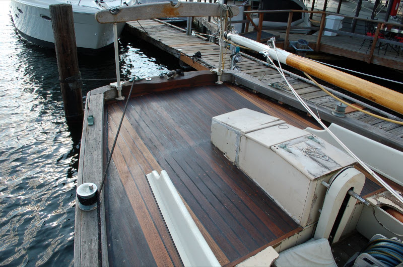

    Default Decks
    Well closing in on the deck re-furbish.
    This after sanding all the paint off routing out the seams and overfilling with teak deck systems
    That is how she sat for the last 2 years
    I used the fein tool and sharpened the scraper with a file to remove 90% of the exess caulk, then sanded and put one coat of Daleys Ship and shore sealer and one coat of there teak oil, then the fun job of knifing out everywhere it had opened up over 2 years and re-shooting with TDS, only 12 tubes vs 110 for the initial job. Then back to sanding the whole thing out and putting on Daleys teak oil. This is 2 coats, I'm guessing it will take 10 or more to get it done.
    Jake

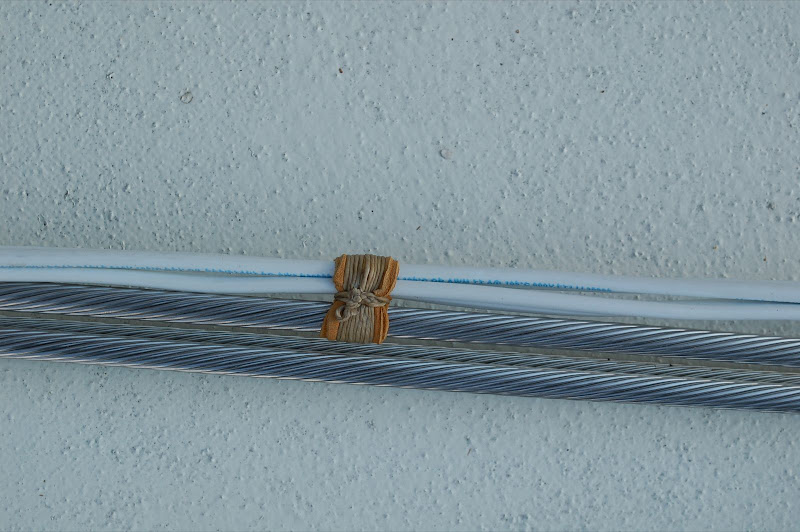

    tree hugger zip tie

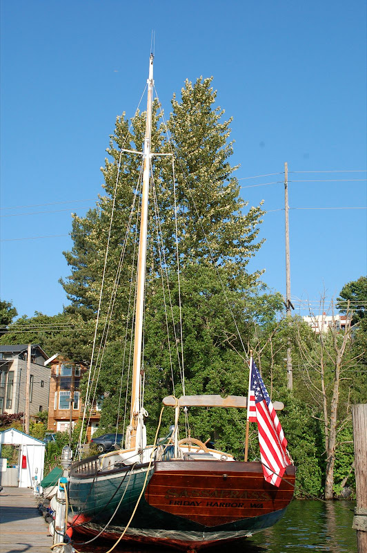

    Well, finally got a stick up. Not a huge deal in the grand scheme of things but a pretty big one for us. Pulling the sticks was one of the first things we did and several years later now having one go back in feels pretty darn good.
    Formalities first
    Original silver dollar and 3 new doolar coins ones one for each of us seemd to fit.
    Heading to Dunatos for stepping
    up it goes

    Its in
    Stays on
    close up of the block bootys

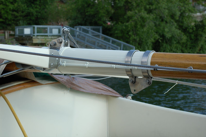

  24. #74
    Oct 2006
    Lake union Seattle
    578
    Default Up Up and Away!!
    Finally the chock Pierre offered as a solution to my bendy mast ended up working out about perfect
    Not without the headaces, I got a little too eager with setting the weges and put a nice check on the other side of the lower block of the partners, I have a plan for addressing it so not to worried about it.
    All in all a good day
    Jake

    Stephen, that was try number 3 on the block booty. 2 days of hand sewing wasted before they came out ok. The worse part is I'm so rusty that by the time I got near the end and was starting to get back in the groove, I couldn't live with the first efforts so I re-did them.

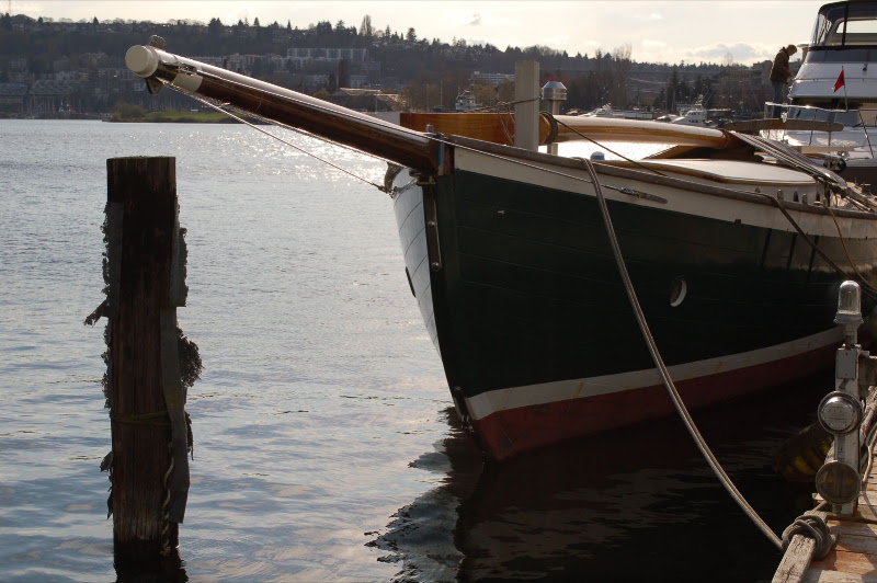

    Default All cleaned up for the 4th

  44. #94
    Oct 2006
    Lake union Seattle
    578

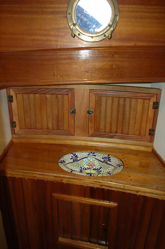

    Default Finishing up the head
    Back to the interior,
    Closing in on the head, 1st big tile job, pretty happy with the results. Got the step/locker in as well.
    Jake
    more in the head, finished the locker doors, this was my first attempt at locker doors so pretty happy.
    about it till fixtures and the head go in
    mocking up the salon table
    more trim etc pilot house seat
    Jake

  48. #98
    Oct 2006
    Lake union Seattle
    578
    Pilot house is getting close
    Red cedar that we used as a template for all the T&G we ran for the rest of the boat. These are left overs from a job several years ago, just enough to do the pilot house overhead. Comes with about 10 coats of varnish from native brightworks, can't beat that
    Jake

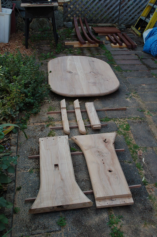

  49. #99
    Oct 2006
    Lake union Seattle
    578

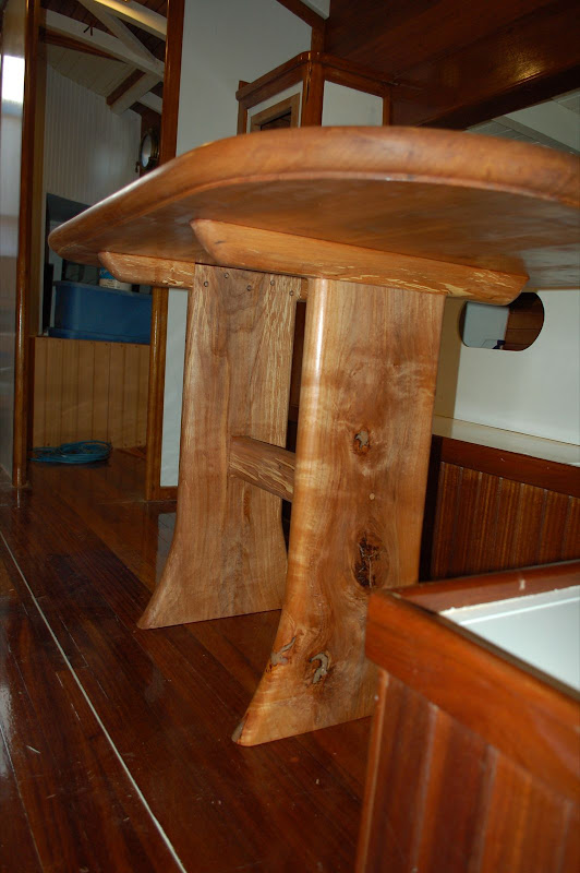

    Default Salon Table
    Getting close
    The lumber, Alder from Anderson Island
    The Bits and pieces
    Dry fit together
    Now some filling, glueing and lots of sanding
    Jake
  50. #100
    Oct 2006
    Lake union Seattle
    578
    Default Salon table
    All together and on the boat, just one coat of smiths. Need to varnish and thru bolt to the deck still.
    thats all for now
    Jake
