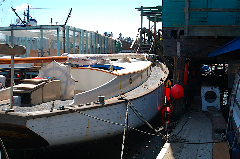

    Where in Lake Union is Papillion? (and is there access for lookie-loos?)
    I am on the Westlake side near China Harbor (*shutter*)...

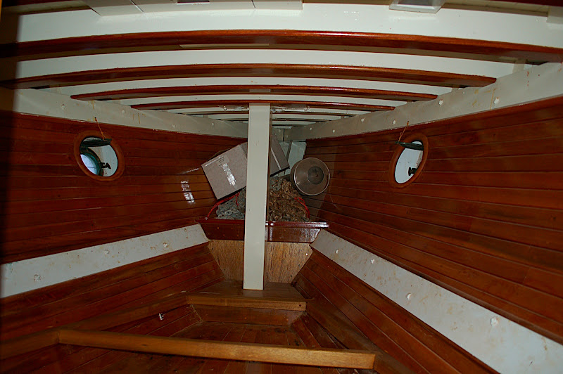

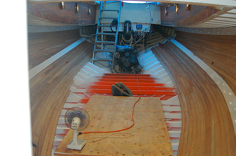

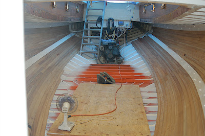

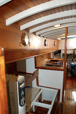

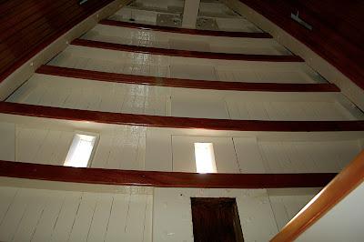

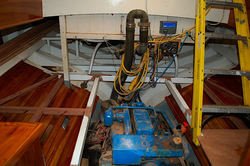

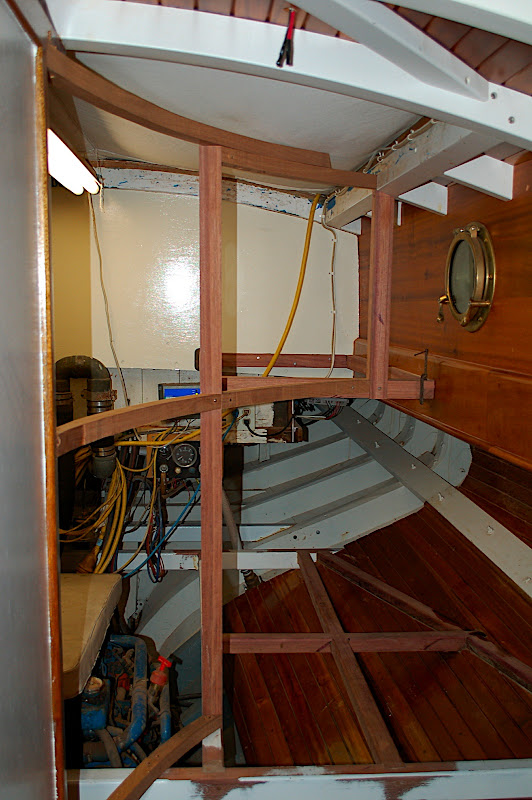

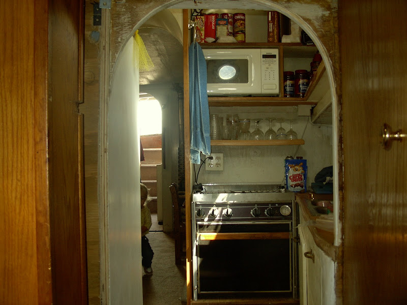

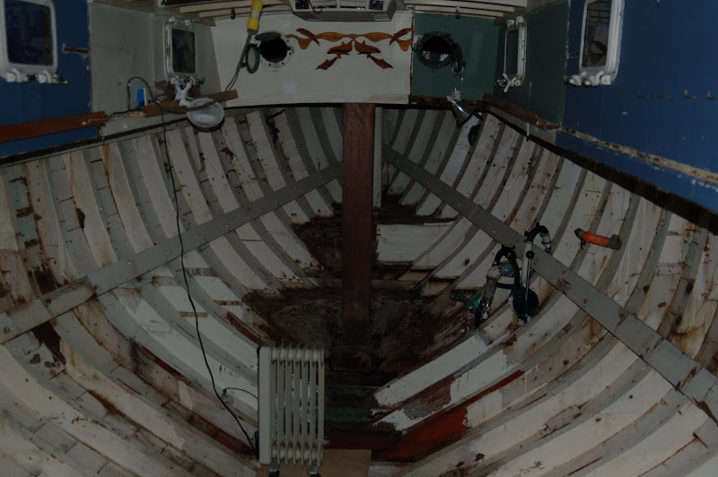

    Finally got the carmera working and a little time to get some more done on the inside
    Before
    now

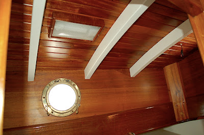

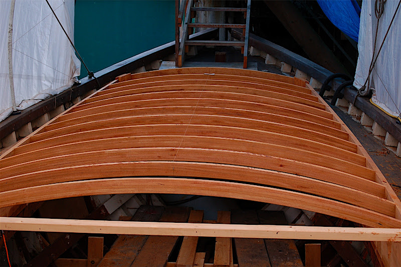

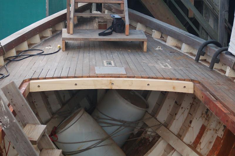

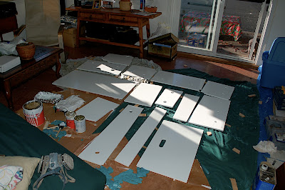

    lights
    fwd beams capped
    water tanks in
    Schooner Sassafrass Rebuild Blog Web Album

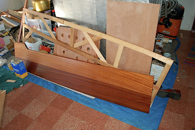

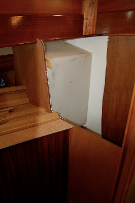

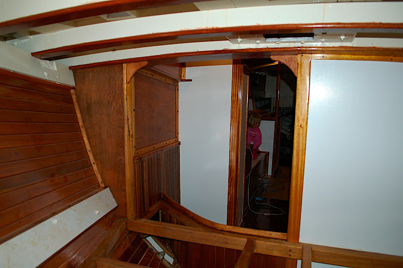

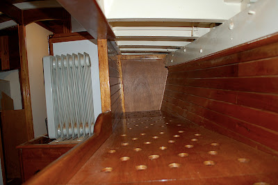

    Default Re: progress

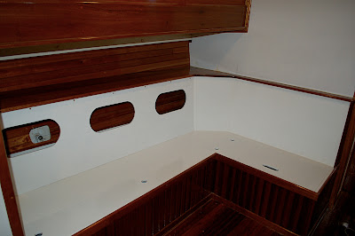

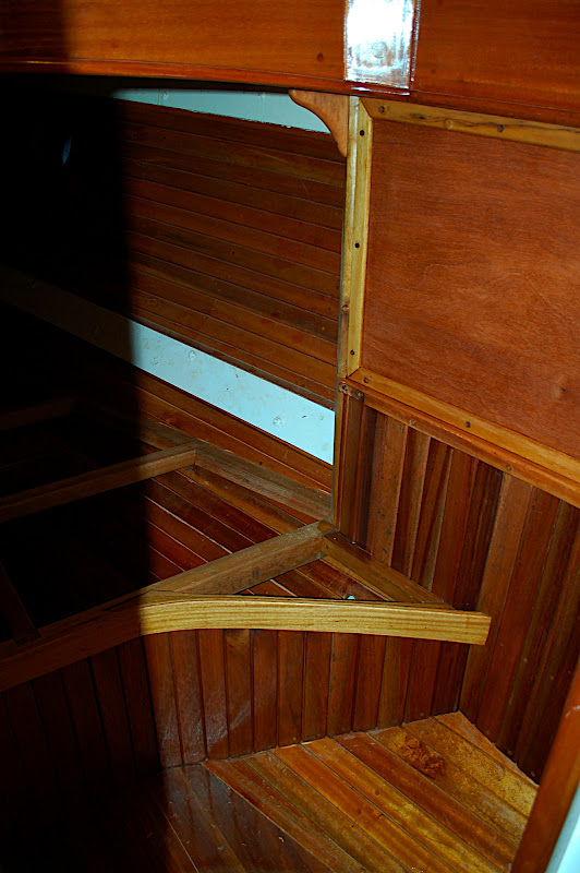

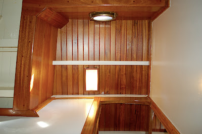

    head
    port sette shelf
    the carlin caps and these are all recycled berths from a fishing boat I used to work on, they were going in the dumpster and a friend saved them
    house/shop/ very nice wife
    thats all for now, whole project is in the link on the signature

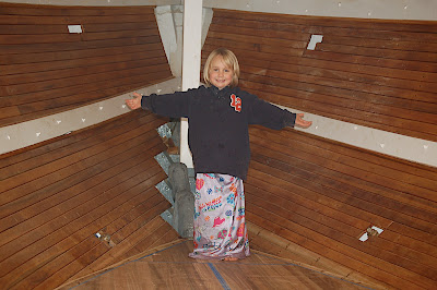

    Default Refit measured in kid years
    going through pics and realized just how long this is taking
    Kido and Nemo at 2 just moved on board
    3 insanity has started
    4 or 5
    and 6
    and he's still around too

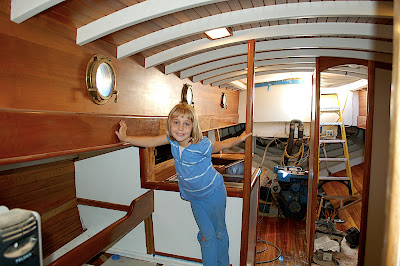

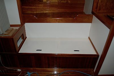

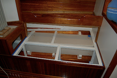

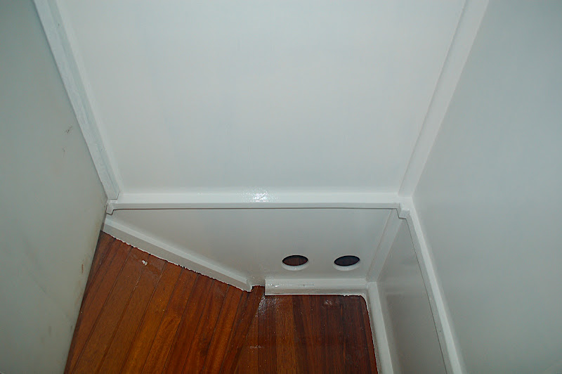

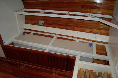

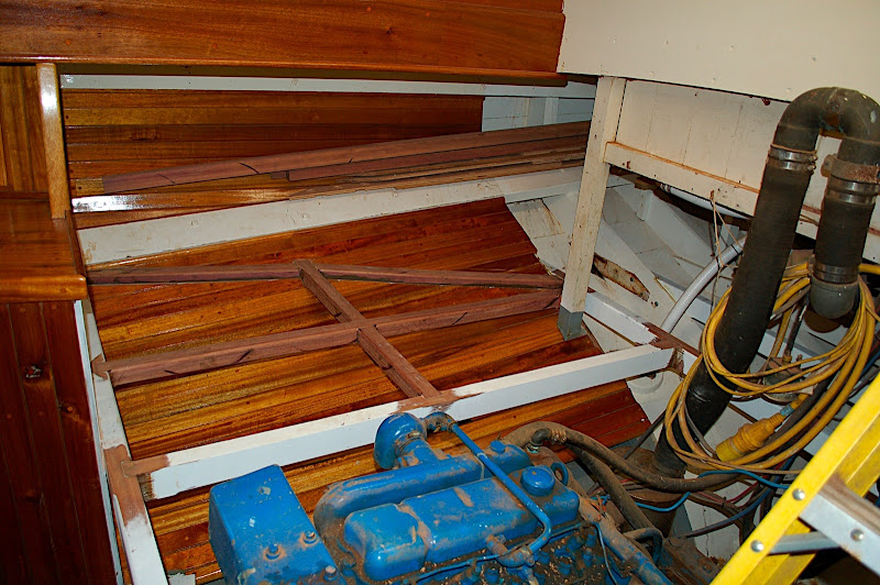

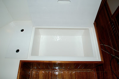

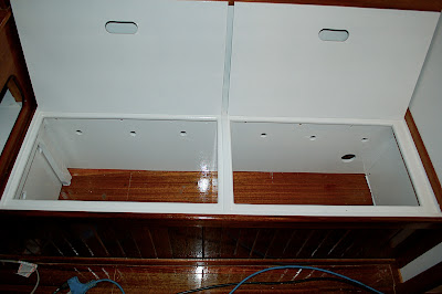

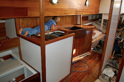

    Settes almost done need to plumb the water tanks and the backs can get buttoned up
    Battery box
    storage port
    extra long pilot berth
    starting on the head

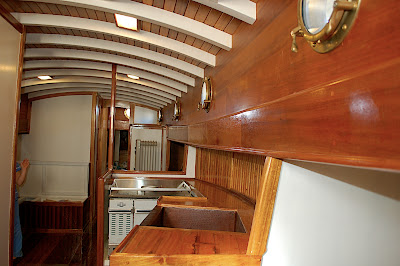

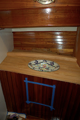

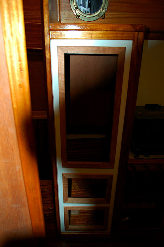

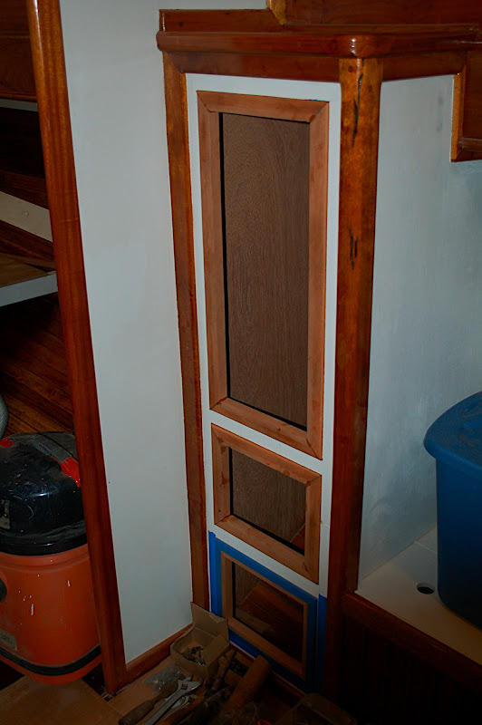

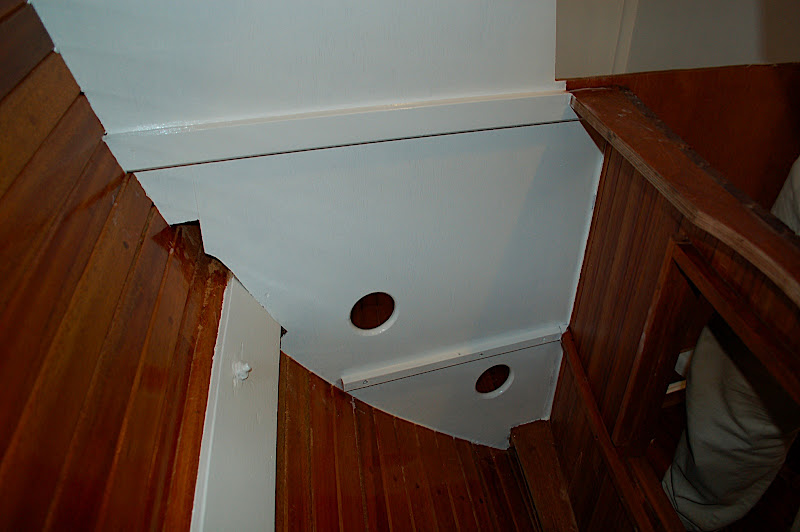

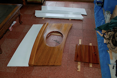

    Head counter and locker door
    Trying to get some refinishing done on the mast with the nice weather of late, hope to step it this fall

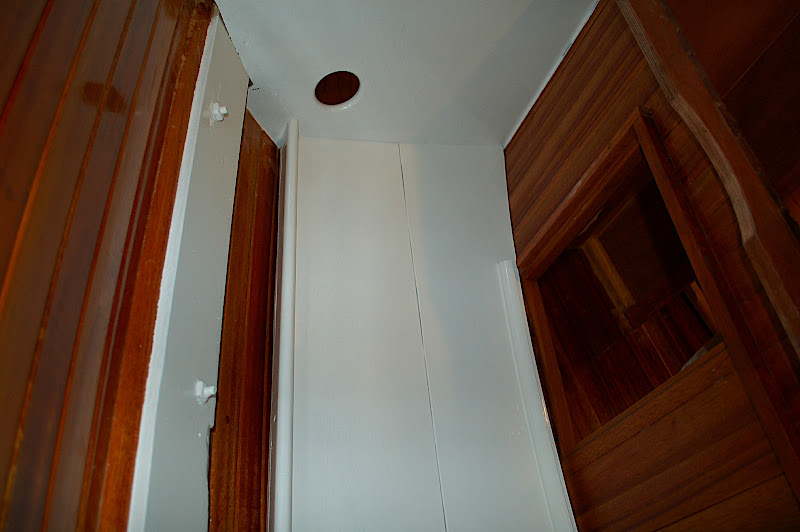

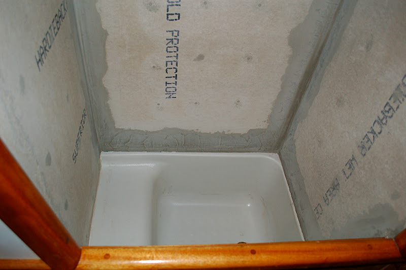

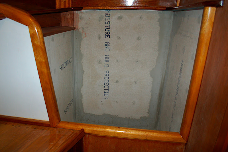

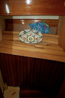

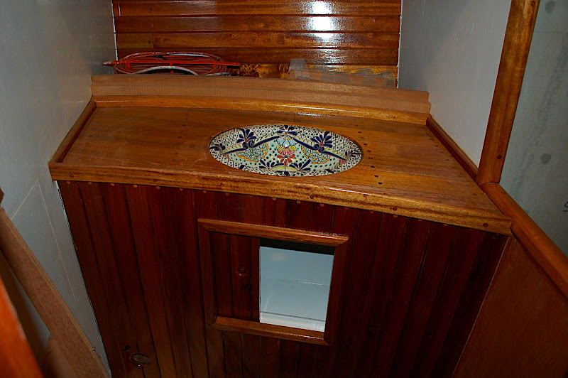

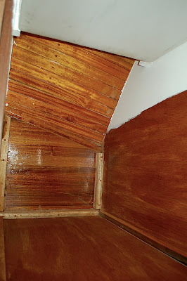

    Getting close on the head
    counter is done just need to build the locker face
    shower and Bob Cleek recommended RV tub ready for tile

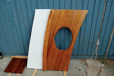

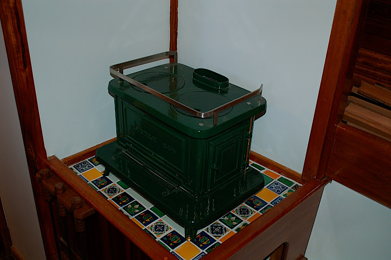

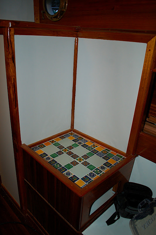

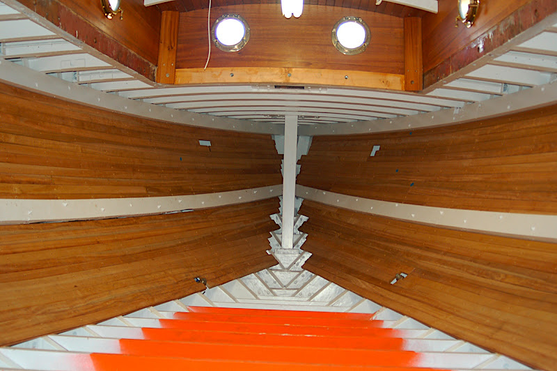

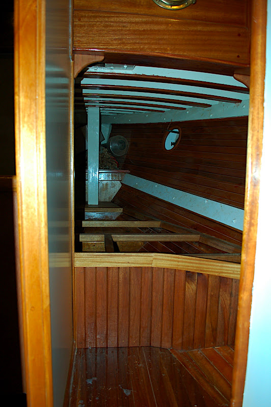

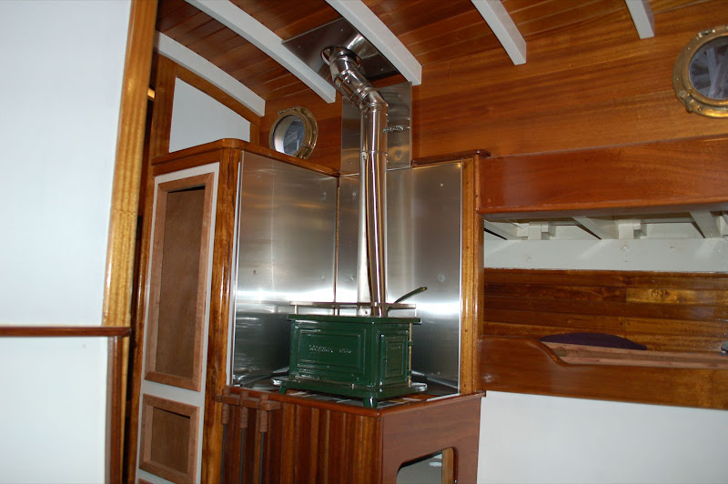

    Making some progress in the V berth, portlights trimmed, berth framed, hanging locker in
    First time putting tile in, home of the Little Cod when I get the heat shields in
    Thats all for now

    Lake union Seattle
    551
    Default little Cod

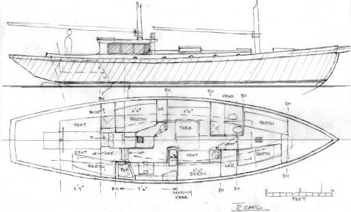

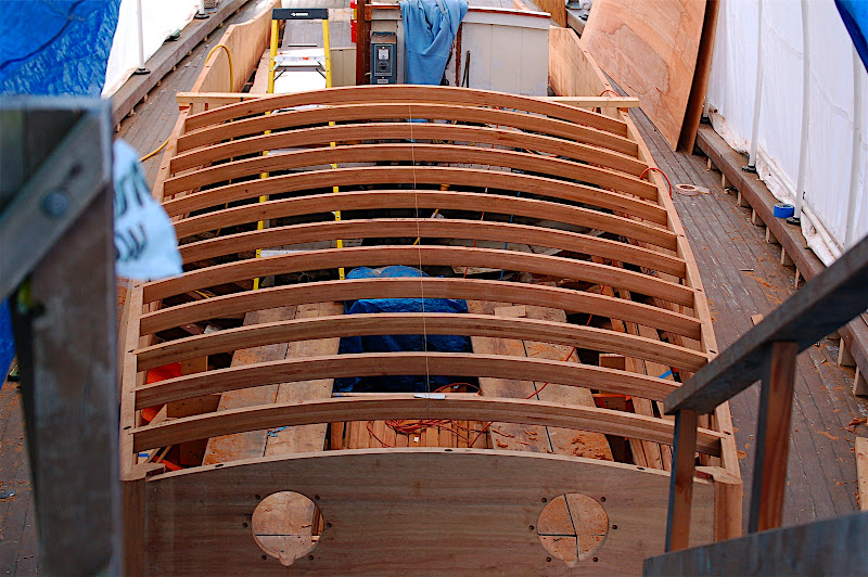

    A little more, started framing aft, have a pretty good idea on the pilot house layout, or at least not as many ??. A little more prep and the fuel tank can go in under the cockpit.
    Starting to trim out lockers etc

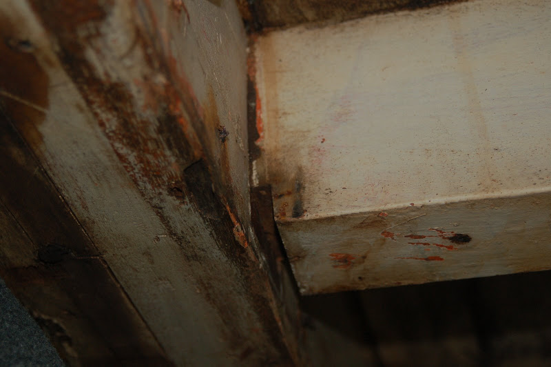

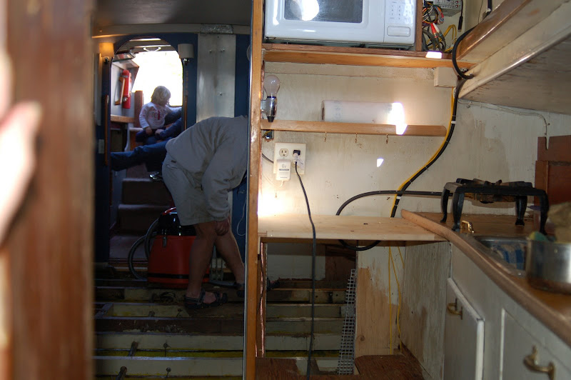

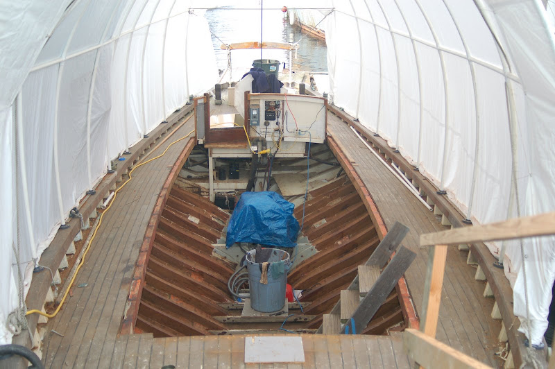

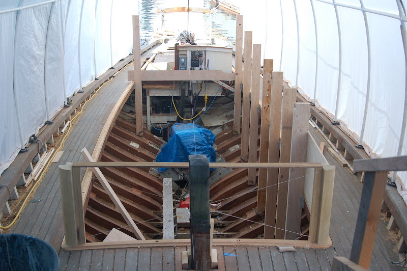

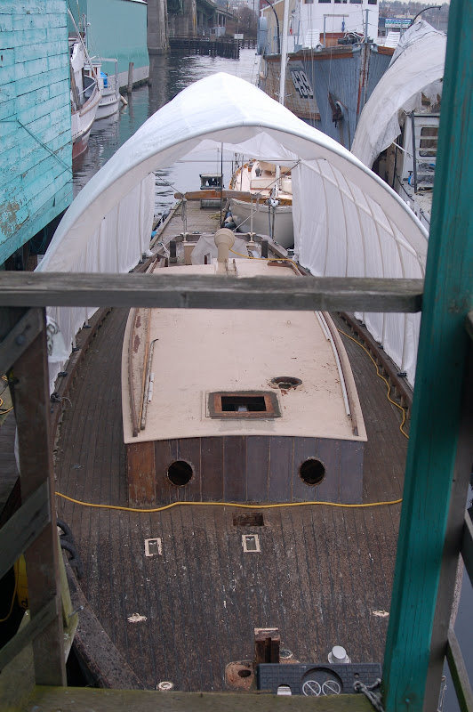

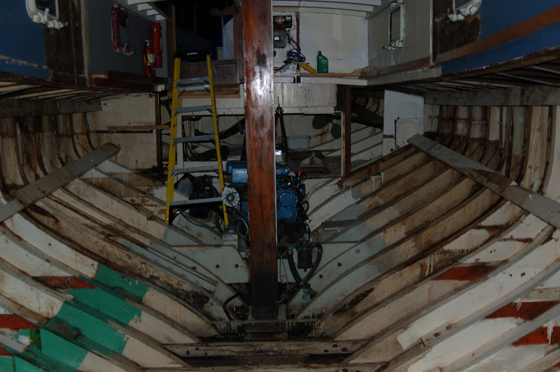

    A little timeline
    purchase
    tearout

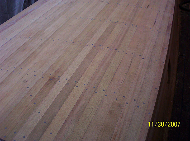

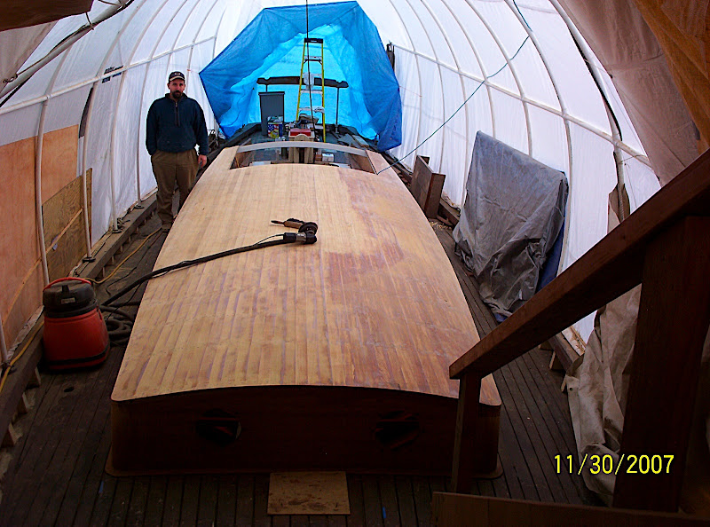

    structure work starts

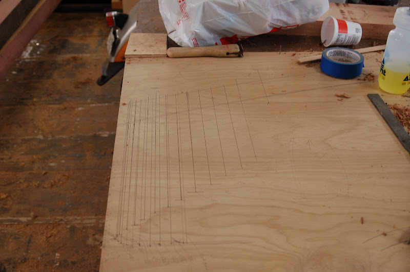

    my first lofting

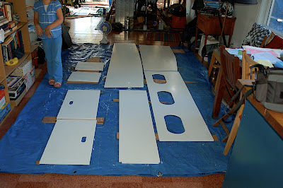

    Starting on the interior
    That is pretty much up the previous pics
    Jake

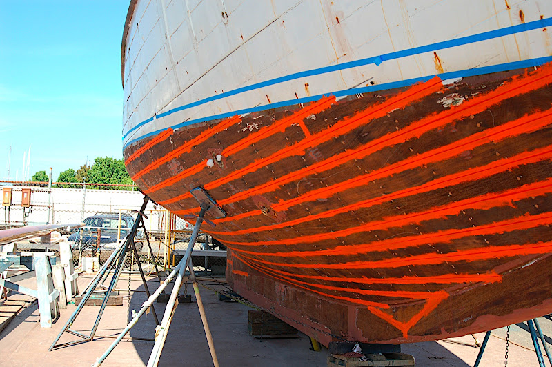

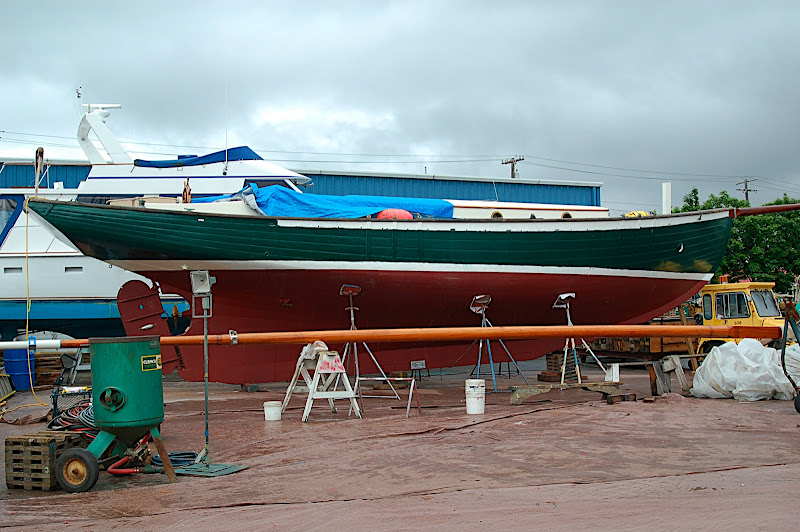

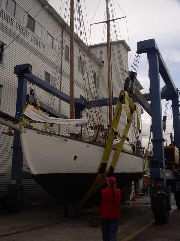

    Quote Originally Posted by Lew Barrett View Post
    Jake,
    Tell the people about the boat. A bit of background.......

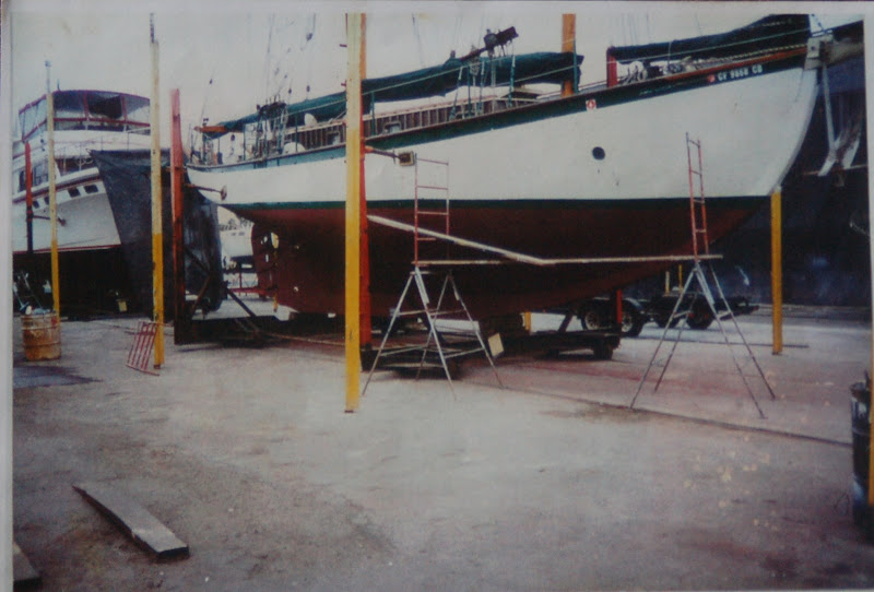

    Don't have alot of history. What we were told---
    Brief Bio-
    Built in Vietnam 1962-63 by US navel officer
    Supposedly sunk 1965 0r 1967
    At some point early 1980's showed up in southern Ca was named "Goodwind" somebody did a fair amount of work in this period, hull was refastned foremast had a repair etc..
    It was also reported that it was used in youth non-profit in San Diego late 1980's
    1997 previous owner Worth Brown, a retired shipwright from Florida, he built the boat "Hootman" which won the 1957 Havanna Cup (used to be a article out there online), bought her in long beach at age 90. With the help of his son and son in law 60's and 70's they sailed up the coast to Seattle in Oct ??
    2004 or 2005 I bought the boat, let Worth stay on it till the fall when I moved up from PV, Worth passed away the week before we moved on. He had planned to cruise to AK and had gutted the interior putting in a basic replacement.
    We stayed on board for six months then started a 2 year refit Ha Ha Ha Ha Ha Ha!
    What year is it????????
    Jake
    PS If anyone has any info on the boat or remembers it from Ca I would very much like to get any history I can

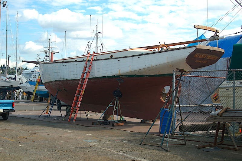

    This is a pic of her hauled out in ca then named "Goodwind"

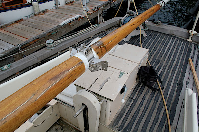

    WOW, Jake!!!

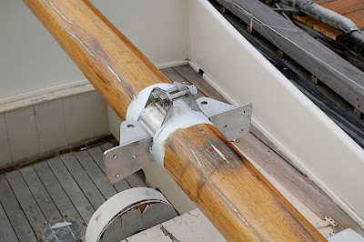

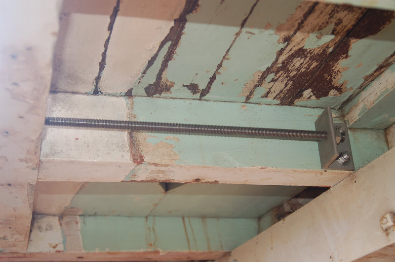

    I remember, quite a while ago, when you showed this horrendous "bricolage" on the foremast (and the near escaped accident when it fell down!), but sorry I had not noticed the new jobs.
    So, I just spent the best of my morning going through all the pictures from the beginning (and yes: your little girl has grown up a bit!!!) and congratulate you for the nice and great amount of work you have done since that time. She is a whole different boat now!
    Your deck - since you asked about it - looks pretty good on the pictures (although 1", which you said was it's present thickness, effectively sounds just that little bit thin for a boat of this size), but it's not possible to say more with the pictures you have. I guess (?) that you will replace the capping rail and the stringer that runs long the inner side, so it will be easier to have a good look all-round the stanchions then.
    I saw that you have replaced the old tie-rods that were going from the beam clamp to the roof carlins by new ones...but why did you make them so long since they are now from the beam side to the carlin???? You could just as well have these angle bars right against the carlin, just allowing for the dove tails, which had opened due to over-caulking, to re-tighten up...and save all this S.S. threaded rod. Would look more neat too.
    Your new roof is a huuuuge improvement compared to the not-so-pretty earlier one, and Tad Robert designed future wheelhouse will be just fine....and so comfortable! Just curious: it looks like the companionway sill will be over the top of the aft cabinside, and not cutting through it for easier access... Is that right???
    It is impossible to say for sure from the pictures either, but the whole boat very much looks like made from "Sao" wood. How well it has accepted the many iron/ steel fittings and nails make me almost certain that it is this wood, which was the top choice in South Vietnam, where she was built...and for an American engineer certainly, who will have designed many fittings (and perhaps the whole boat, actually!). These mast collars are definitely an engineer's job! He imported many top quality fittings too...but left to the Vietnamese to make this steering with what was available! Not going t break down easily...just hope it does not make too much "klong-klong-klong" with this Universal joint
    Keep up the good job
    Luc

    Thanks for the kind words Luc and Peter.
    Luc,
    I think the tie rod location was to get away from the end of the stub beams, it's what the shipwrights wanted to do. The cap rail will be a work in progress as you said it is very hard to get in there. Tad has been great about steering the vision and emphasising what can wait. The cockpit being one, we will eventually take it back one deck beam and put the wheel directly on the worm gear at a slight angle, It is pretty tight with the binacle installed. The companion way is a work in progress, I wasn't sure where to put it so I finished out the aft side of the house and will cut it in when the boat tells me where. Alot will depend on how the pilot house comes together, center port stbd etc. I'm going to look up "Sao" wood now
    Jake

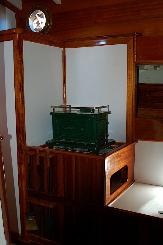

    Little Cod done
    Jake

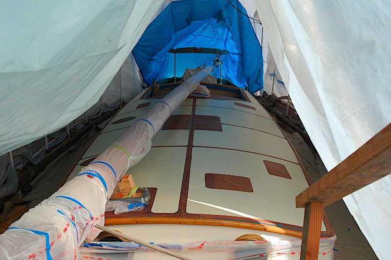

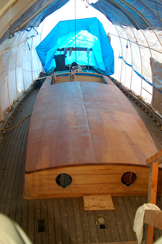

    Is this still the plan for the pilothouse? It's going to look great.
    -- Tom (boating blog)
