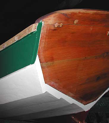

    As long as we are well and truely hijacking this thread, here's some pics of my dory with the new interior and exterior paint -- Rustoleum marine white and Kirby's Blind Green on the sheerstrake:
