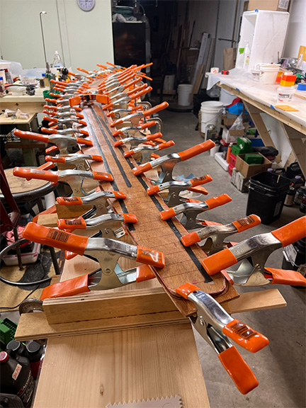

    Back late in 2021 I approached building from plans the amas/aka package developed by CLC for their Waterlust expedition canoe. The amas were easy enough but the aka to connect them to my Waterlust required four laminations of 5mm ply for its twelve foot overall length:
    So I set about figuring out how I could cut the required pieces of ply that would then be scarfed to length before being stack-laminated to make the completed aka beam, then profiled to final shape.
    Having paper pattern for the aka helped so I laid out as best I could the pieces required with an allowance for leaving material sufficient for some misalignment when doing the scarfing as well as staggering the scarf placement in the final assembly.
    Scarfing was straightforward done with a router, and the pattern helped in getting the alignment close enough once I'd built a router carriage:
    Once the pieces had been glued-up into their final shapes, the full beam got laminated thus:
    Final shaping was done as though I'd used solid wood, with a pattern-following router bit then edges rounded.
    Took time but saved me probably a full sheet of ply had I tried to first rip ply into panels wide enough to get the curves required after they'd been scarfed for the length needed.
