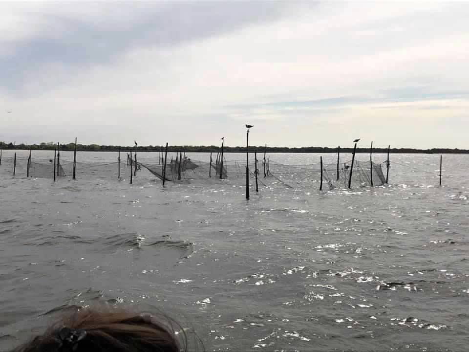

    How die the pound nets work?
    Anything like the Scottish Stake nets?

    Your inquiry about how the pound nets worked was properly depicted in the drawing a few postings back. The fish swim parallel to the shore and when they come to an obstuction (sand bar,jetty, or net) they turn and swim toward deeper water. They then swim parallel to the net , through a couple of boxes and into the final box where they are literally baled out of the water. Many of the nets had wings to guide the fish along the net that was perpendicular to the the shoreline. Very efficient and I always heard that the American Indians developed the pound fishing technique, but I cannot say that is certain.

    Thanks for that. The diagram is of the Scottish salmon fishery.
    There was a more complex fish trap used in Morecambe Bay, called baulks, made of rock walls, woven wattle fences as well as netting. Unlike the Scottish ones pictured, they only fish on the ebb tide.
    They date from at least the Middle Ages.

    Nick, Yes, the Scottish stake net you posted is very similar to a pound net. Pound nets though are not permitted to run up to the shore, they are completely in open water. They were at times 1/4 to a half mile out in the Atlantic.

    For anyone interested in the minutiae of pound nets these current regs for New Jersey covers them (sort of just interesting reading too).
    https://casetext.com/regulation/new-...182-pound-nets

    Default Re: Last of the New Jersey pound boats.
    this is what a pound net looks like out in the water.
    Quote Originally Posted by nedL View Post
    Being 1/4 mile off and your need for pound net boats to gather the catch, do they ever ebb off?
    I can see how you could drive the stakes and poles from a boat, but rigging the netting?
    These are found all over the Chesapeake, and are hard to spot in the dark. In shallow water, the big boats can't get to them. I've had a couple of close calls. But I had no idea they used to be set up off the Jersey Shore. How did they withstand the wave action and traffic out there?
    -Dave
    Out in the ocean the stakes were typically 50-70 feet long and set 15 feet into the sea floor. Chains were hung on the nets to carry them to the bottom.
