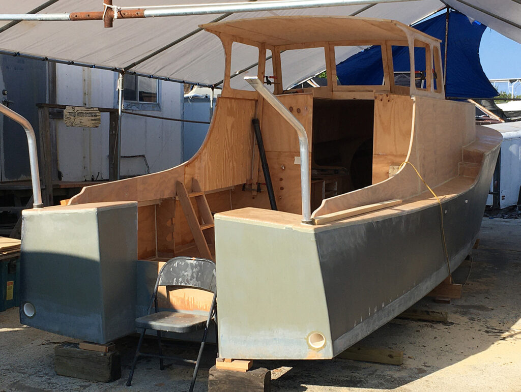

    The new Commuter 325 under construction in our Florida shop–Plans available by special order
    THE NEW COMMUTER 325 UNDER CONSTRUCTION
