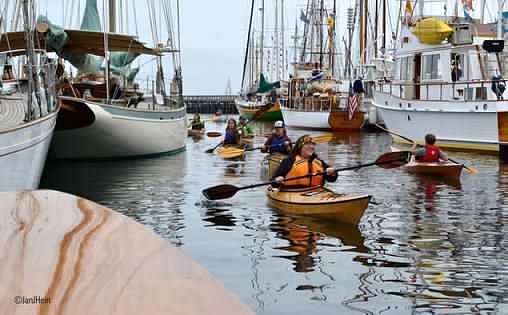

    hmmm, here's a lil pic being used for the PTWBF on Facebook...looks like a CETOL deck in the foreground !
