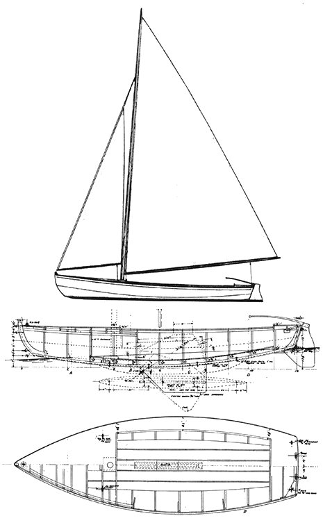

    I glued up the birdsmouth mast for the Herreshoff Biscayne Bay 14 I am building over the weekend, and I am a bit surprised at the ease with which it flexes. The mast is 21' long, keel stepped, and stayed. The timber is Sitka Spruce. At this point it is 8 sided.
    My initial impression of the flex came from how much flex the unsupported length flexes, if I clamp the spar to my bench at deck height. I can easily move the head of the mast 3 inches without much force. Maybe that isn't much over the 18 1/2 foot unclamped length.
    Naturally, and more realistically, there is a lot less flex if I put another clamp at the point on the mast where the stays will be. Once I do that there is a quarter to half inch of easy flex in the top 5' of the mast, and a lesser wiggle in the opposite direction in the middle of the mast.
    I realize that Capt. Nat generally designed light masts, and this design calls for a hollow mast of more traditional hollow construction with what seem to me very thin walls. The birdsmouth spar I have built has thicker walls than the design.
    I also realize that a traditional rig often will have a decent amount of flex. I understand this isn't some super rigid, taut modern rig. I'd just like a reality check that the amount of flex here is reasonable, as this is the first hollow wood spar I have built. I figure that if I am going to do something like add material to the mast, it will be a lot easier to do so while it's still 8 sided.

    Stays and shrouds, yes? Sailmakers routinely deal with the amount of movement you report above the stay/shroud location. Some flex is very very helpful in managing the sail and boat.

    You need that flex, it helps control draft and twist in the sail in heavy or gusty conditions. Thats why the mast is as lightly built as it is.

    14ft waterline on a 'not relatively fat' 5ft beam with 'relatively not small' 11.3m sail area...gusty bay winds...you need that tip to be floppy. As it bends off the sail flattens at the top and helps depower it in gusts. Desirable especially solo.
    Try to build it exactly to plan. It's a mental challenge as much as building a boat and takes controlled restraint and trust. This is a Nathaniel Herreshoff boat. If your mast staves are thicker, it's already heavier than it should be and your boat now will heel, pitch and heave more etc.
    Was it originally birdsmouth or rectangular hollow section?

    The original was round and hollow, constructed from four square tapered staves, which would then have been hollowed, glued up, and taken down to round. The plans show not only the diameter of the mast but the wall thickness, and near the top of the mast the walls get quite thin indeed. I suppose one would have to be able to accurately measure the inside diameter of the hollowed out mast quarters, and then take the outside down quite precisely to get the design thickness. You'd have to trust you got it right, because the final thickness would only be reached after the hollow staves are glued up.
    While I might aspire to this level of craftsmanship, a man's got to know his limitations, and the birdsmouth method seemed much more accessible to my skillset as well as a more efficient use of stock.
    The Wooden Boat articles documenting the build report a final mast weight by the Herreshoff method of 16 1/2 pounds. Mine is currently a little under 23 pounds, and it will lose some weight in getting from 8 sides to round. Some of the extra weight is in the lower end, as I extended the plug in the birdsmouth a bit farther up the mast than the design has solid. I'm interested to see what the final weight is.
