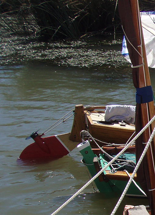

    There is also the option of getting somebody to make up a trolling motor in the rudder blade. I've seen one of these in action and it is amazing. You can row or sail with the rudder up to get the prop out of the water, or release the lanyard to have the rudder drop fully down for power.
    http://forum.woodenboat.com/showthre...electric-motor
    Can we assume you either never rigged your dory for sail or have stopped sailing her?

    I've always been curious boat the boat in this image posted on previous threads. Canoeyawl's advice about rolling the powerhead under is an important data-point, but this boat is out of the Sac delta too, correct? Perhaps extra care must be taken around powerboat wakes?

    Hmm ... fabricate a second rudder that slips into the mount. Don't really need the full rudder as the trolling motor steers so a simple off-set that holds the motor horizontal below the waterline. Just picked up a Swamscott and have been contemplating for our small lake.
