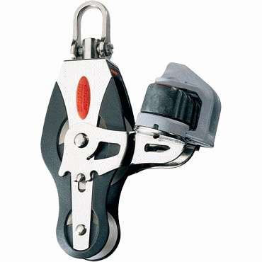

    That item in number 2 is a lock for a wire halyard. Put the wire into the slot and the halyard tension locks the swage in place.
    I don't know what it's doing on the front of the mast This is a dinghy fitting and often lives at the masthead as a means of halving the mast compression effect of the halyard.

    The cleanest solution for the main would be to have the spectra go around the sheave at the masthead -> down the sail slot on the back of the mast -> down past the track on which the gooseneck car slides -> down to a block on the saddle -> then back up to the cleat.
    Hoist the main to the top, cleat it off and then tension the luff by pushing down on the gooseneck car and locking it in place (I'm assuming the car has the spring loaded pin that locks into the holes in the track).

    No mechanical advantage required; it's a small sail. And as Larks says, the halyard is normally fed inside the stick and through an exit at a convenient point. If your stick doesn't have that exit, just drill one.

    You have a couple of options but you need to start deciding some of these things for yourself:
    You can drill a hole above the cleats on the mast, file the edges smooth, stick a screw driver or something inside the hole and bend the top of the hole out a bit and the base of the hole in a bit to open a clearer path for the mainsheet halyard. Then you could either just hank the main halyard down onto the cleat or you could do like mine and run it down to a block at the base of the mast and back up to the cleat if you want the extra purchase (I always found it more convenient to pull the halyard up to the cleat on a small rocking boat anyway and I did like having that extra little bit of purchase for less effort); or
    You could cut a rectangular slot closer to the base of the mast and fit something like one of these that would give you both egress for the main halyard and allow you to pull the halyard up to the cleat with that little bit more purchase if you want it: https://www.velasailingsupply.com/an...UaAjupEALw_wcB
    The roller furler is handy, especially if you like to just head out for a sail by yourself, but a hanked on jib is as much as you need to enjoy the boat. If I had the inclination to spend more $$ on my Hartley when I had it I’d probably have opted for a roller furling jib. If your jib has no eyelets and given the swivel on the halyard I’m thinking that it was probably set up for one anyway.

    I can’t really see how that could ever be a good idea on a mainsheet, or any other line on a boat - any decent bit of pressure on the main from any sort of gust would jam that knot into the block and you’ll be on your ear before you know it because you can’t dump the wind out of the main quickly enough. You really do not want knots anywhere around your sheets and halyards other than perhaps a figure of eight at the end to stop them running completely through a block.
    On your mainsheet I suggest a cam-cleat block like this
    Thanks mate. That'd kind of what I was thinking re the knot and that's exactly what I am looking at.
    Is the sheet (I wrote rope and corrected myself ) getting caught around the tiller a big problem? Or is it OK because you have it in your hand whenever you need to tack anyway?
    Also is there any way to add a jamming cleat to the existing double block or do I just have to buy a new one?
    It seems such a waste when I have these great Ronstan double blocks already.

    No need to buy something new. Fit the cleats to the side decks, near where you helm from. Use the sort of cleat pictured in posts above (Ronstan calls them T-cleats). Use them bare, no guides, so you can throw the sheet off quickly.
