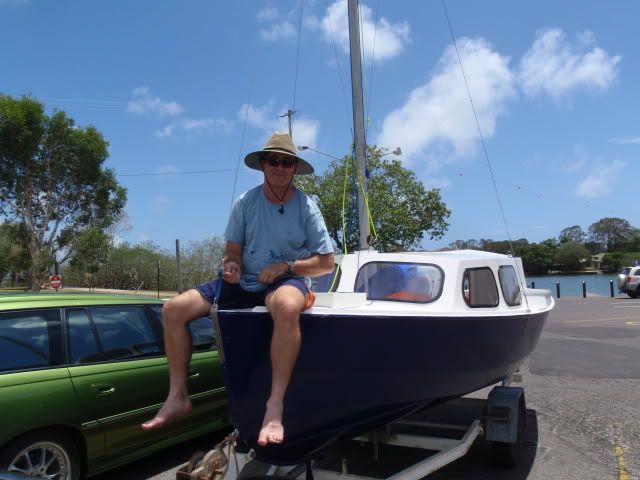

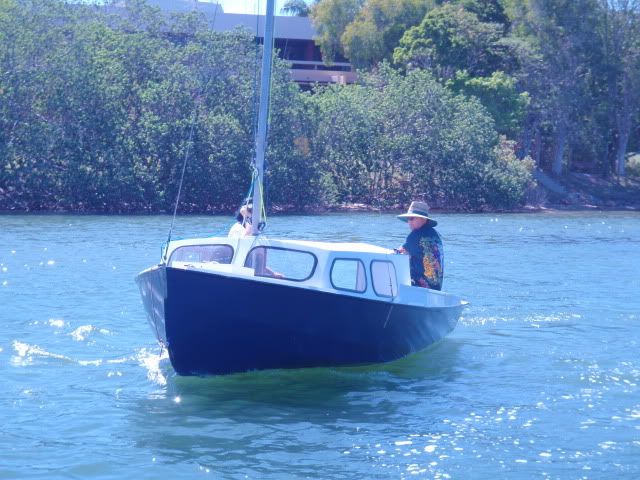

    Not a good pic and it’s a bit old but it might give you the idea:
    [IMG]boat - slowly slowly by Greg Larkin, on Flickr[/IMG]
    Here’sone mid mast raising with the forestay still wrapped around the ladder rack on the ute:
    [IMG][/IMG]
    [IMG][/IMG]

    Re the jib halyard: This is as clear a photo as I can find but it shows mine with a turning block at the mast as part of the same fitting as the forestay mast attachment The cable part hanking on to the sail and the line coming down to the deck for hauling.
    [IMG]IMG_0708 by Greg Larkin, on Flickr[/IMG]
