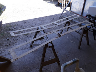

    First job this morning was to make all the patterns for the plywood decking out of 3 mm plywood and then mark off the edges of the cabin side and the hull edge
    All the patterns made and now ready to cut the plywood out to make the deck panels
    Marking out the deck panels
    Cut roughly to size with a small amount of trimming to be done to make them fit the edges of the coaming and cabin sides and the top of the transom
    One side deck cut and just needs cutting at the ends to fit the other piece of plywood and by over a deck beam as well
    Just one more panel to make for the port side deck and then on to the foredeck panel

    Then take out the pieces over the beams
