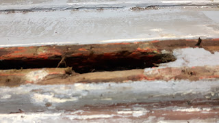

    Default Re: Summer work down at the boatyard and in the workshop
    A part of the deck which as de-laminated as the plywood used was not the correct grade of plywood for the use it was being used for.
    A section of rubbing strake that needs renewing and a piece further along on the same side. The best course of action in this job, is to renew the whole length to keep its strength and when sheathing the deck, It will ensure the sheathing is held in position by a single piece of rubbing strake.
    A small repair needed to the edge of the plank.
