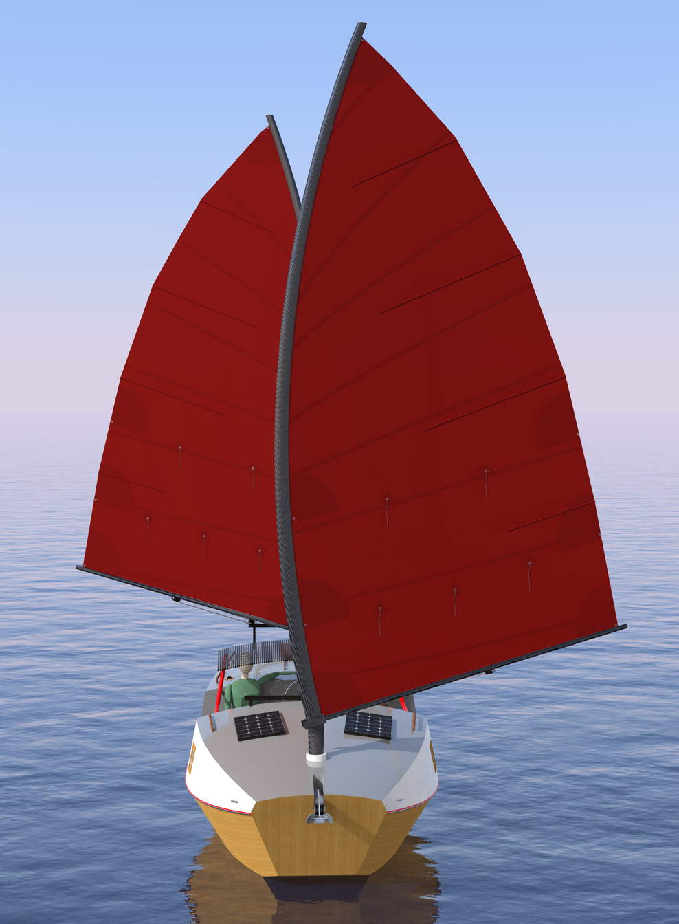

    Default Re: Birdwing mast design to benefit from new sail track composite material
    Quote Originally Posted by Chris249 View Post
    Thanks for the reply. From experience with other masts with pre-bend and balance and the geometry, points 1 and 2 would exist but seem to be pretty minimal. 4 and 5 for sure - it's pretty and convenient. But there's still no evidence that what is "painfully obvious" to you about the aerodynamic advantages, and of course that means that there is no way of assessing whether the downsides of a mast with larger chord (such as poor gust response) are compensated for.
    Nobody knows how good a freestanding, self-rotating, efficiently shaped, sickle shaped mast with a perfect taper can become when its shape is computer optimized and with state-of-the-art materials and techniques applied in its construction. The question should not be why research such a shape. The question should be “why not?”
    Isn’t “not knowing” the reason we have research? In this day and age with the tools we have available to analyze aerodynamic shape, performance characteristics and construction techniques, why not explore the sickle shape for its uniquely balanced ability to set sail in a new and different way along a totally curved surface?
    I’ve built six prototypes of the birdwing mast design. It took Thomas Edison a hundred prototypes before he stumbled upon tungsten as a practical filament for his electric light bulb. You want to reach your conclusions about the birdwing mast design after only six prototypes? And with exactly zero amount of actual scientific research??? I surely do not. I want a hundred prototypes as well! I want computer aerodynamic analysis to find its optimal shape. I want the latest carbon fiber construction techniques applied to the design. I want it to be strong where it needs to be and lighter where it can be. I want to explore how “blade-like” a birdwing mast can become in carbon fiber and therefore how aerodynamically slick it can become. I want to find the absolute best way to attach sail to a birdwing mast. I want to find the absolute best cut of sail for the ultimate birdwing rig. My question is “just how good can it get?”
    Consider granting this old man a little more slack in his new role as inventor. Try to be a little more optimistic. What’s painfully obvious to me may actually be true. That wouldn’t be so terrible, would it?
    And rest assured that some excellent riggers will find all kinds of ways to tweak every last ounce of performance out of birdwing masts for a variety of sailing conditions. There still could be plenty of control lines left to tension or ease for constant racing enjoyment, if that’s your thing.

    I have been a long-term critic of this entire concept from the get-go, my main concern being why you imagine anyone ought to bother to add so much money, complexity, weight, and time to a mast build that has yet to demonstrate any actual performance or handling advantages over well-proven, conventional masts. I also think the theory behind it is misguided, constantly stressing reduced drag, auto-rotating, and aerodynamic "slickness" instead of focusing on increasing lift, like every other modern sail/mast. What you propose to be "incredibly obvious" about reduced aerodynamic drag might actually be a red herring, and actually completely irrelevant to the more pertinent issue of lift, assuming it actually exists as a real problem at all.
    Certainly, the super high-lift wings of specialized soaring birds like condors and vultures don't look anything like your sickle-shaped mast thingies, though it sure does bear a resemblance to the profile and aspect-ratio of some of those modern sail boats of late... even down to the squared-off tips.
    The fact that you managed to sucker a state university into squandering $16,000 of limited funds on the wild goose chase of getting a patent first instead of actually doing some scientific research just makes me mad. You should have spent the $4,000 first, and then decided whether you actually had a case worth pursuing. I think your patent rush was an act of pure vanity.

    Hey James, how are you doing buddy? I love this new game you've come up with where you show a couple of slow buzzards with a straight leading edge to their wings and I show five photos of birds presenting pronounced curvature of their wings during flight. If you own a book on birds and you actually looked at it, you would find that the great majority of photos of birds in flight do show curvature in the leading edge of their wings. For every two you can find with a straight leading edge to their wing, I can easily show you five birds demonstrating a curved edge to their wing profile while in flight. In a survey of all flying bird photographs, I'm afraid, my friend, that the cards are very much stacked in my favor.
    The time will come when my design is aerodynamically computer-optimized and built with state-of-the-art carbon fiber techniques and you will no longer be able to call my masts heavy. What in the world will you do then? If only sailing were only about generating lift, it would be wonderfully simple and people like me who want to experiment with curved surfaces in the airflow would probably just give up and watch reality TV shows for the rest of their lives. I am extremely lucky to have a patent on a design which features all curved surfaces in the airflow and it's only straight part can be out of the airflow while still providing increased automatic windvane function. As you know it was originally designed just for better storage in the boat but silly me, I thought it might offer some aerodynamic advantages as well so in recent years my attention has turned toward that facet of the design in spite of your best efforts to prove I'm wasting my time.
    But by far the most amazing fact that easily sails right by you is that prototypes by nature are imperfect. They many times only point to a design direction worth exploring. Do you think that all nuclear fusion scientists should just give up (because that certainly isn't working for them)? My junior college physics professor was my personal physics tudor for a full trimester because everyone else in the first trimester of his class (advanced physics with calculus) had either failed the course or their green card had run out and the guy had to return to Iran. It's a matter of public record of St. Johns River Junior College if you would like to check that out. My physics professor was Phillip Johansen (sp?) and he was actually working on nuclear fusion as a post-doc at the University of Florida. One day he took me over to U of F to show me his lab set up. It was very impressive but of course didn't work worth a damn. I'll never forget that on the ride back to the junior college (we were in his Corvette) we were talkng about his experiment and he turned to me and said, "If you ever see an extremely bright flash of white light coming from Gainesville, you'll know I succeeded." We both laughed.

    interesting Ken, is your mast and sail combo specifically designed to emulate seabird wings? because James does make an excellent point about some soaring bird wings... I wonder if the humidity or air pressure at sea level makes this pointed wing more efficient for sea birds and hence sea going sailboats? seems like speculation with out some hard wind tunnel numbers it back it up though.
    Daniel, I think the problem here is that you are limiting the birdwing mast definition to only low aspect rigs whereas to my eye the profile of one of those wings of that bird in your example would make a perfect profile for a very high efficient high-aspect sail. See how the leading edge lunges forward before it sweeps back? It's exactly the same shape a very high aspect birdwing mast would make. Granted it subtle in the case of this bird but it is definitely there nonetheless. If you think that the leading edge of this bird's wing is a straight line then you need to put a straight edge on it. If you still think that the leading edge of wing is straight then you probably need a better straight edge.
    The birdwing mast is defined as being sickle-shaped and utilizing an efficient aerodynamic cross section along its curved part in the air flow. There is nothing in the patent to limit the design in regard to its aspect ratio.

    Ok I think I'm understanding wht your going for, a sail that "lunges forward" more like these wing shaped windsurfing sails... but for a traditional rig?

    Well Kenjamin, here's where I think you definitely need to examine some of your basic principles in your theory, make sure you're not going down a rabbit hole of crank-dom. Are the curvy parts of some of those bird wings a necessary part of the structure with some specific aerodynamic value? Or are they an artifact of a jointed organic structure that folds? When looking at a picture of a bird wing in flight, is it generating maximum lift, or is it partially folded back, "reefed" as it were, for some sort of in-flight maneuver? Are the dual purpose wings of seabirds that must spend much of their life carefully tucked tightly against the body of a bird to prevent injury while at swimming or at rest any different in shape or structure than the wings of terrestrial birds like buzzards, kites and condors that spend the majority of its life aloft and soaring? Which parts of which kind of wing are for which purpose?
    How does lift work? What sort of shapes generate lift most efficiently, and at what speed regimes?
    You do know that many, many millions of dollars have been spent investigating this question already, right? It's not like this data is a secret. Efficient airfoil shapes and the aerodynamics of drag and lift are pretty well understood, especially when it comes to vehicles where it really matters that you make every square cm and every gram count. You could bother to do even a tiny amount of study, if y"wanted.
    I think if if you had left it at
    1. my grumpy, non-sailor fishing buddy was always bitching about mast in the way
    2. it looks purty t'me
    I would have no problems whatsoever with all of this. But it's all the post hoc rationalizations on top of such a shaky grasp of theory that aggravates me. Do some homework, Comrade.

    What the birdwing mast design brings to the table of modern mast design is better balance. Not just the idea of balanced sail presentation but also the means for the mast to rotate in a balanced fashion while it is presenting that balanced sail area. Itís the little straight part at the bottom of the mast IN COMBINATION WITH the aerodynamically efficient curved part in the airflow that makes it unique and evidently worthy of being United States patent #8,739,720. What is done with the design and how efficient it can get remains a mystery. Rendering the perfect birdwing mast design in that wonderful stuff we call carbon fiber is well beyond the scope of my talents, knowledge and financial means. I freely admit that. But my spruce machining has gotten better over the years and Iíve become more adventuresome in pushing the limits of laminated spruce. So even though progress with the development of the design has been ridiculously slow, it doesnít mean that progress has not been made.
    Chris, you seem to want me to apologize for being smart. Iím not going to do it. How stupid would that be? I will also not apologize for operating within the realm of my own experience, knowledge, talents and financial means. It's what every human being does or tries to do. Why should I apologize for that? I freely admit that if it werenít for the necessity of dealing with my loud-mouthed fishing buddy (complaining about the old straight mast), I never would have thought of it. If I hadnít built them and sailed them for the last ten years, I wouldnít have the understanding of the design that I have today. The only smart thing that I included in the original design was its ability to rotate in a balanced manner. Itís that little straight section at the bottom of the mast allowing it to rotate in a balanced fashion that makes all the difference to the design and to the U.S. patent office. IT ADDS NEW FUNCTION!!!!
    I also freely admit that the building of the ultimate birdwing mast is not going to be easy. Without the very latest advances in 3D computer printing, it would be near impossible to get the taper correct when built in carbon fiber in my opinion. I am smart enough to know that I canít do that by myself. I am just an old retired graphics guy who happened to have a good idea ten years ago in the quiet of his garage while staring at the gunwale of his homemade skiff. Why not just glue up a mast that conforms to the gunwale of the boat and maybe Iíll try a little straight section at the bottom of the mast so the whole thing can rotate in the mast step. That was all there was to it. Never meant to offend anyone. Never wanted to piss anyone off. Never wanted to redo any aerodynamic efficiency calculations. Just wanted my fishing buddy of twenty-five years to stop complaining about the straight mast being in his way.
    So I was driven to the design by a foul-mouthed, beer guzzling, loud, obnoxious fishing buddy but once the design was realized, WHY NOT make the cross sections aerodynamically efficient? WHY NOT experiment with different amounts of curvature? WHY NOT investigate building the thing in carbon fiber? These are my questions that I want answered and Iím either going to get those answers or die trying.

    Rendering by JF Bedard Yacht Design:

    I think the difference in the discussion here is that it seems you claim the design is MORE aerodynamically efficient than ALL OTHER mast designs and will SAIL better (faster), but then don't have demonstrated proof for it. You clearly THINK and EXPERIENCE it as sailing faster, but any careful investor would ask for independent data to back up that specific claim within the first few minutes of looking into it. A patent doesn't require that something be a better solution, just different according to specific criteria.
    The other features of the design which contribute to ease of use may be appealing or interesting, and even desirable for some (which can be considered 'better' by whoever is interested) but are peripheral to your primary claim.
    The design can stand on it's own as useful, appealing and interesting without making claims for unproven characteristics.
