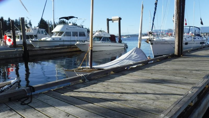

    Interesting to see so much interest in small cabins; my own experiences have led me to favor open boats, though I used to think I wanted a tiny cabin.
    So, what comforts do I need to spend a month aboard?
    1. A reliable way to sleep at anchor, including a simple tarp/tent and platform arrangement to keep me out of the bilge water. I don't need anything fancy, but maybe a step up from what I used on a 40-day Canadian cruise a couple years ago:
    Quote Originally Posted by WI-Tom View Post
    This was a VERY improvised approach to a boat tent, using just an 8' x 10' backpacking tarp, but it worked far better than expected, despite being a bit saggy:
    and wide open at the bow:
    It gave me me good sitting headroom and kept me dry in heavy rains.
    2. Dry storage for gear and clothes--I prefer large dry bags lashed in the cockpit. Not only is this much more convenient because you can carry the bags ashore rather than digging through small compartments, it also limits the potential volume of water aboard in a capsize. So dedicated bag tie-downs and a cockpit layout to accommodate them without getting in the way.
    3. Cooking--I rely on thermos cooking a lot. Boil water in a JetBoil stove, put it and the ingredients in a Thermos jar, and your meal cooks itself (and keeps itself warm) and you use almost no stove fuel at all. No ice or electronics, please. Backpacking style food with as much fresh as possible (apples keep well, as do sweet potatoes (slice thin and eat raw).
    4. Water filter; simple backpacker model. I cruise mostly on fresh water (Lake Huron, Lake Superior) so no need to carry water.
    5. Sleeping bag and closed-cell foam insulation pad. No inflatables for me after having 2 spring leaks at inopportune moments.
    6. Large Ziploc bags to keep charts handy and (mostly) dry.
    7. Toilet--I'm fine with the bucket/wag bag approach. Usually where I cruise you can get ashore to handle this.
    8. Head net for mosquitoes. Much simpler and a bit cheaper than trying to arrange mosquito netting under the boom tent.
    9. At least one comfy seat with a backrest--this could be the sternsheets, or simply a cushion leaned against the centerboard case. Whatever. Just want to be able to kick back and listen to the loons and owls while I eat my red beans and rice from my Thermos.
    I think that's about it. There are advantages to keeping things on the minimal side.

    John,
    My Fire-Drake (see Tim Yeadon's video in post #15) has numbers pretty much as you specified in the first post, with a couple of exceptions. The width of the sole alongside the centreboard case for sleeping is only about 460 mm, which is enough for my hips and legs, but mitigating that, for 600 mm aft of the end of the CB case, where my head and shoulders reside when sleeping, the width is 800 mm. The length of the sleeping area is 2160. I have 290 mm between thwart and sole but my height of oarlock pad above the thwart is the same at 200.
    For sitting aft when the tent is up, I have about 1050 mm clearance from sole to tent, which gives me about 250 mm headroom while sitting. This gives enough space for lounging, reading and cooking on my one-burner stove. The rest of the tent forward is lower, as you can see, which reduces windage while at anchor, which I believe is important. I don't have angled backrests but do carry a folding camp seat (no legs) for sitting while at anchor. All my gear is stowed in dry bags and then in the water-tight / flotation compartments in the ends of the boat.
    Tim's boat has pretty much the same set-up:
    [IMG][/IMG]
    This setup worked just fine for for us for 5 weeks last summer and would probably be OK for longer, especially if you pull up on the beach every once in a while to stretch your legs.
    Alex
