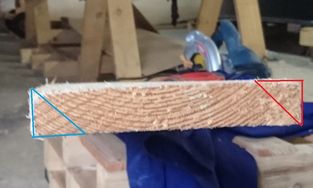

    Please help with some more advice: which orientation of the growth rings would be better for cutting spruce stringers?
    (Perhaps stringer is not the correct term, as it would not be used mid-panel but only in square corners. Chine-log, perhaps?)
    It will be used with glue as the primary structural adhesion, not screws - in case it makes any difference.
    I was hoping someone more knowlegable in English boat building terminology would say something here, but here are my thoughts...
    (I'm assuming the longer part of the triangles is the surface facing other pieces of wood)
    If you were to screw the pieces on, the blue one may be best since there is less risk of splitting it. There may also be less movement in the base of blue, but I'm not entirely sure about that.
    That's about it about why you would.
    The growth rings tend to "want to" straighten out when the wood is dried, so you may end up with gaps on the sides of the strip if chosing blue. (This is why a board like this tend to cup, as is almost seem in the picture.)
    Another thing is that the top of the pyramid, if you like, is more easily broken off if you go for blue.
    If you want to seal it all up in epoxy or something similar, this may not matter at all, and I seriously don't think it matters anyways since the pieces are so thin.
    /Mats

    Thanks for the reply Mats,
    It is actually the short faces that glue onto the plywood where two panels meet at 90deg.
    The wood strips will act as replacement for epoxy fillet where access is impossible or limited. (such as closing off a sealed buoyancy chamber).
    If splitting along the growth rings will be a factor then the blue orientation makes more sense. Any flex in the panels will tend to open or close the 90deg corner, loading the long face in either tension or compression.

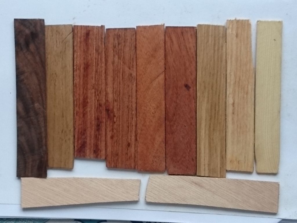

    Some lumber samples for trim and structure. All dressed with some Danish oil to get an idea of finish under epoxy.
    From L to R:
    Walnut (ain't that purdy!)
    Walnut (two feet further down the same plank)
    Teak (with teak oil)
    Teak
    Mahogany
    Same mahogany
    Either Ash or Oak (help!)
    Ditto...(it will be the other one)
    Spruce
    Bottom - ply samples, teak oil left, danish oil right.
    Functionally, I can't see the orientation here mattering one way or the other. Grain run out would be the bigger concern.
    Quote Originally Posted by whiskeyfox View Post
    Decks stitched on to square things up front.
    The nose-job begins:
    From L to R:
    Teak
    Mahogany
    Same mahogany
    Spruce
    personally I'd go with the mahagony.

    I was eventually able to distinguish between the oak (3rd from right) and ash (2nd from right) , only because I found the invoice and because the planks were of different lengths.
    The teak now has me curious as to its specific species.
    I weighed all the lumber samples to work out densities, and the teak clocked in at an SG of 0.95 (60lb/cu-ft). That is way heavier than Afromosia (African Teak) or Burmese Teak.
    The only other teak that heavy I could find on the wood-database website is Rhodesian Teak.
    If indeed it is Rhodesian Teak and the website has accurate wood properties, I sit with something with unusual hardness, even harder than Greenheart and nearly three times harder than Burmese Teak.
    Hardness to weight ratio is right up there with Lignum Vitae.
    Does it have any specific application in traditional boat building?
    I would appreciate help in identification. Will post close-up photos later of grain if it helps.

    Ash is a good timber for rub rails, being much lighter than oak. It does need to be well protected and any damage cleaned up as it will go black if left. My personal opinion on teak is that it is best used on traditional built carvel boats or old school strip plank......if you can afford it. It does make a good deck, but so does plywood and glass.

    I have also seen lots of reference to ash for use on the bruising ends and extremeties.
    The oak and ash planks I have both have the same density, SG of 0.71.
    I know that (normal?) teak is a desirable for decks for its resistance to the elements and good grip. The stuff I've got is clearly not the same. I doubt anyone will use it for extensive surfaces due to its weight. Unless you are building an icebreaker.
    It is also cheaper than any of the other timber species I bought.
    I will have to find a way to test and compare hardness. It might be an unusual contender for foil leading edges, bearing surfaces in dagger-/centerboard cases and cap strips where stainless steel would normally be used. Not on this boat necessarily.
    B.t.w, what are belaying pins normally made of?
