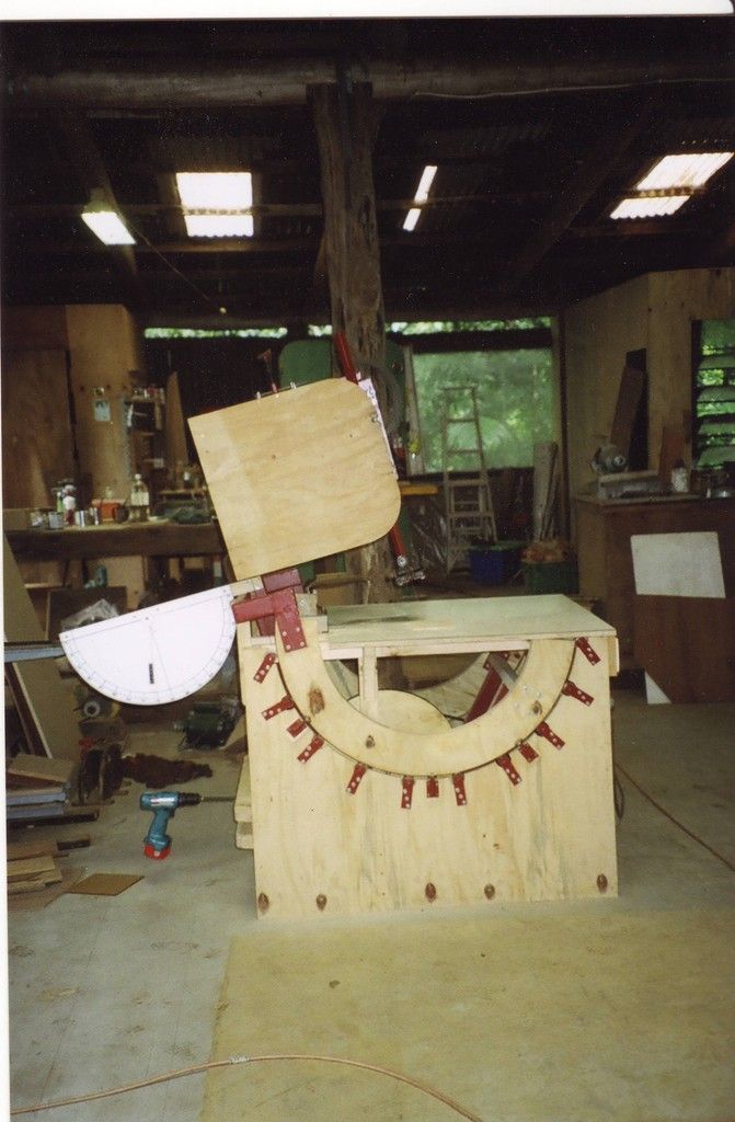

    My homemade ship saw.

    That ship saw looks excellent! Any details on the build?

    I was building a heavy sawn frame boat at the time and needed something to saw rolling bevels. The saw itself is just a home built 20'' bandsaw mounted to the top "C" section of ply (doubled 3/4''), that C section moves on a series of ball bearings .I should mention that the surface the bearings roll on has a strip of 1 1/2'' x 1/8'' steel screwed on. The center of the C is the intersection of the blade and the table.
    The saw is adjusted with a 1/2'' threaded rod, one end captured but free to spin on the moving section, turning through pivoting long nut. A battery drill turns the rod and thus adjusts the blade angle. The blade angle is visible to the operator on the protractor to the lefy, it has a lead weighted pointer.
    Edited to add, the saw tilts from 45 degrees to the right and about 15 degrees to he left.
    Were I doing it again I'd use a second hand 14'' bandsaw instead of building one.

    Really liked you ship saw build. Any chance of pictures from other view points?
    I'm heavily leaning toward Stumpy Nub's 24 in., 3 wheeled design for the size of parts that can be sawed and the relatively small size of the machine.
