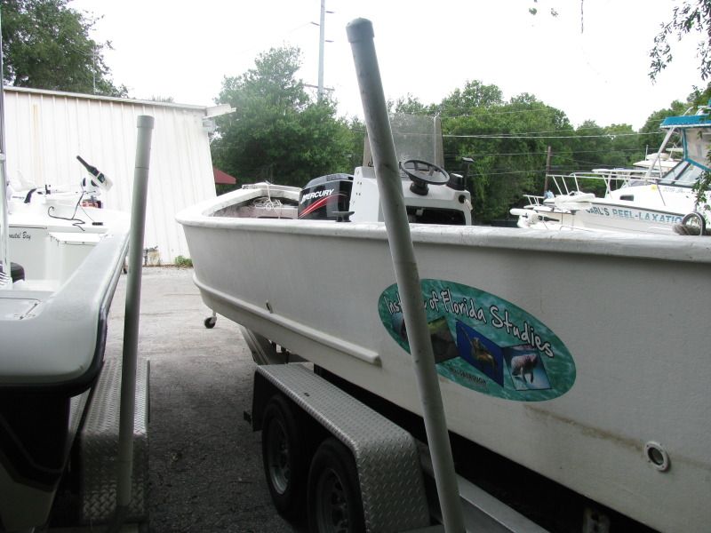

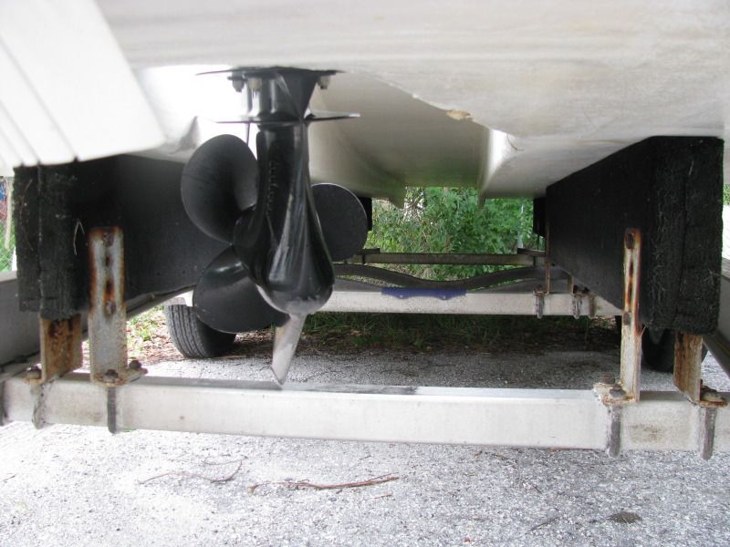

    Here is some photos I took of a mullet boat I worked on. They are referred to as Tremblay skiffs. It shows the bottom tunnel and such, although I did not take photos that really show how to build it, or for that reference, really. They were typically covered with Chopped Strand Mat and polyester resin, and then painted with Benjamin Moore, oil based house paint. This one was converted to a marine research (hence the center console) vessel after the net ban pretty much made these boats extinct.

    Two reasons come to mind. One because they let out hundreds of yards of gill net over the stern, and with the weight of the net essentially steering the stern of the boat, the forward motor helps to even things out. Sometimes these boats operated in a foot of water, where fish would be holed up on or behind shallow flats and bars.
    Some of these skiffs had motor boards that would allow the operator to jack the motor above the bottom of the hull so they could push pole and work the school into the nets, and would allow them into just a few inches of water.
    They handle and steer differently for sure, and for lack of a better explanation, drives and steers just like it appears that it would from there.
