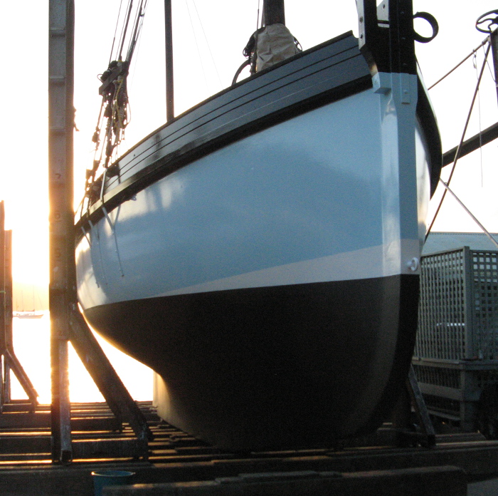

    I'm going to state clearly from the outset that I'm unfussy when it comes to the finish on my own boats. I like them a bit rough, a bit workboat. Wholesale cutting in and a thorough but quick prep job are my style.
    Right, that said. I'm sharing my recent use of a new (to me at least) water based enamel.
    I'm hypersensitive to solvents and toxins so have been trying pretty much every water based alternative as they come available. This time around it's been way too long between slippings for the good ship 'Blink', so there were a few potentials.
    Taubman's Ultimate Alkyd Enamel is what I've used on the topsides and bulwarks. I have to say, in my experience it's the first time a water based paint has given a finish that has an honest element of the oil based enamel that we all know so well. Actually it comes pretty damn close.
    http://www.taubmans.com.au/paints/ultimate-alkyd-enamel
    If you're looking for a direct replacement, a paint that comes off the brush in the same way, that dries to the same timetable and has exactly the same look, then this isn't it.
    If you're cool to learn the behavior of this new paint, to experiment and explore it's similarities and differences, then I think it's worth your time to give this stuff a go. I'm certainly happy so far!
    Details:
    - I did a two month test on a 1 meter length of bulwark. No issues whatsoever after 2 months. That was good enough for me to go ahead and do the whole boat. A long term durability call will have to come with time.
    - I prepped solidly and spot primed with the recommended '3 in 1' primer, wiped down with a damp rag, let dry and went with it.
    - Weather for painting was a challenging 30 degrees and full sun, moderate breeze.
    - The bulwarks are brushed, two coats.
    - The hull is rolled, one coat. not tipped off.

    So it actually levels before skinning off Mikey ?

    It's different Peter, I'm certainly still experimenting. It doesn't skin in the same way and stays workable for way longer if you apply it thicker than for oil. It then lays down nicely as it dries.
    At $33 bucks a 1L tin have a play with it on some architraves or something...

    Have you tried feather sanding it Mikey ? The problem I have with acrylic is repair, I never seem to be able to sand it down to a feather edge to repair a ding .... and I assure you my painting is rough, rough like a carpenter painting.

    Peter: Once dry, it sands and feathers just like oil enamel.

    That looks a bit bloody fancy I reckon.

    When I had my tri, I painted the cabin sides with Dulux Aquanamel. It was hardwearing and didnt seem to go chalky as quickly as oil based enamels. That was a few years ago now, and I think waterborne finishes are an area of paint technology that has advanced a lot in recent years.
    The OP's boat in the pic certainly looks good!

    18 Month check in on this paint. Looks good to me.
    Same paint on the samson posts too and it is holding up in this high abrasion spot admirably. Also no little checks or paint splits on the upward facing endgrain, which there always has been previously using regular oil enamel.
    ps, Topsides here have been subjected to 500+ dinghy arrivals and departures in all weather.
