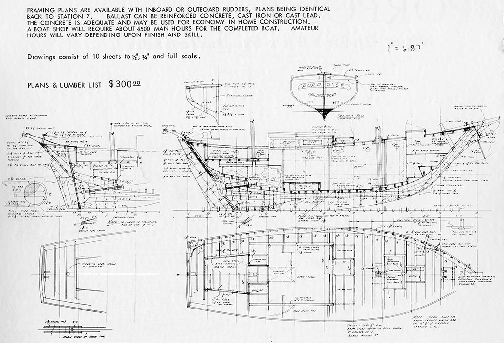

    Quality will vary a lot, in the 1960's anyone with $300 could get a set of Porpoise plans and build a boat. A bunch were built here locally of softwood, there's usually a handful of them for sale.
    From the Garden Catalog.....

    Default Re: William Garden Porpoise Ketch
    That's splitting a pretty fine hair on the definition of "inboard rudder".
    Quote Originally Posted by Figment View Post
    More properly it was, "inboard rudder stock". Which created the opportunity to use a worm steerer with a wheel. I'd rather have the outboard rudder and tiller.
