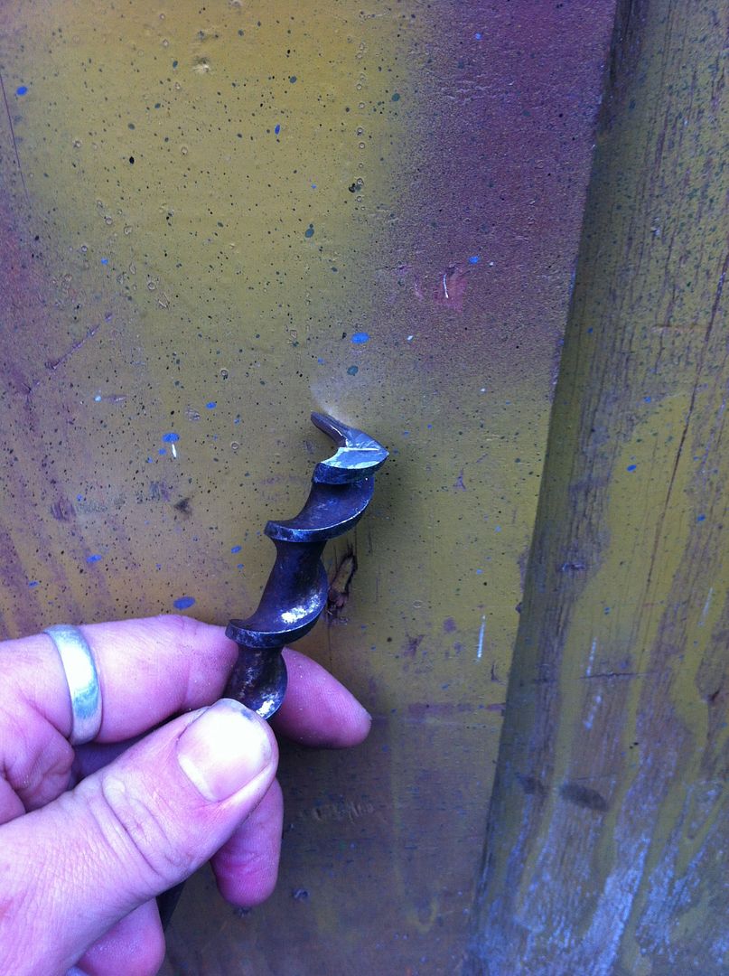

    Today at lunch I was drilling the last hole to connect stem to knee and the lead screw on the bit stripped out the hole it was in about two inches shy of breaking through. I don't know if you are familiar using a bit and brace, when the lead screw strips out it can be a real bear to be going again because the scoring spurs on the side keep the cutter from engaging without the downward pull of the lead screw. After struggling with it for about a half an hour I decided to try something different. Digging through my bit collection, I found another number 10 bit and gave it a hair cut with the bench grinder and a file.
    Now I have a 5\8" barefoot auger.
    That worked good and got me back on track.

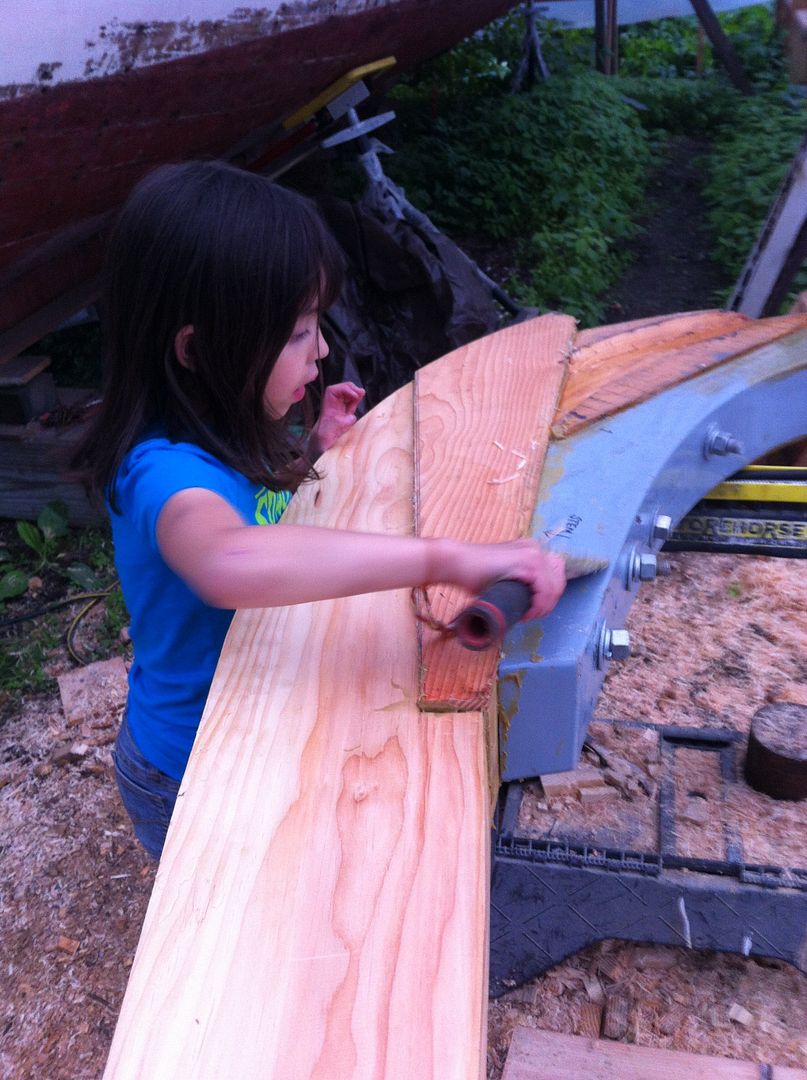

    After I finished tightening up the last bolt, I was cleaning up some squeezed out Dolphinite and one of my assistants showed up.
    Assistant: What are you doing?
    Me: Cleaning up some extra bedding compound.
    Assistant: What's bedding compound?
    Me: It's a sticky substance you put between big pieces of wood to help keep the water out.
    Assistant: Oh, can I help?
    Me: Sure.
    Thirty seconds later other assistant shows up and says to first assistant, "hey, do you want to play, ride bikes, swing, pick berries, do whatever?"
    Assistant to her sister: Sure!
    To me: Gotta go, bye!
    And boatbuilding with dad is done for the day.

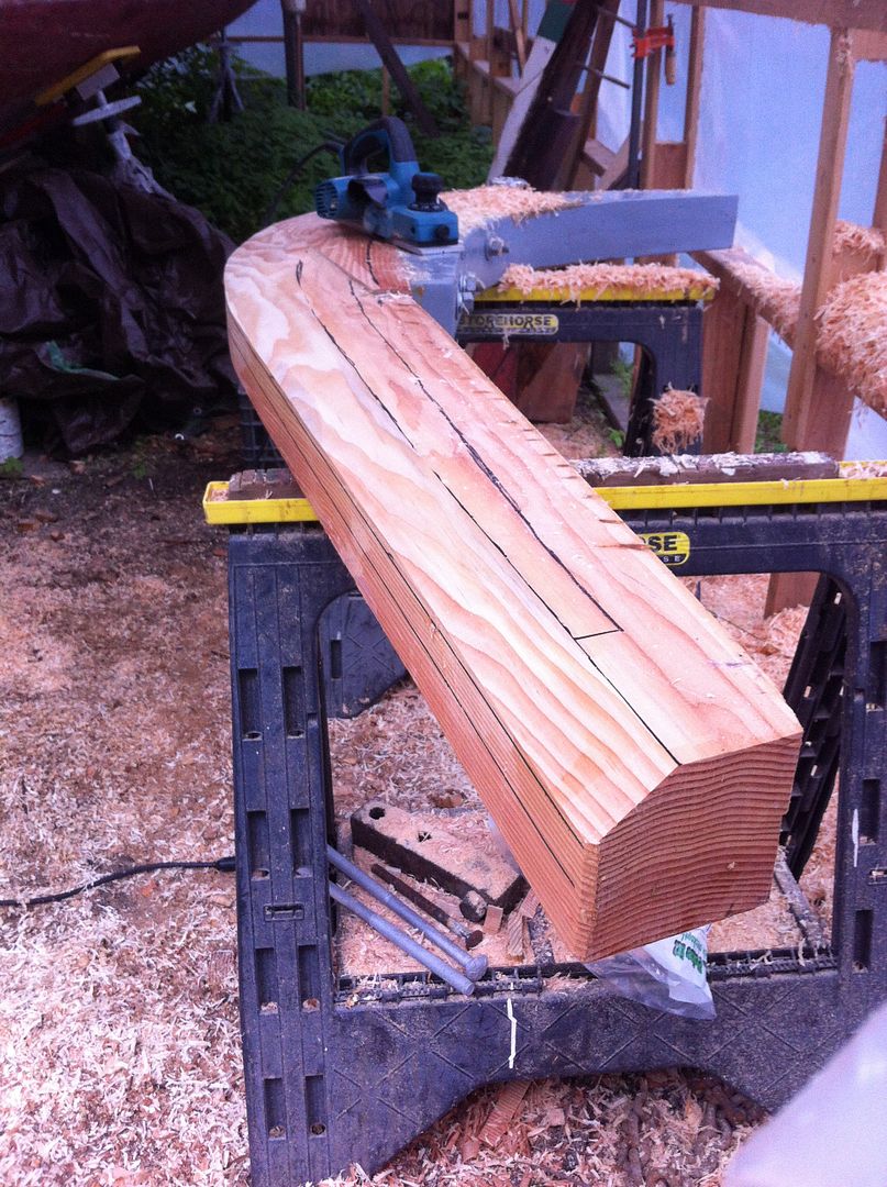

    Yesterday saw a big leap forward on the rabbet.
    Lots of chisel work but the upper stem was straight enough to make good use of my old rabbet plane.
    Which got us to here.
    There is some adjustment needed but it doesn't look too terrible. The corner got knocked off the other side too.
    It's getting lighter.

    Well, I've been trying to get back into the swing of things after having a week off. I spent some time trying to line up the rabbet with the planking to make sure I've got it right since the old stem was only somewhat useful as a pattern. It's pretty close now.
    Finished up the rabbet after deciding it was in the right place after all and turn some yellow cedar for stop waters.
    First one drilled.
    Then pound them in and trim them off.
    I think I'm just about ready to bolt the stem back on to the keel.
