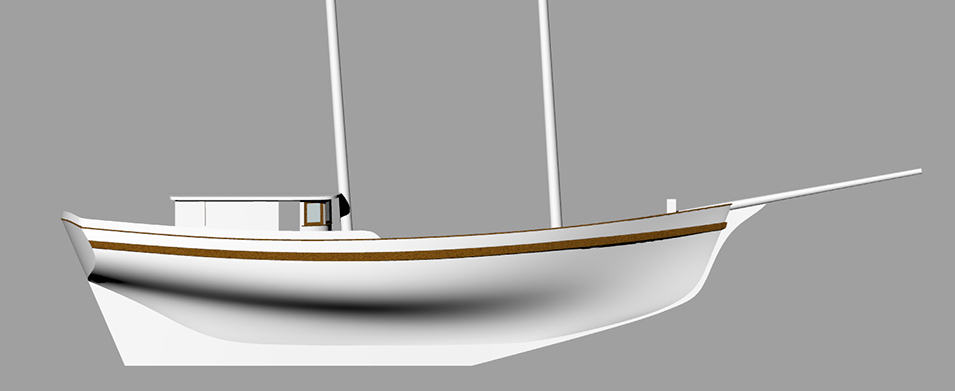

    I'm afraid I'll bring considerable pessimism to this discussion.
    Tom Colvin is certainly the father of small craft commercial operations under sail/auxiliary power. He has written an interesting chapter on the subject in Steel Boatbuilding (Volume 2). All his books are worth having if you are interested in the subject of commercial (non-yacht) sail.
    I know of only one local freight/passenger ship that steadily makes enough to stay in business....these guys.... http://www.marinelinktours.com/index.html No sails in sight.
    Just as in the past when Slocum not only sailed Aquidneck, he bought and sold (profit or loss) her cargoes as well. The modern cargo skipper must also combine those skills, sailor and salesman, I have a feeling it's a rare combination.
    Something like the Metacomet is possible if you buy an existing vessel.... http://sailingtexas.com/201101/sgloucester75100.html
    Every week I have people inquiring about building a big charter/freight/fishing schooner. Invariably they know nothing about building boats or commercial marine operations. They have only two questions. 1) "How much will it cost to build your xxxx design?" and 2) "Can I make a living carrying freight in Vanuatu?" I've developed longer stock replies but my general answer is 1) As much as you have, and 2) I have no idea. I never hear back from these people, which I regret. I also hear from groups doing things like hauling vegetables under sail (Puget Sound) or contemplating building a big schooner to operate along the west coast (California - Washington). These folks have a bit more knowledge but invariable come up short of money for new building. And as they necessarily operate with higher profile, their projected costs are far higher. The Hudson River Freight scow project of last year was certainly a positive development, but with (one year) insurance costs surpassing the initial build cost, financially not viable. They also learned something about the real problem of sails and schedules....incompatible.... thus the outboard was used a lot.
    Despite all the pessimism I'm currently working on a big freight schooner for a family member. She is wooden and of the simplest construction possible, given the required appearance. Double-sawn frame, inside ballast, trunel fastened, clear flush deck with no breaks, 56' on deck by 16'8" beam and draft around 6'0". She'll carry a Wharram style lashed on outboard rudder, Wizbang (Caribbean) type shroud posts (rather than chainplates), and softeye rigging rather than mast irons. We're minimizing the metal work and thus the stuff that must be purchased, there will be some galvanized bolts and drifts, but as few as possible. The rabbet won't be quite as shown in the profile, it will come to a point aft down low. And there may be a cut-out in the deadwood for a propeller, unless I can convince him to go with the prop shaft offset out one quarter.
    The windows and pilothouse door are not yet complete. The deckhouse is about 4' high so you can stand aft and look over it. The deck line follows the upper edge of the whale strake.

    I try not to turn anybody away, but I'm not going to tell them they can build a 60' schooner for a song and make a fortune in la-la land. I really do not believe that is possible. When they ask about cost and I tell them they need 42,000 pounds of steel at $1.25 lb, and $25k in paint, and $10k in insulation, and an engine and steering gear and a rig and sails and 5000 hours of free time.......they never do ask about actually buying plans. Producing a book on the subject might be far more profitable......
    I think (as I mentioned above) it takes a very specialized set of skills to a) build a relatively big wooden schooner for small money, b) successfully sail this vessel wherever the cargo takes you, c) buy and sell said cargo with the occasional profit. Only a few people have the required skills, Capt Z has already demonstrated he has them. But it's still a big undertaking, and older means wiser as well. When you are young taking on a 10-15 year project is not a problem, but for us old guys time is a bit more finite. Thus I would go smaller, perhaps 40-45' on deck. Or buy an existing vessel and modify to suit. Every foot shorter she is, it's one less deck beam and frame set you need to build. The cargo hold can be living space in the off season, or it can be workshop space, or passenger cabins as required. A key is versatility, which to me means adequate power to get up a river or through tidal rapids, and moderate draft. I argued long and hard that the 56' design above should have a flat bottom and a big centerboard so she could dry out......but the owner/builder wanted something simpler and (IMO) somewhat limiting.
    Tad, forgive me but I'm going to gush for a second, "YOU ARE THE MAN, YOUR INCREDIBLE, I BOW DOWN TO YOUR AWESOMENESS" I knew you were going to bring something really good to the table. And you did!! there I said it, I got that out of the way, I can now converse like a sane human being...... If you remember at the beginning of this thread I wrote that becuase I was having to start over, I was making a list of all the "if only"s that accorded during my build and apply them to my new build. Well it feels like you found a copy of my list and decided to see how much you could incorporate into your design. Below is some of that list now, in no perticular order,
    Longer then my last 50' on deck
    More beam
    Trunel fastened
    Simplified rudder(mine used a system of cables and pulleys that ran halfway around the boat.
    Soft eye rigging
    And then including the changes that I was making to the original such as
    Pilot house
    Flush deck (is it still a flush deck if the aft deck is raised) I got rid of all the dog house and cabin tops.
    Turn buckles replaced with dead eyes
    It really looks like we are talking about the same boat!
    The idea of offsetting the prop shaft is something I had not though of, but as I think about it I can see several advantages. I plan to have a diesel electric system, this way I can put the diesel engine someplace where it is easy to work on and better able to isolate it's noise. If I were to put two off set shafts one port and one starboard, I would have infinite control while docking. Redundant power in the event of damage to a prop, and twice the regen capability. Hhhhmmmm, I'm going to think more about this.
    Now a couple of questions about your design.
    Will she be able to carry topsails for those calm days of two to three knot wind? I have no patience for a boat that depends on the motor for light air days.
    Also I was wondering if she could be rigged to fly a square on the fore mast for my transocean crossings, and down wind sailing?
    Is there room inside the hull for an aft cabin? Kind of like your 60' cargo schooner.
    And finally since I know that you do this for a living, what is the procedure for purchasing these plans when their done, and or working with you to fine tune them for my needs? For example I would like to see a little more rake in the mast.(I realize that something like changing the rake of the mast changes the whole balance of the schooner and I would expect such changes to come at a price for all your hard work.)

    Quote Originally Posted by Capt Zatarra View Post
    We did intend a main topmast (doubled) and a foretop would be fine. Winter time/hurricane season or high latitudes the top masts come down.
    Yes, square sails are the answer for old men sailing big boats short-handed. A big course (probably brailing into the mast) and raffee above would be about right.
    Our intention is a chubby-hole skipper's cabin under the aft deck. In this version the space is tight because there is no break, and no raised aft deck. But a break is entirely possible, creating a much more roomy aft cabin. Our idea is that living goes on in the deckhouse, with helm, navigation, galley and dining space there. The pilothouse floor is about 11' long and 10' wide, plus a big dashboard forward. The aft cabin will just be an athwartships double berth against the transom, and storage space with a companion way up to the pilothouse. The engine room is under the pilothouse with tanks port and starboard. A watertight bulkhead between hold and engine room, with hold access through a hatch in the dash at the forward end of the pilothouse. Then another watertight bulkhead just aft of the foremast dividing off the foc'sl, the head and about six bunks can be up there.
    Contact me off forum, my email is on the website or there's a contact form.
    On sailing balance, that's the reason for building a schooner. Yes you need to follow the general rules, but as compared to a typical triangular sloop with fin, this boat will be far more forgiving and versatile under sail. With 4 lowers, 3 topsails, and a couple of squaresails you have numerous options for getting the boat to balance.
    On the subject of mast rake, I am under the impression that if the mast is raked enough the rigging can be significantly lighter and the forward shroud can be eliminated. As seen on the Baltimore Clippers. Do you concur with this idea?
    I don't think I agree with this thinking. Generally the shrouds are sized to not break if the boat is knocked down, so sizing is based on stability and sail area/mast size/beam. Perhaps as the shrouds move aft (on the deck edge) the boat gets wider and shroud angle increases? I don't think, in this type of boat/rig, that the difference will be significant. The rigging safety factor will just be larger.
    The forward lower shroud will be eliminated so that the square sail can be braced around further. But you will still have 2 or 3 lower shrouds, probably 1/2" galvanized wire. I have nothing against increasing mast rake.
