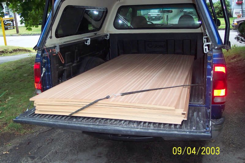

    I've had this pile in my garage since 2003, I got 15 sheets of 3/8" (9mm) Sapele for $30 a sheet.
    It's stacked up next to all the molds and laminated stems for my someday Eun Mara project.
    I've used some of it already, the bottom of the Nutshell Pram and the garboards of the Elf. I think I have 13 sheets left.
    Steven
    $30 seems like it was probably a good deal even in 2003.

    Yes, less than a third of the going rate. I'm friends with the owner of one of the local hardwood stores. I just looked at Boulter's site, 9mm Sapele is going for $170 a sheet. Yikes!
