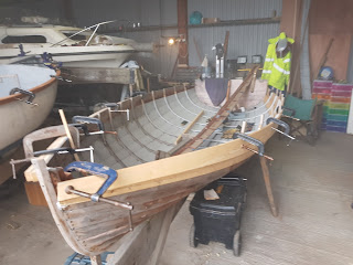

    The top sheer strake back in position ready to start putting the new planking back on the dinghy
    After taking off the broken and split planks, it is now time to start the rebuilding of the side of the dinghy. First put back on the sheer strake plank so there is guide to work to when putting the planks back in position
    First dry fitting of the first of the planks that need renewing
    Got my every faithful bandsaw back up and running and in position to use it to cut long lengths of planking

    Having cut to shape it was time to plane the rebates on the top and bottom edge front and rear before dry fitting the plaqnk
    Steaming the gunwales on the opposite side top plank while working on the replacement plank
    Fitting the new replacement plank using traditional clamps
    final positioning of the plank before nailing and clinching in position

    Starting to fit the second Replacement plank after planning it down to the correct thickness with the thicknesser / Planner
    The Plank getting its first dry fitting after planning on the rebates at each end
    Using a mixture of old fashion peg clamps and modern G Clamps
    The young apprentice watching his father fit a plank so he can help fit the next plank on the dinghy
    The top strake being refitted, so the gunwales can be fitted next and the then the rest of the fitting out can being
    Finally the top strake is nailed into position and the rest of the fitting out can go ahead.
