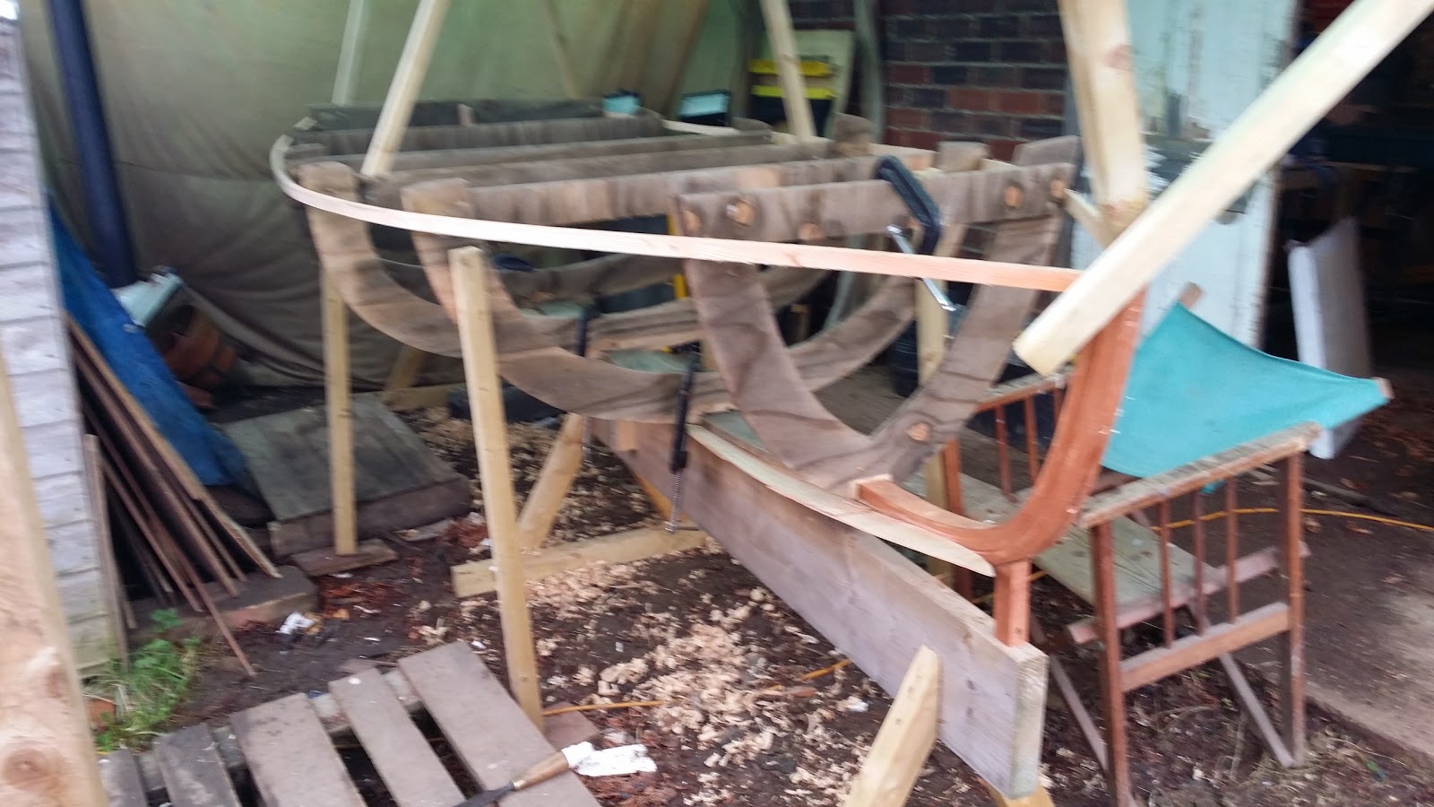

    Building a new class of dinghy for the modern world.
    As other jobs are finishing or being put on hold because of the weather and other reasons, it has given me chance to get on with making a start on the new build.
    Since this photo was taken, I have taken down the moulds and got it back to the base keel on the building stocks
    The next job is to take the keel off the building stocks and turn it over and cut a scarf joint on the front end and fit the stem / apron to the front end and the refit it to the building stocks and then fit the transom once this is made up and cut to shape.

    This photo shows the stem being fitted to the front end of the keel and before the apron is fitted onto the inside edge of the stem and on top of the front end of the keel.
    The keel and stem now back upright and before the apron is fitted.
    T
    This photo shows the apron now fitted
    This photo is a side on view of the front of the keel and stem/apron now fixed in place and the keel rebate being shaped to line up with the stem rebate.
    This photo shows the first two mould stations being fitted to the keel.
    This photo shows all the mould stations in place ready to start building the hull of the new dinghy.

    Now the planks are starting to go on the moulds and its the birth of a new boat.
    This photo shows the spoil board being put in place ready to mark the starboard side garboard plank.
    This photo shows the spoil board being position on the stem and final trimming of the stem to fit the spoil board.
    This photo shows the first garboard plank being cramped in place.
    This photo shows the front end of the garboard plank being placed in the steam box to make it possible to cramp it easier to the stem given the tight angle it has to turn to fit the stem.
    The steamed garboard plank cramped in place on the stem and left to cool down over the weekend before starting to final fit the garboard next week.

    Default Re: Building a new clinker dinghy over the winter months
    Another photo of the final fitting of the garboard planks on to the stem.
    A photo of the curve of the plank has it goes along the boat and over the mould stations from being upright at the stem to laying down along the length of the boat.
    Red lead primer on the edges that fit to the keel rebate and the stem and the transom to ensure it is well protected.
    This photo shows the keel rebate matching up with the transom angle.
    The stem and keel ready to final fixing of the garboard plank after it has been painted with primer.
    This photo is of the starboard side ready to fix the garboard plank.
    This photo shows the secong plank being offer up to mark off and cut to shape.
    This photo show the second plank being bend round the first mould station
