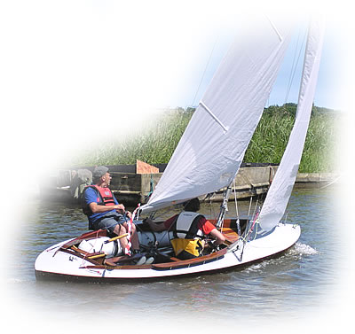

    These planed:
    In fact a chap called Stewart Morris sailed one before moving on to more widely sailed classes.Even before the adoption of a trapeze they had a lower Portsmouth Yardstick than a Flying Dutchman.

    How early do you reckon the punts took on their planing form? I think they started out looking something like a pirogue.

    The Norfolk Punt was always the fastest crewed dinghy, faster than the FD. It was developed on the Norfolk Broads
    http://www.norfolkpunt.org/history/
