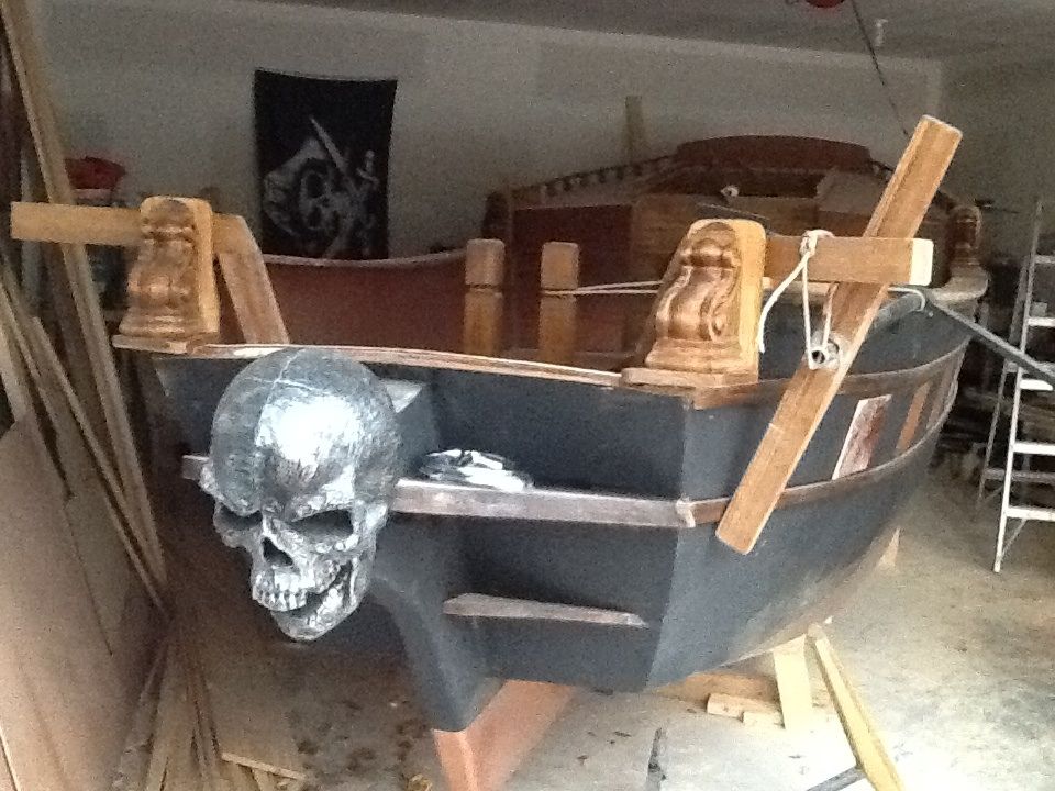

    This is the first real boat we have ever built. We have 4 kids, and always wanted to build a small staysail schooner (with square course on the foremast) for treasure hunts near our cottage. Been working on it for about 14 months now, with an estimated launch date of mid June.
    I will attach a test picture if I can figure out how.....so far no luck.
    http://i1329.photobucket.com/albums/...ps92432f4a.jpg
    http://i1329.photobucket.com/albums/...psac7076f3.jpg
    http://i1329.photobucket.com/albums/...ps532dc3a2.jpg

    Figurehead on bow from early in construction:

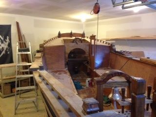

    early internal pic, showing ship's bell (grainy pic):

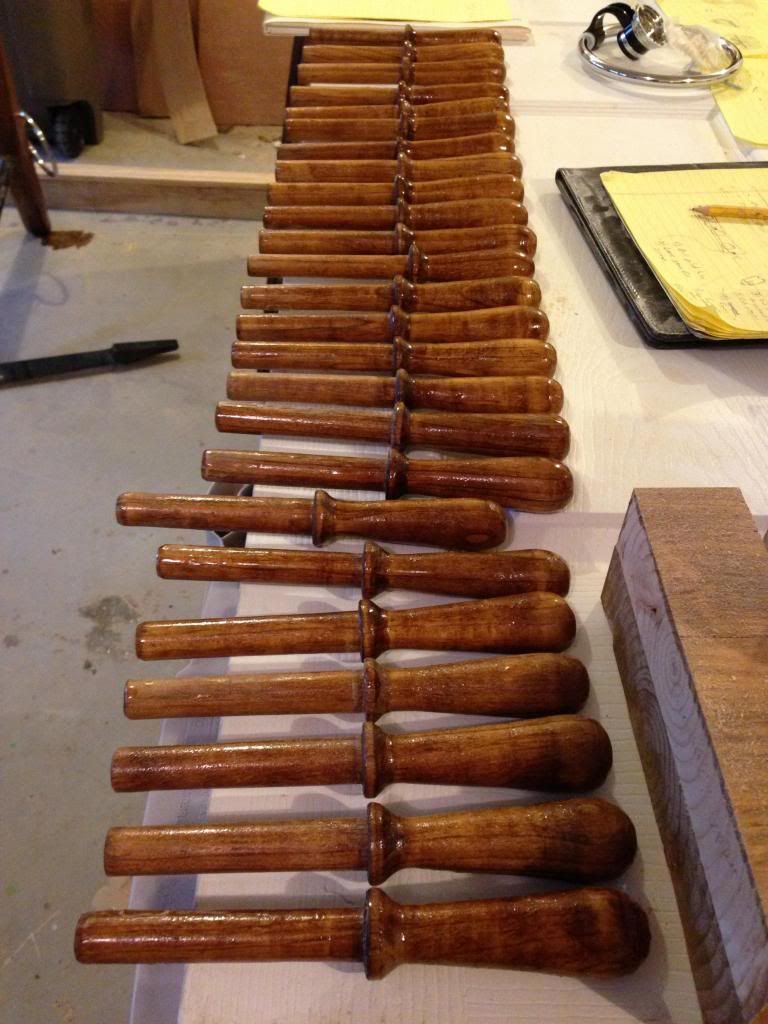

    Grandpa made the belaying pins:

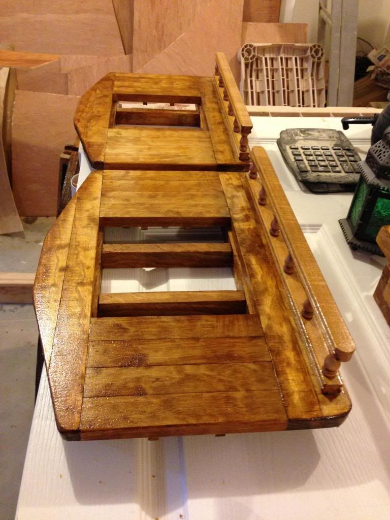

    crosstrees ready to mount:
