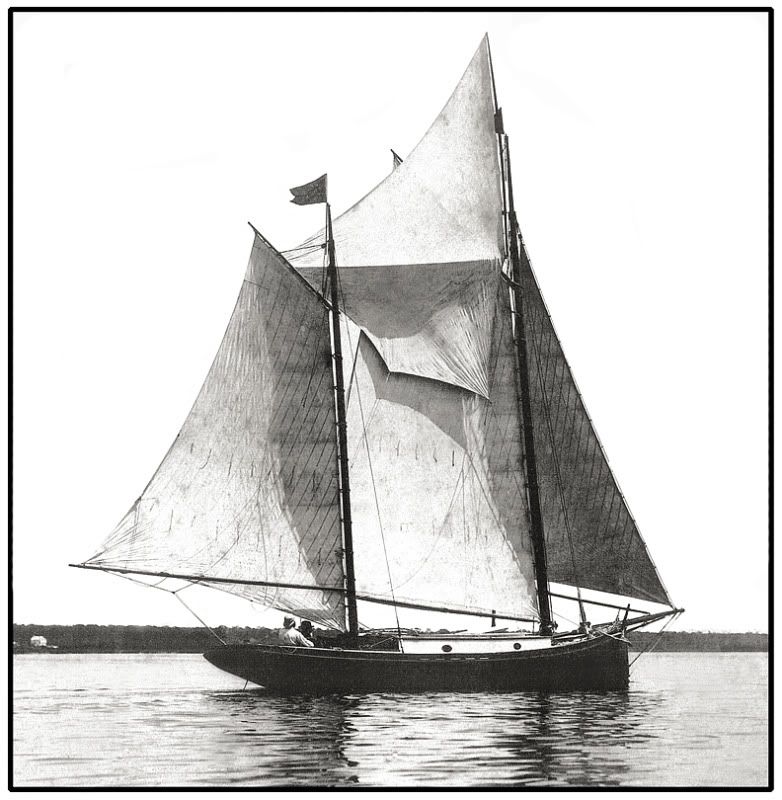

    John, where'd that picture come from? Its one of the best Munroe boat pics I've ever seen.

    I thought Gollywobblers were a 130's invention, this is Sachem from 1888
    [img]

    Not picking on you, John. But I've read this in various places researching the origins of the sharpie and I would suggest a look at this thread: http://forum.woodenboat.com/showthre...Long-Island%29)
    In it there are images of dozens of tong boats, built and used by people you can still speak with today, complete with pictures of people tonging off of them, and not one of those boats has a round transom. Also, other boats used for tonging, the Yankee Skiff aka Staten Island Skiff, did not have a round transo,
    My guess, and that's all it is, about the old sharpie workboats round transom would be that it was a custom carried over by some builders from the round bilged boats they were used to building. In those boats, that type of stern reduced bouyancy aft, and thus reduced pitching.
    Kevin

    Isnt this almost the same as Minocqua?
    The sharpie book shows two keel profiles,one with outside ballast. From all accounts, a very good sailor. Seems to be the usual objection of having a large size boat with bugger all headroom.....i guess thats where the NIS 31 has a distinct advantage. Be a shame to spoil those lines to gain headroom.
