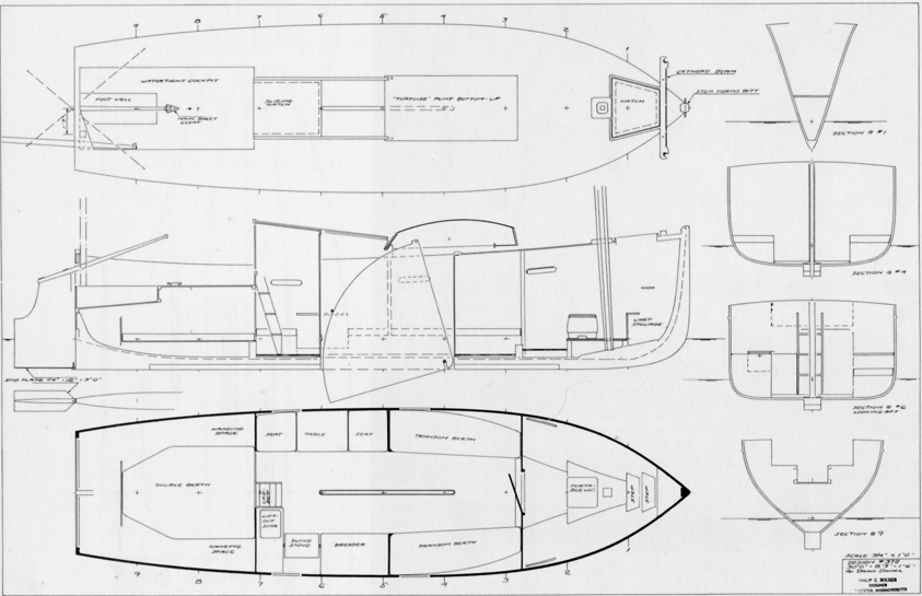

    Phil Bolger's Monhegan, a small Friendship. 18'0" x 7'0" x 3'6"
    Quote: Ballast about 700 lbs. small scrap iron in 300 - 400 lbs. concrete worked in on bare wood.
    Chapter 19, 'Small Boats'.
    Hope this helps a bit.
